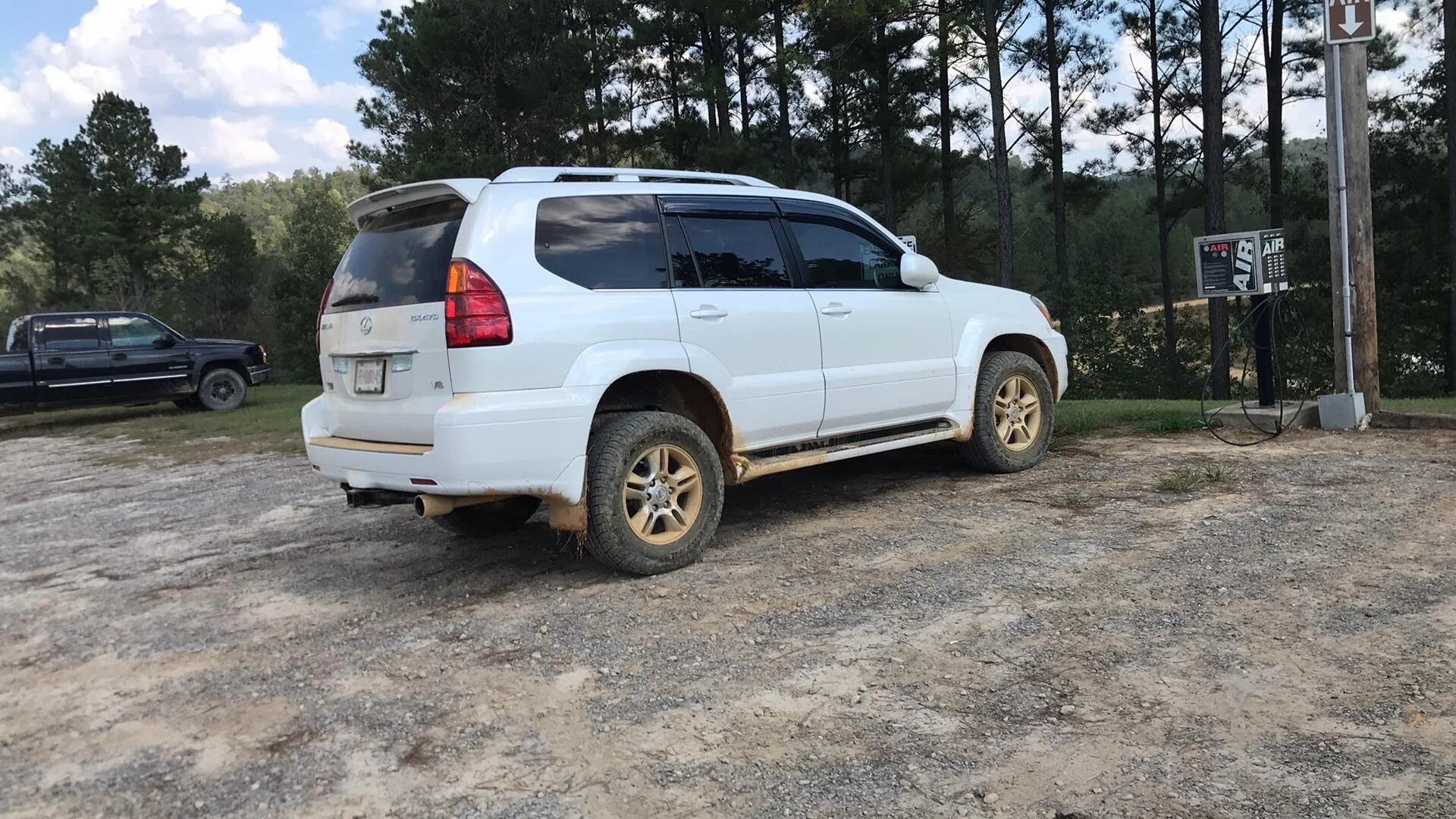

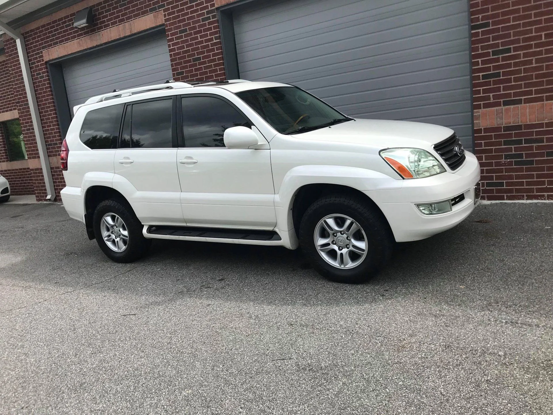

Day I picked her up
Dash is cracked, but thankfully right on the edge of the dash that I hardly notice it

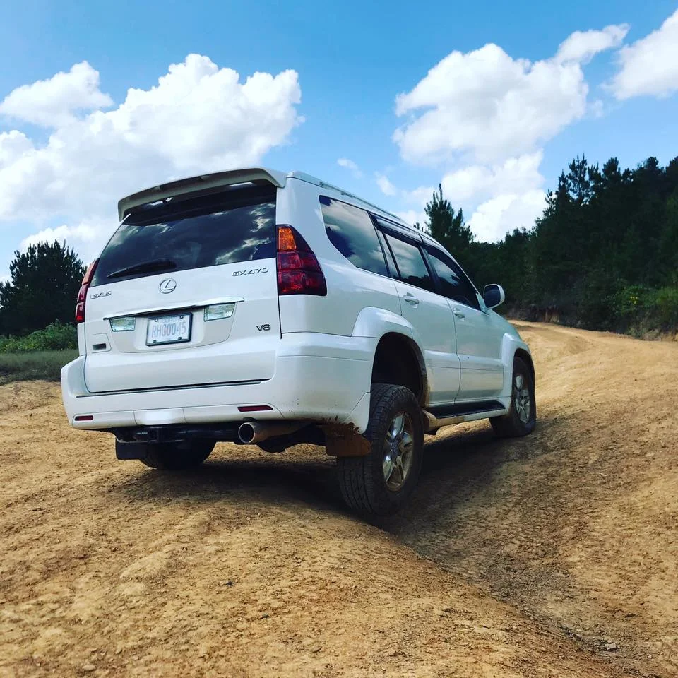

First off-road trip to Stoney Lonesome OHV park in Alabama as well as the added visors, which will prolly get ripped off on a trail one day. Hah

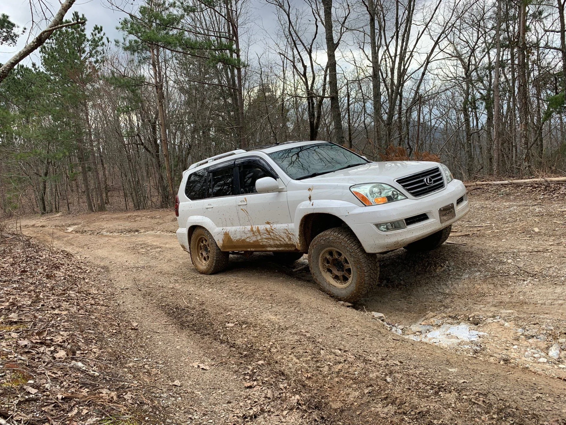

Some stock flexing

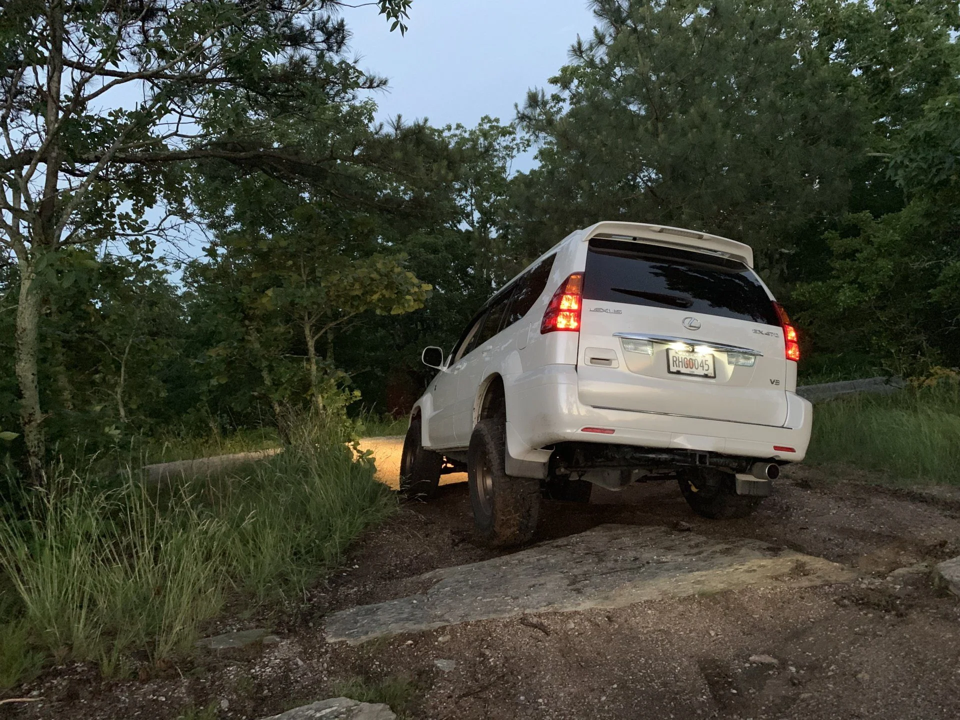

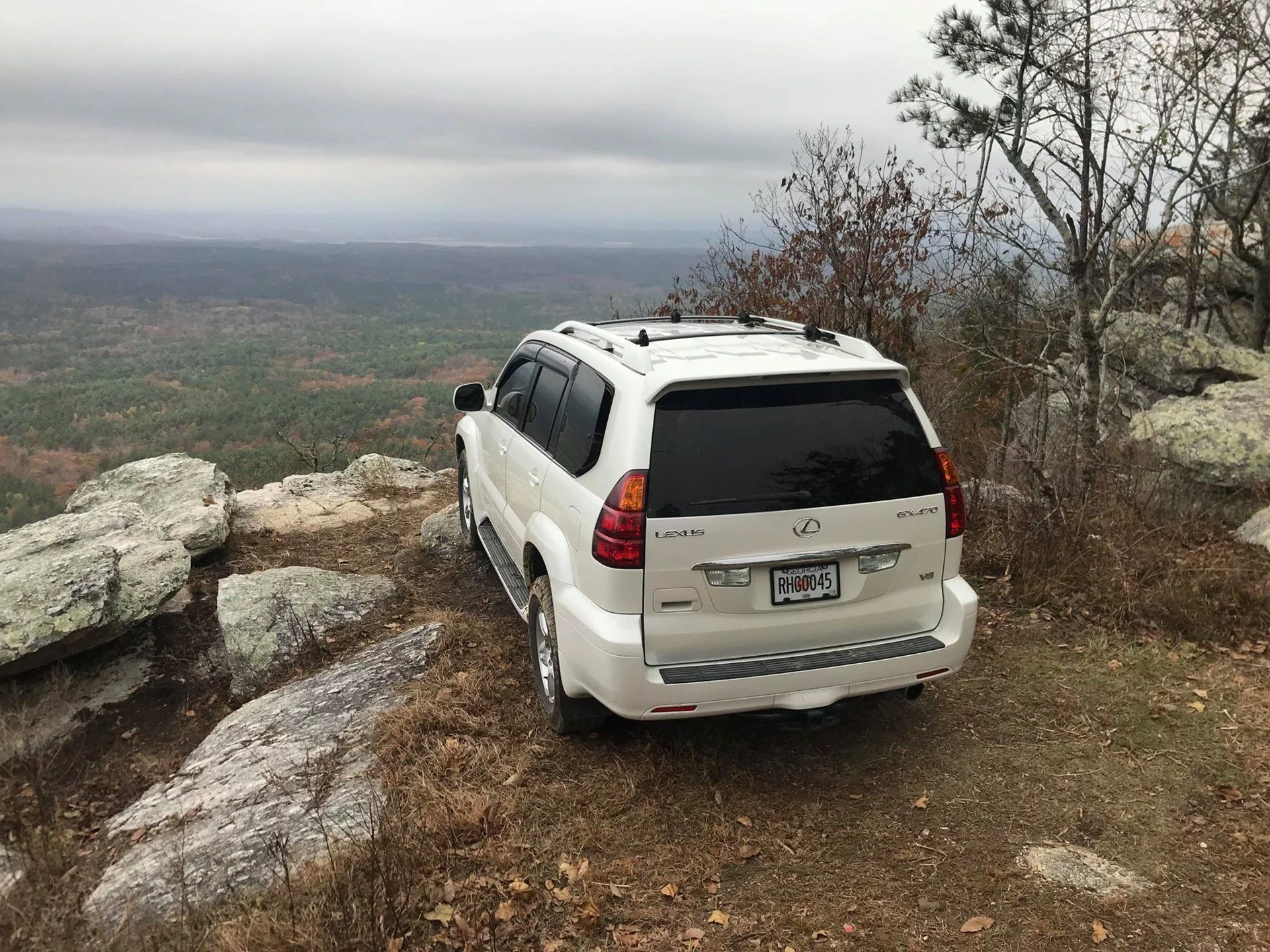

Last day trip up the 601 at Talladega National Forest. Hit a few rocks trying to get this picture.

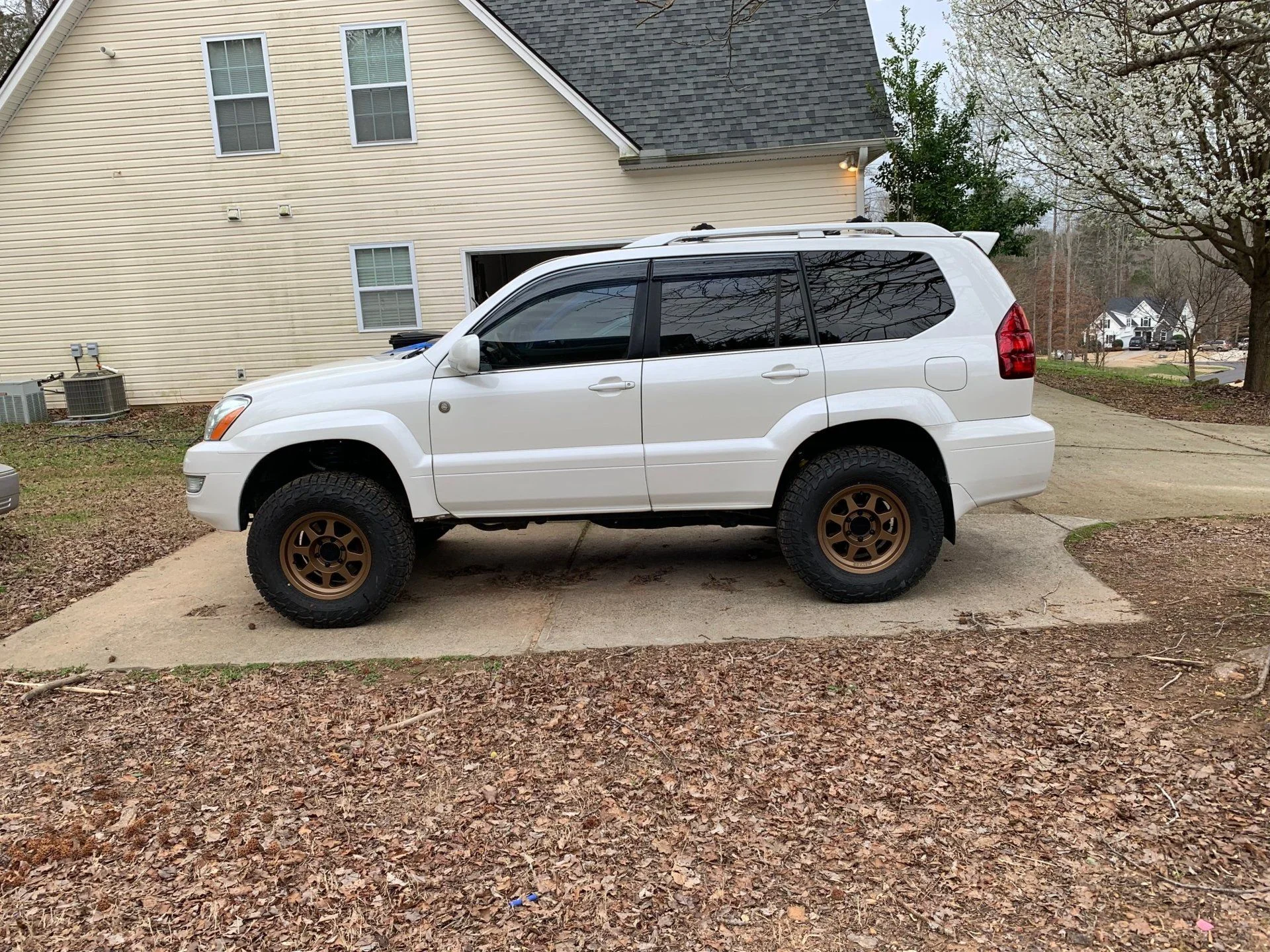

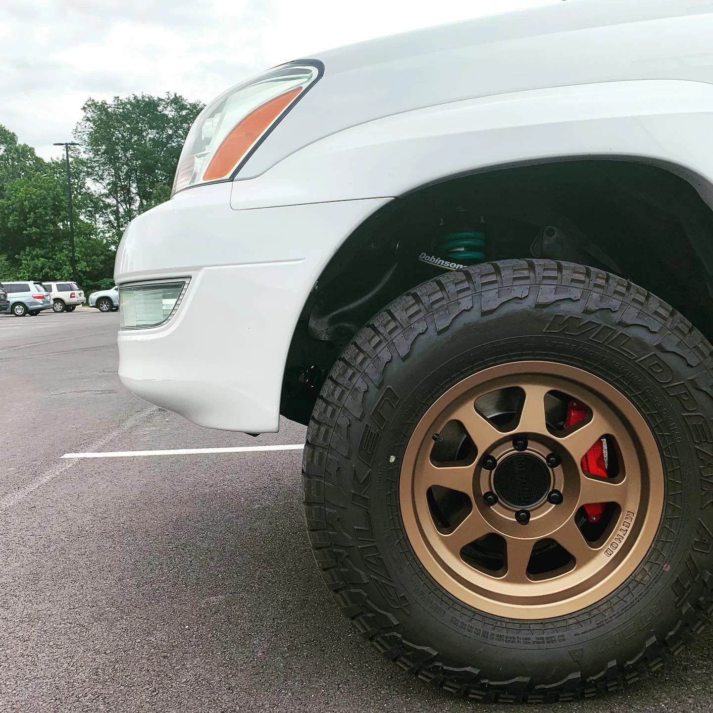

Update! Got my lift installed, tires and wheels! Took her on the trails and man she rides comfy still.

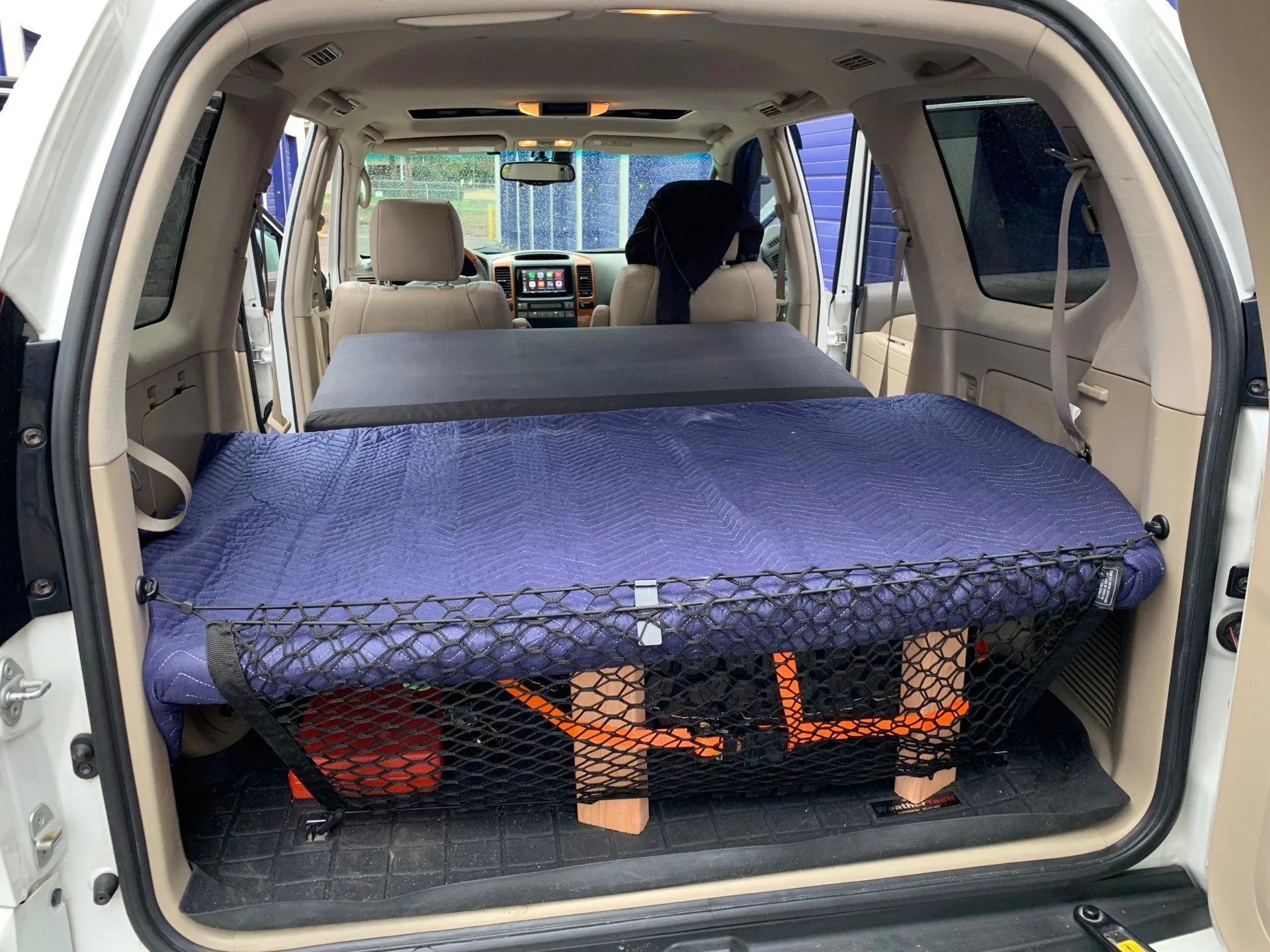

Also worked up a new platform to cover the spare tire and make a bed. It's not perfect but it works well for the time being until I muster the strength to order some bumpers.

Love your build!
I am also considering the 3' Dobinsons lift.. How do you like it?
Also wanting 285/70/17 Falkons, how is that size when flexing? Are they too big when you flex hard?

A beauty. How high did you make your platform to line up with the second row seats. And what you put over the seats? A foam pad?
So far I am loving it. the ride is pretty comfortable and off-roading has bee great so far. As far as the tire size, it is a good size, though you will need to do some fender liner adjustments as I rubbed here and there. I also hammered in my pinch weld as well because at stock height it rubbed and I figured I would need to do for when the rig flexes a lot.
This platform is higher than it should be to line up with the second row seats because I have the spare tire underneath it. I had an old couch cushion to get the height to match over the seats, this is far from perfect. The platform was mainly installed as a flat space on top of my spare tire and place for my dog.

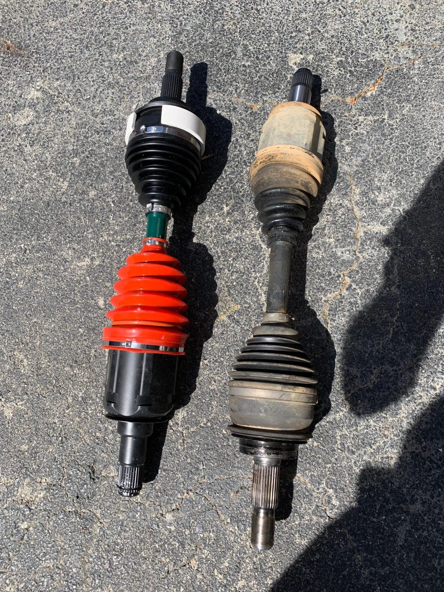

Update: Changed my CVs as my boots tore immediately after my lift! Got CVJs with the red boots. Install was pretty straight forward including changing the axle seals and all diff and transfer case fluids. Still keeping an eye on any drips from the axle seal.

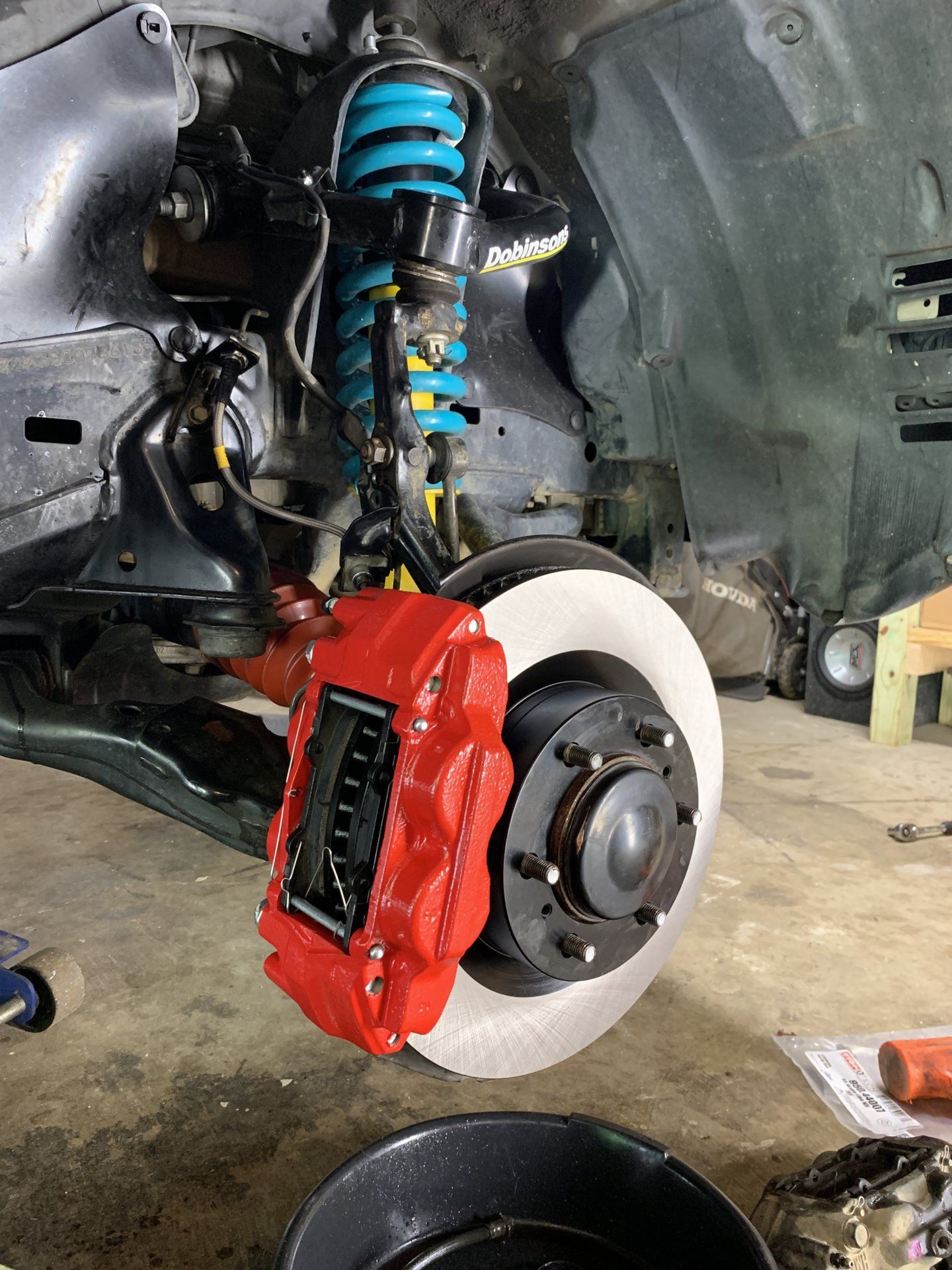

Upgrade my brakes this past weekend due to it pulling to the right. Still having issues with emergency braking though - so I might get an alignment and see if that helps or get a zero point calibration. Also having issues with the heat, it will only come on at full max heat, otherwise it always blows cold. Maybe there is a problem with some blend flap or temperature sensor.
If you are curious the brake part numbers:
Brake Motive - Caliper and pad set for a GX460 at the link below
Centric Front Rotor - 120.44174
Centric Rear Rotor - 120.44128
Stoptech - Braided Lines Front 44007 and rear 44507. Stock Length
The install was extremely straight forward requiring no modifications.

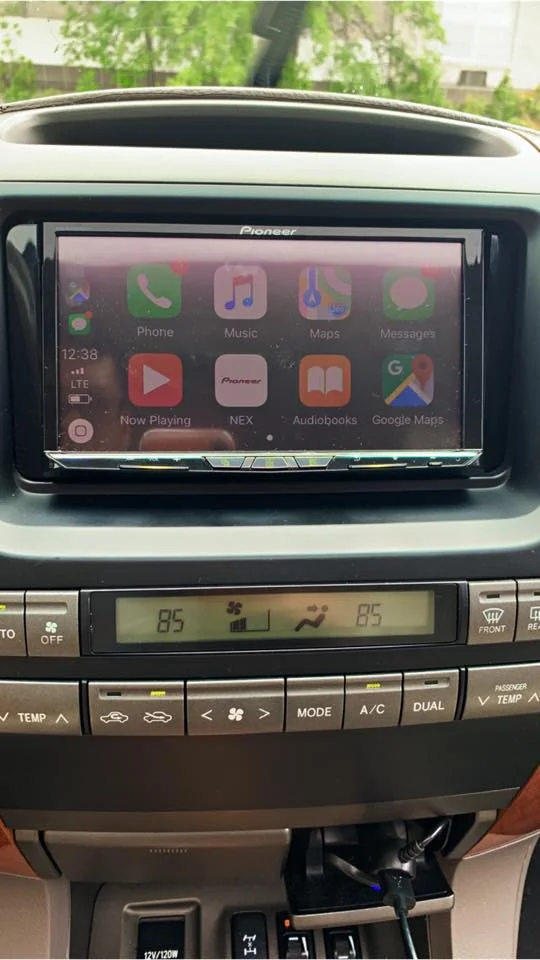

Pioneer 4400NEX for wireless carplay, one of the best upgrades I have done.
