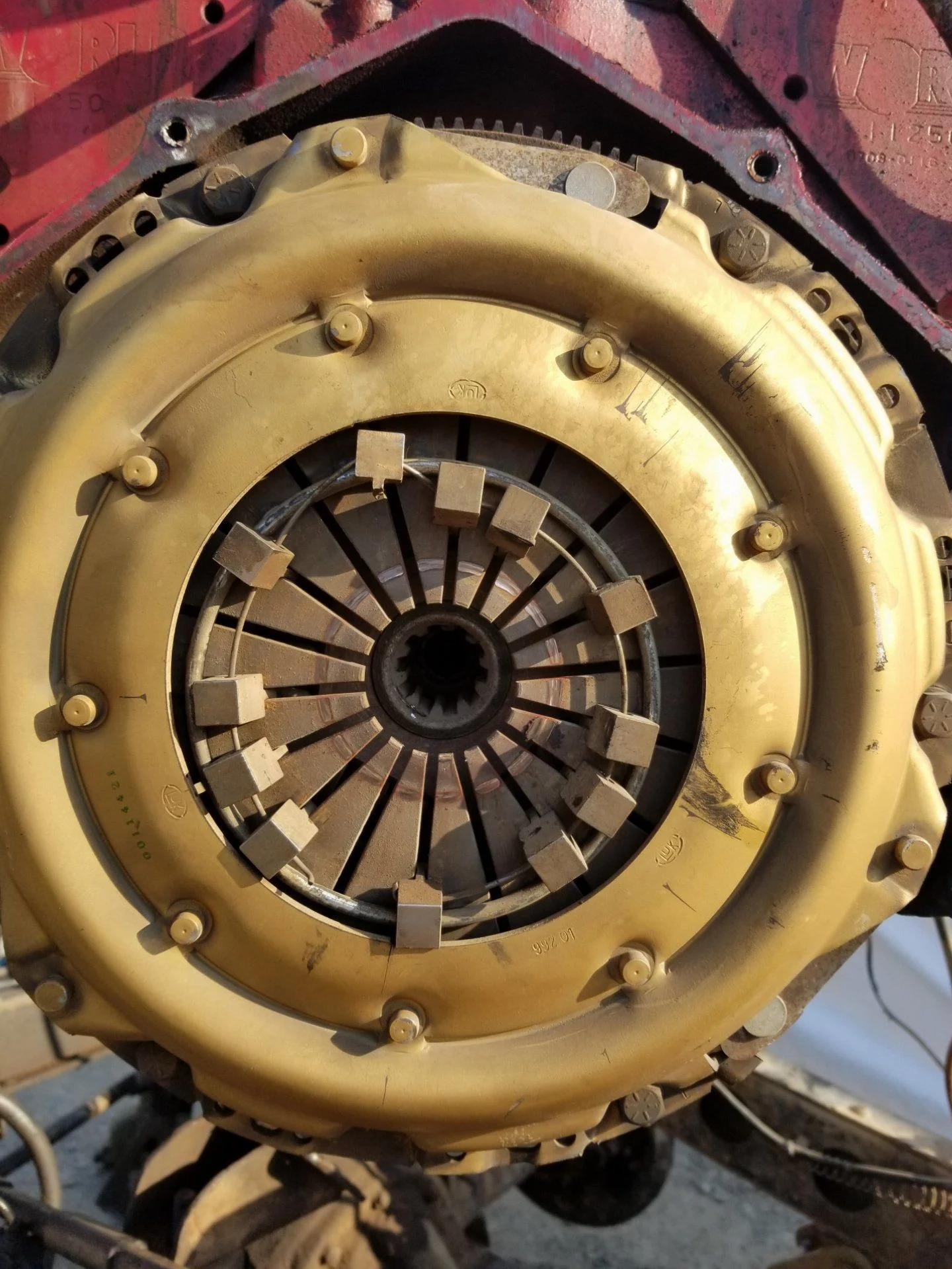

Yea the weights are B.S. CenterForce this is what happened to mine at 7400 miles...
They are replacing for about 65% off cost though so not all bad, and I'll be removing the weights on install.
