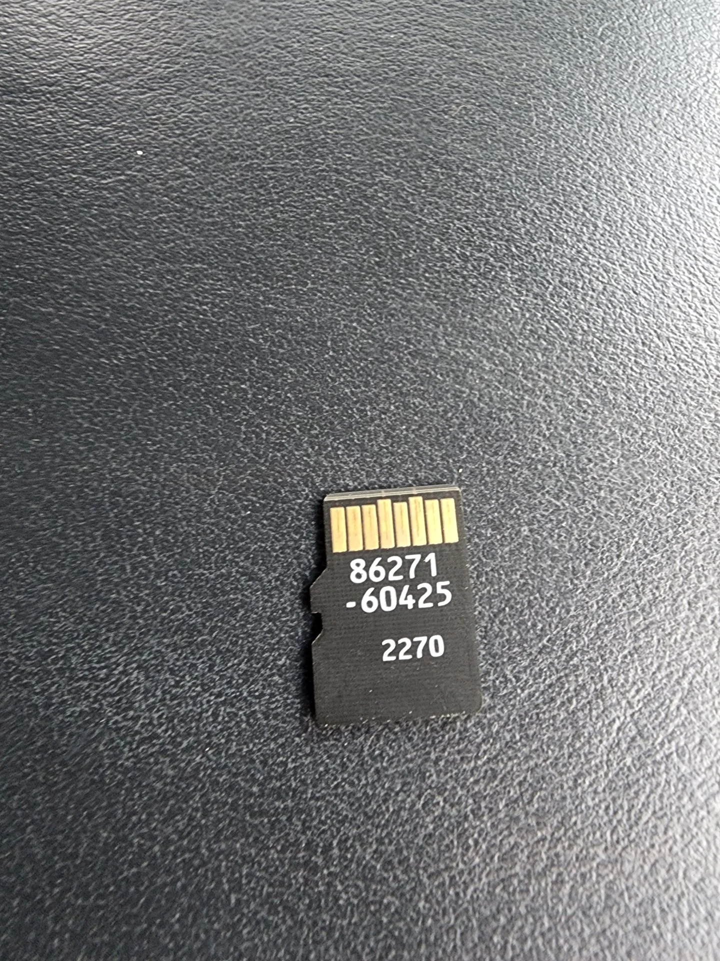

Card number for reference.
Purchased from local dealership, less than 200.
