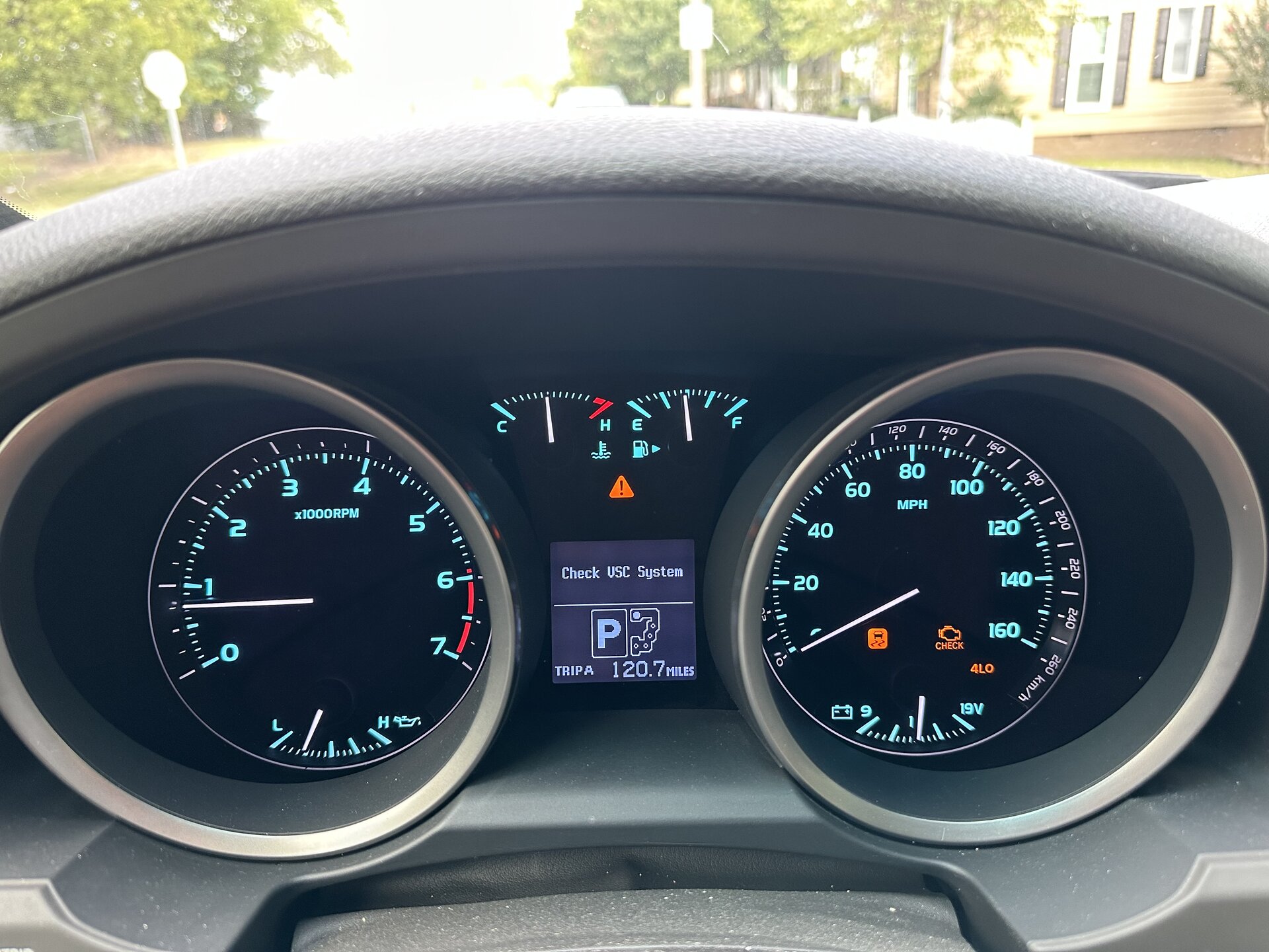

Check VSC System & Engine Light (5 Viewers)
The exact same situation just happened in my 2010.

I swear that I didn't just copy and photoshop your photo but this is my dashboard this morning. All of this is happening less than 24 hours after I had all the valve cover gaskets replaced following a small oil leak that had also run into the spark plug tubes. Had the tubes and everything cleaned out and gaskets replaced as well as a Fuel Injector and Air Intake cleaning performed.
Will bring it back and have the error code(s) grabbed.

Absolutely expected to hit some major maintenance and replacement items with a vehicle this old with this many miles. But it's had a string of multiple big $$ repairs over the past 24 months. I'm not talking about fluid changes, battery, brakes, hoses, etc. I mean replacing the power steering rack, radiator (for a second time), AC system and servos (3 times on the servos), water pump (of course), lower control arms, etc. Just a string of things I guess and some bad luck. Disappointing that after replacing all the valve cover gaskets, the fuel injector and air intake services to have the dashboard light up like a Christmas tree here.

Got it back from Toyota today. Everything fixed. Total cost was $1750 for parts replacement + labor
AIR PUMP REPLACEMENT
AIR INJECTION VALVE 2 PIECE
AIR INJECTION DRIVER
AIR INJECTION VALVE CONNECTOR
ECU INSTALATION & PROGRAMING
Thank you everyone here for your guidance and suggestions. Really appreciate it.
