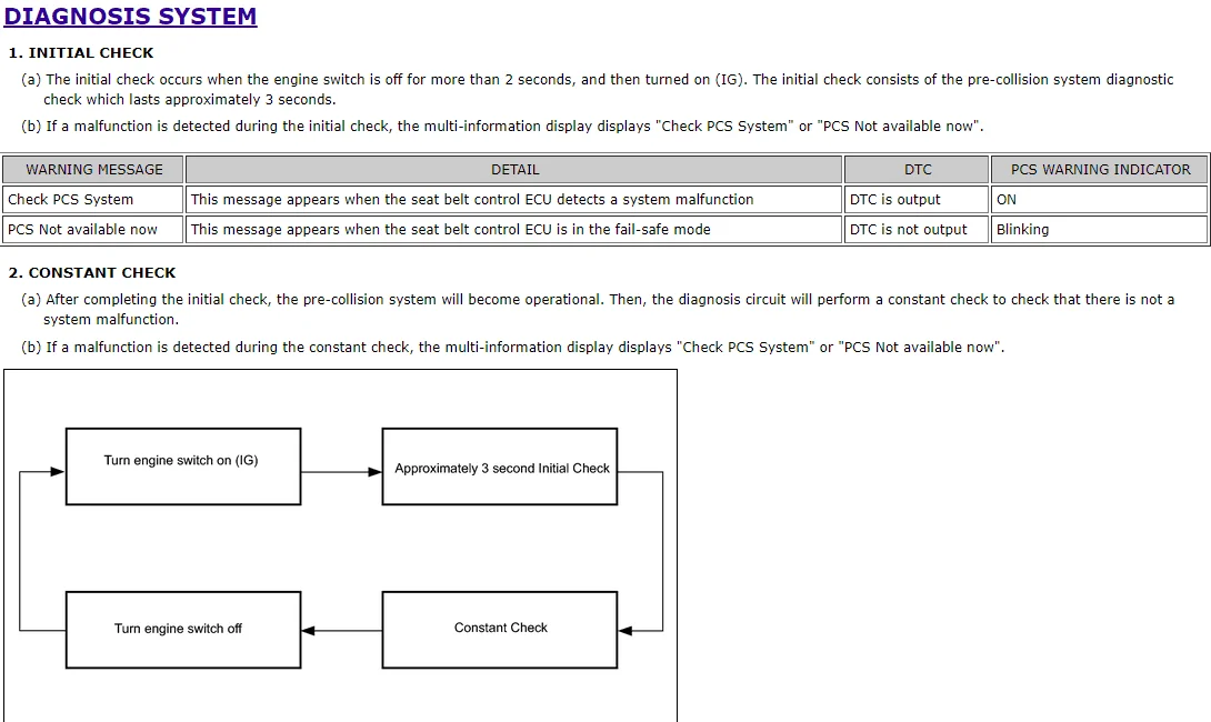

Here's the troubleshooting guide

If this happened right after hard braking and the seatbelt locking up, I suspect something is wrong with the seatbelt sensor or related system. The FSM says "Check PCS System" can appear "when the seat belt control ECU detects a system malfunction". FSM also says that error can be influenced by other systems.
With the DTC and perhaps the wiring diagram, you can trace the various sensors/ECUs where the PCS system gets its data and then follow the FSM diagnostic procedures to rule each one in or out. If you need a copy of the FSM or the related docs, let me know. Here are the initial troubleshooting steps for the PCS system
