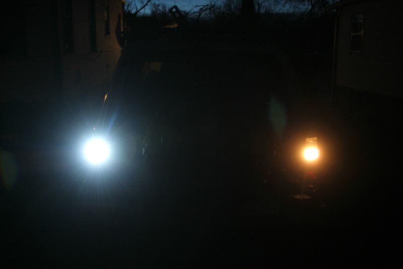

Put them in last night and I can say it was well worth it.. IMHO
Comparison shot included
