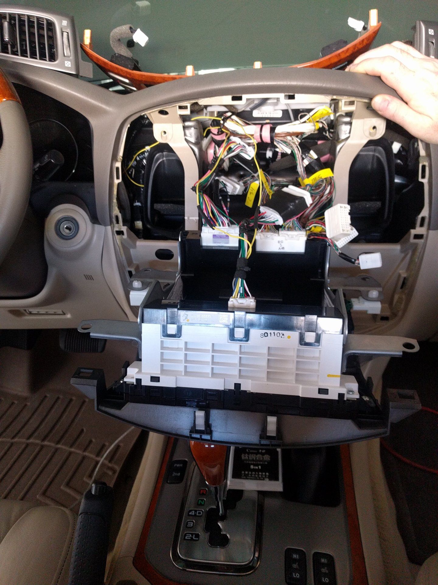

there are videos on you tube about removing the side panels and removing the four bolts that hold the center assembly in.
you said your screen was inspected and said to be good, so I'd skip anything related to that.
Once the four bolts are out lean the top outward with the bottom resting on the ledge above the ashtray piece. I'll attach a picture if I can find one.

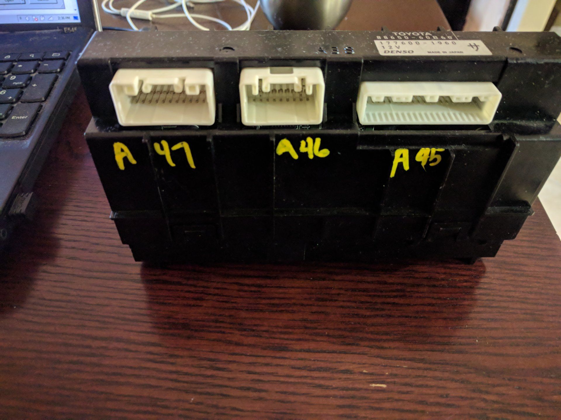

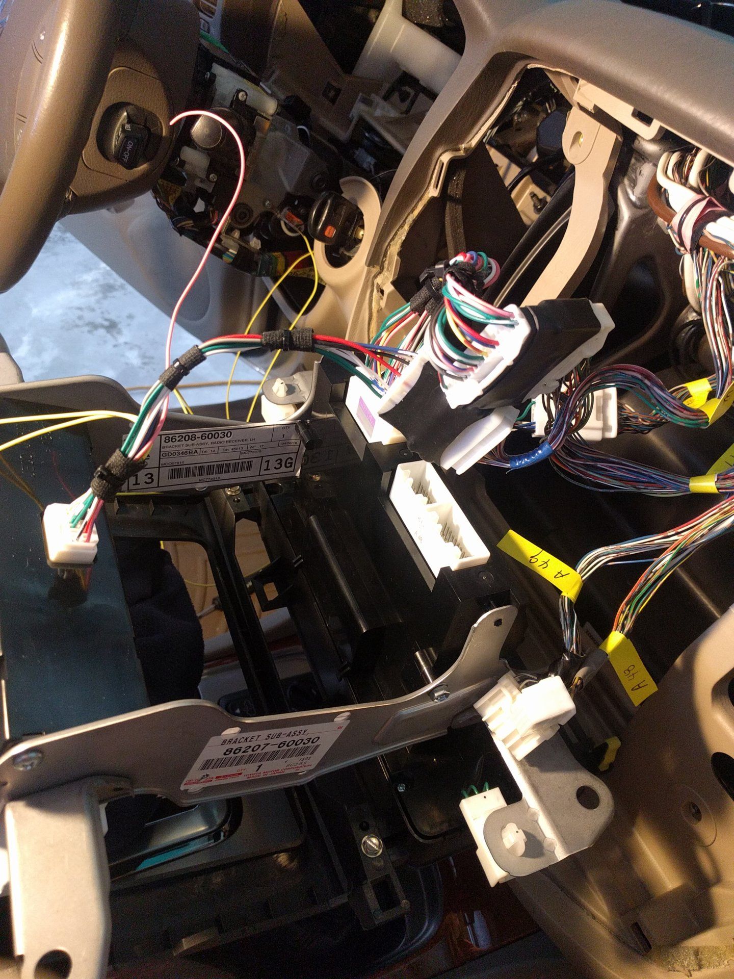

Unplug all ten plugs back there look at them all, look for signs of other people's work. Pay special attention to the 3 AC plugs. The 3 that go into the rectangle back box.
Looking down from the drivers seat with the assembly leaning open a bit, the AC connector that is closest to the passenger side (A47) has a temp wire, pink, in one of the corners. Make sure that looks normal.
From left to right the AC plugs are this,,, A45 (40 pin) A46 (20 pin or so) the middle one, and then A47 20 or so pins furthest to the right.

yours won't lean back this much, I use a peice or cord with a coat hanger hook on one end, hooked into the de defrost vent at the lower edge of the windsheld with the other end wrapped around the two top bolt ears that hols the assembly in place. So the rope holds the assembly up and close to the wiring while working.
Or put a towel on the gear shift lever and move it so it doesn't hurt or rest completely on the screen.

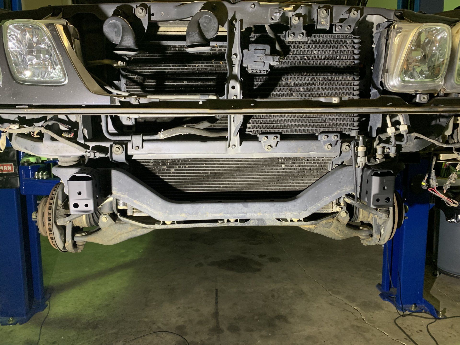

Have you looked at your outside temperature sensor? It is located on the passenger side behind the front bumper. You can find it by tracing the connections from the fog light harness to the sensor. My guess is there might not be anything wrong with the connection on the back of the unit, the signal to the unit just might not be there. The sensor plays an important role in the a/c system.
You can see it above the passenger side frame rail in the pic below...

I did recently have the unit out, and all 10 connectors unplugged. The wires all look normal and original. male and female adaptors all looked good-- no obvious signs of issues.

Outside temp sensor-------- I found it and it looked ok. I removed it and cleaned it and I put muy ohm meter on it-- it read about 1.7 at the normal outside temp, about 40 today, and then I put a little heat on it, and it dropped to .9---- I do not know if that is w/in normal specs, or if there is a better way to test it. I put it back in, and nothing has changed.

My problem was the "AC Amplfier" which is the black plastic unit, right behind the MFD, that has three white female connector sockets. I am pretty sure that is your issue.
Thanks. Did you have to replace the "AC Amplifier" or were you able to fix it somehow?
