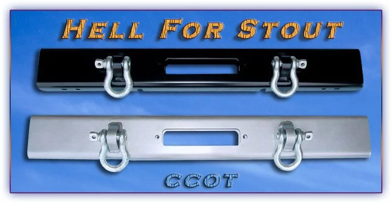

you could probably have one made locally on the cheap. Remove your stock rear bumper, and take it to a local machine shop with a large brake for bending metal. have them take measurements off the stock bumper mounts and bend up a c channel like one of these. they could possible drill the holes for you.
