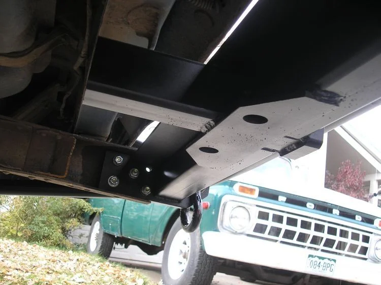

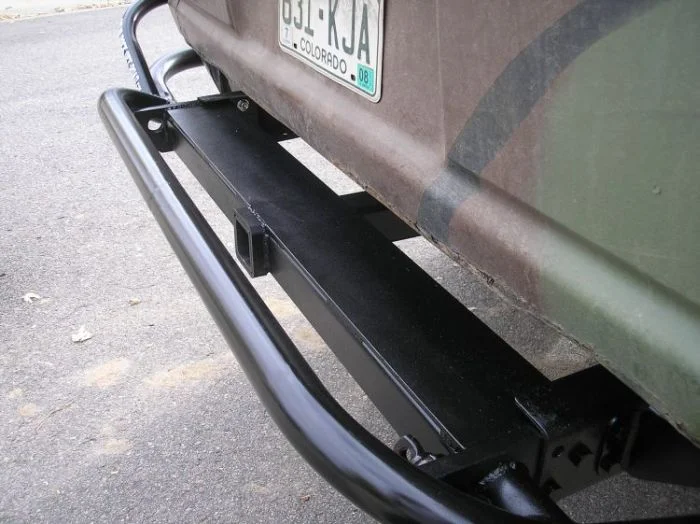

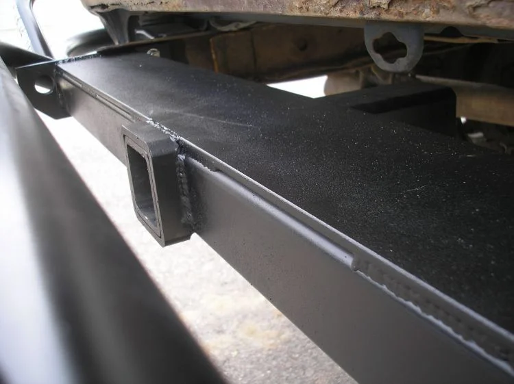

Here is some photos in the daylight

Ok, I did some measurements on my camo 60 (one with the bumper) And compared them to the measurements on my other white 60. The outermost part of the reciever on new bumper sticks out 1.5" further than the stock chrome bumper. But the bottom of the reciever sets almost 2" higher than the bottom of the chrome bumper. I of course did these measurements of common spots on the trucks and not off the ground. I measured from the bottom of the toyota emblem on tailgate down to bottom of reciever. and from the spare winch guide hole thingy out to outside of bumper. Looking at teh bumper, the only way to "push it in" would be to notch the frame which isnt a big deal really. All new mounting holes drilled in frame and in the 3/4" plate that mounts the bumper. I think the hoop makes the bumper look like it sticks out further than it does. Believe me, you will hit the reciever before you hit the hoop going forward up a hill. In reverse, thats why the hoop is there. Its a totally awesome bumper and am proud to sport the prototype.
