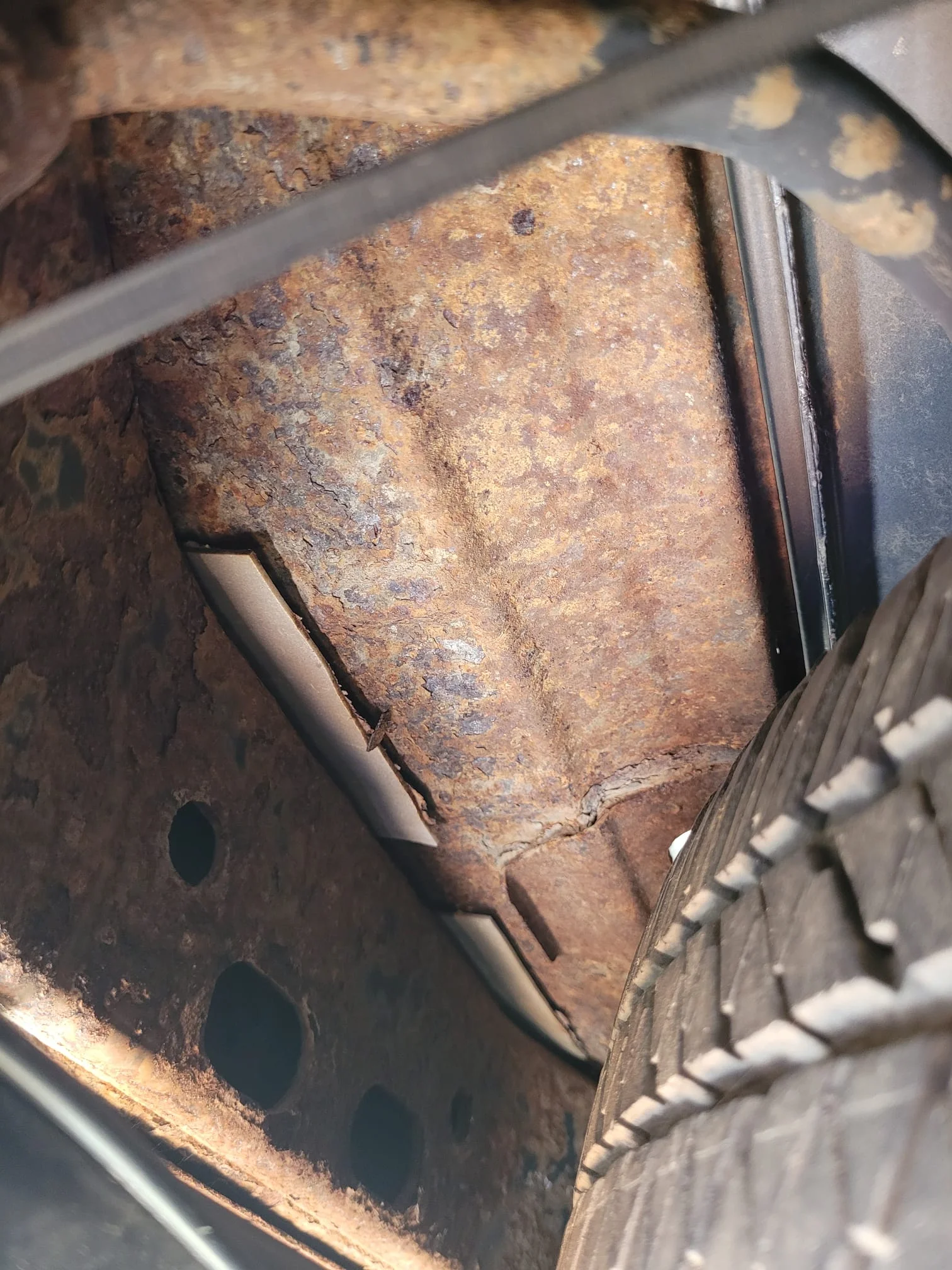

HI folks,
I appreciate this issue may not be an issue for many of you in North America (besides those wetter areas!), however in the UK rust is a huge issue for us on these due to salt on our roads during winter etc. Avert your eyes if you're of weak constitution when it comes to crusty undercarriages!
My 2004 100 series is considered 'solid' by UK standards despite having quite substantial surface rust throughout the entire underside. There is one small area on a rear crossmember which will need cutting out and replacing however the rest is at the surface rust/scabby rust kind of point which I'd really like to address after this winter before it gets too much worse and hopefully treat so it takes a good time before it starts the 'clock' again.
I'm trying to avoid this becoming a mammoth job which I inevitably end up taking it off the road and turning it into a light restoration, so I'd appreciate people's thoughts.
I'm replacing components like control arms etc with new OEM stuff so won't need to sort those, but on the rear axle and the rest of the chassis/underside of the body it's pretty ready for some love.
I've seen people use a dry ice blasting method, but I'm open to suggestions, I just don't want to be painting over badly prepped surface rust areas, and would much rather properly remove the rust, treat and paint it, I just feel like the lengthy part will be the removing of the rust. I plan on keeping this for a long time so I don't want to do a bad job on it. I know you can get a wirewheel on a drill/brush by hand but I feel like there has to be a better way (something like sandblasting feels like it'll cause more issues than it's worth!).
A couple of random pictures, probably the best examples as some areas are better, some are worse.
Any thoughts/guidance/experience with this is appreciated!

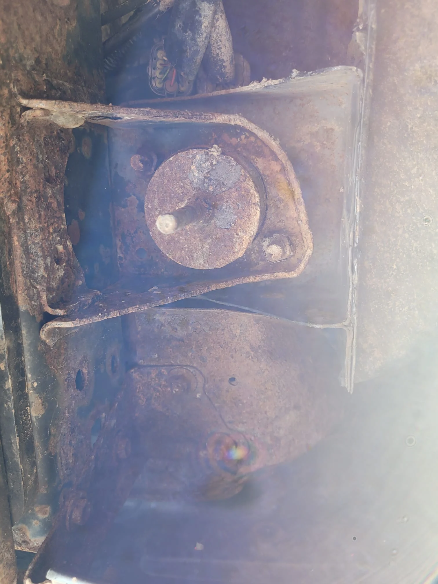

thoughts and prayers for whoever has to remove the nut on that body mount.
That'll be a cutting job for sure I imagine! Just want to salvage the rest of it
It can be done with a lot of effort. This is not a small job.

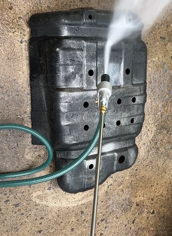

I've used a high pressure wet blaster to take rusty surfaces down to the bare metal.

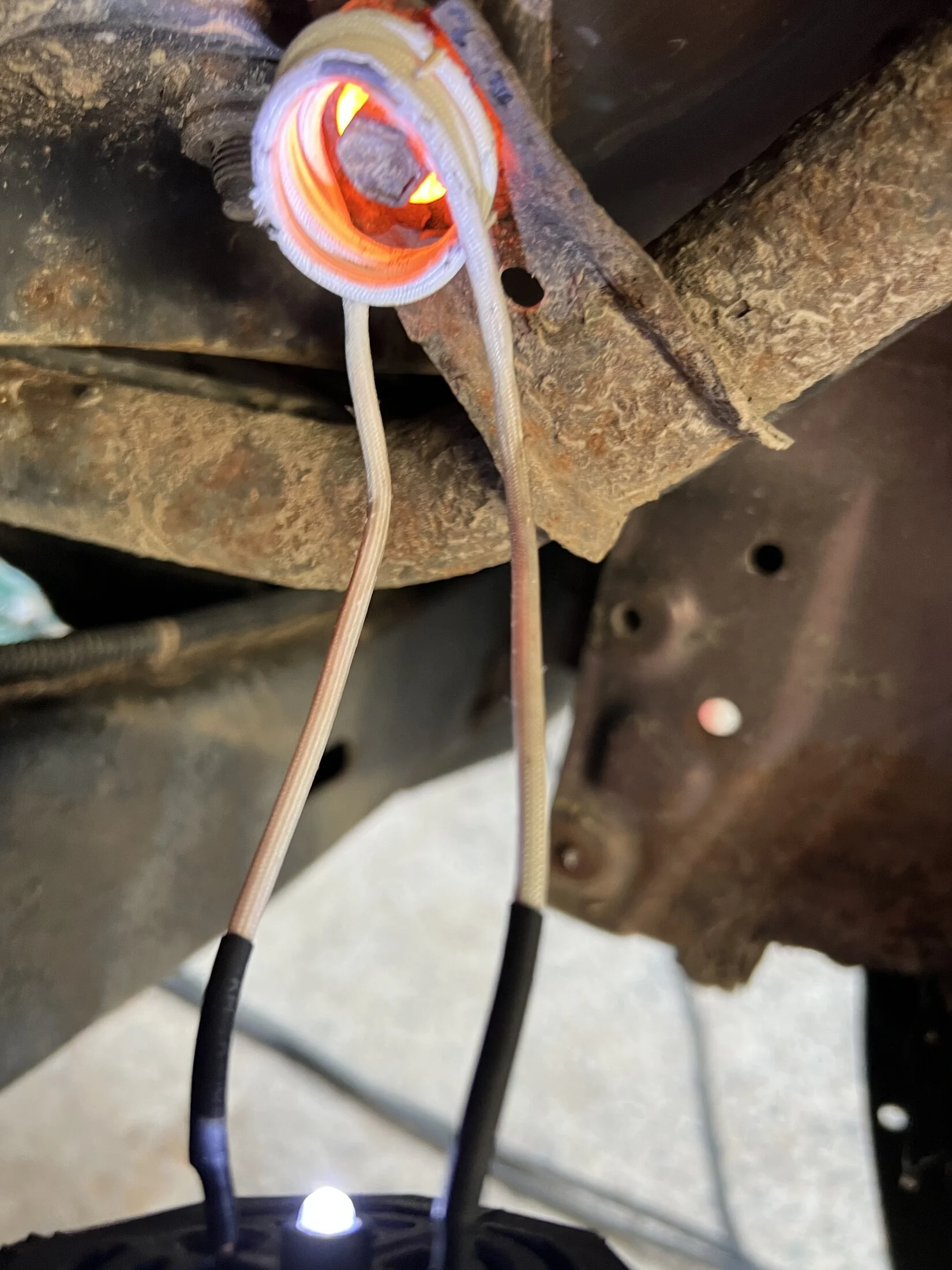

Additional items that will be beneficial are a mini-induction heater for rusty bolts.

I'm not sure how feasible that would be in close quarters for the underside but definitely an option to consider.

I live in Maine so I'm acutely aware of the issues of rust. Your pics show more than surface rust. Those are some serious flaking. This is going to take lots of elbow grease. I had to use a combination of needle scaler, air chisel, phosphoric acid and sander for some of my frames. I'm more concerned about the insides of those channels and crossmembers. I'd be spraying fluid film/old transmission fluid into those channels ASAP.

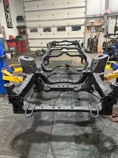

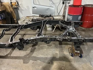

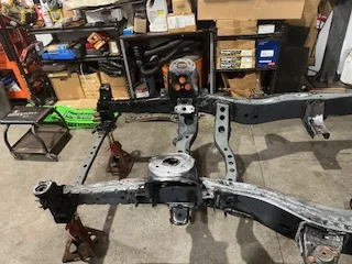

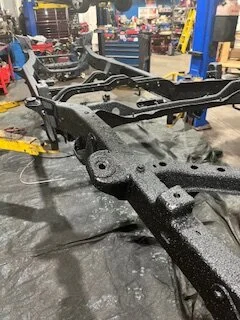

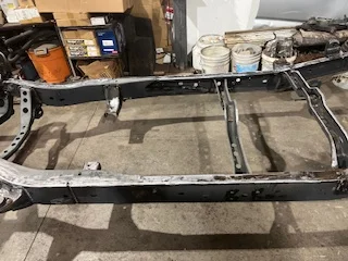

Something I deal with on a weekly schedule... If you can put the truck up on a lift of some sort, begin with removing the wheels, exhaust (muffler/tail pipe at least), drive shafts, fuel tank, spare tire, as much of the suspension as possible (AHC?) including the rear axle assembly if able. Remove both bumper covers, running boards, plastic splash shields/fender liners, support the transmission, drop the tranny crossmember, spare tire carrier, exhaust heat shields, skid plates etc... Basically, everything you can remove from the underside of the vehicle. I wrap the CATS with paper or foil, same for the exposed electrical connectors and as much of the remaining drive line as possible.
Begin prep by blowing/vacuuming every crevice that can catch debris. Blow out the remaing crossmembers and both frame rails. Using a medium duty needle gun, attack, attack, attack like crazy, every bit of oxidation and corrosion you can access and follow up with a 36g or 40g grinding disc. It is very common that I will spend 20-25 hours just on these 2 phases. At this point we determine what has to be repaired on the frame (prep for welding) if anything, then acid wash (spray on and brush) all exposed areas. While this treatment times out, I re-vacuum the inside of the frame rails, using a blow gun to force out the rust scale and debris (hello mouse-house!) I also blow out the rocker panels and the rear body reinforcement support in prep for internal soft coating (Woolwax).
After the acid wash is complete and dry, I scuff the frame with fiber pads and spray rust kill primer (2 coats minimum). This needs to properly cure (24 hours) so while this is timing out, I repair and clean all the removed components as needed, and attack the floor pan and floor supports, repeating the process. I spray the Woolwax into the body cavities, lower doors, upper/lower hatch areas and anywhere water, dirt and debris will be able to accumulate.
Semi-gloss black paint is next for the frame if the owner chooses to NOT do an exterior coating, or a seal coat as prep for a Rusfree rubberized exterior coating over the entire reconditioned frame, which goes a long way in keeping the reconditioned frame in "as-new" shape. In either case, I next apply the Woolwax inside each frame rail and crossmember. Too much is NEVER too much! I apply liberally, using 3 to 4 quarts per vehicle. (I use 4 to 6 quarts of external coating as well). Some customers have chosen to have me paint the floor pans, others have chosen hard coat, and others just Woolwax. In any case, the underside now looks better than new. I will add some 2012 4Runner images tomorrow... just finished that job today! All told I have about 35 hours into the reconditioning of the frame, which includes the dis-assembly/re-assembly.
Re-assembly now begins with reconditioned components or brand new, at the customers request.
Here is a Tacoma frame just completed. We chose to drop the frame, as it is a simple process and easier to recondition on the ground. First 4 images, cleaned prepped and primed... Last 3 external/internal coatings completed...
