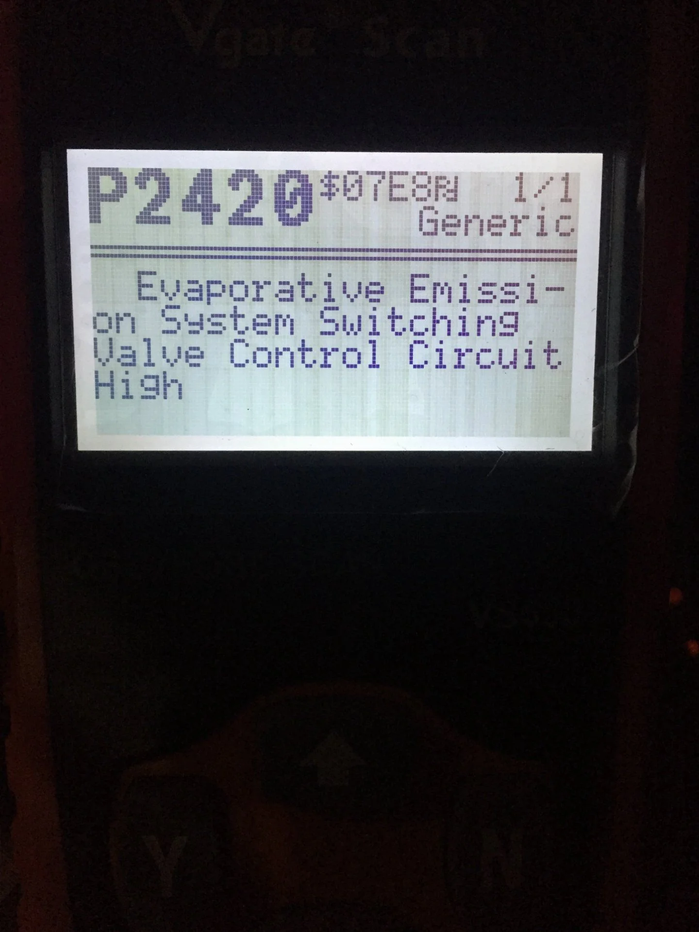

In Philly area. My charcoal canister has a stuck valve and is throwing CEL. I don't want to spend $600-$1k on a plastic box filled with charcoal, let alone $200-300 got a used one. Any way to fix existing canister of bypass it all and still pass emissions? Thanks in advance.

Been fighting emissions codes on my Taco so have been doing some research. Insufficient purge flow means that after you start the engine the system tries to flow fresh air through the canister to move the stored gas vaoprs out of there and deliver them to the intake to be burned.
So the computer is sensing that there isn't enough air moving through the canister to achieve this. On the FJ I am not sure of the methodology used to determine this. So insufficient purge flow "could" be a plugged canister (pretty likely actually) or an incorrectly functioning purge valve, or a blocked purge line between the canister and intake, or possibly something else (ECU but not likely.) It's probably not the gas cap unfortunately.
I used to make carbon cans. The little bits of carbon in there tend to go on a jail break after a while and plug stuff up. Or as someone mentioned if the tank was overfilled too often liquid gas may have gotten in the canister which is not good. Hopefully it's the purge valve but do the proper homework and testing before shotgunning parts at it.
