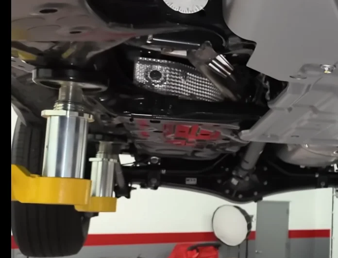

The 1GD-FTV also has a full length skid for that 110L (29 gal) tank. It appears to all be in front.
Compared to the US (250) it almost looks like the US smaller tank doesn't hang down as low (likely a shorter heigh tank) and maybe Toyota thought it was enough out of the way to not require a full length skid.

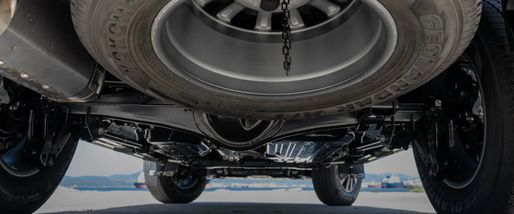

All TLCs in Australia have an option to add an auxiliary tank in place of the spare tire. I was going to do it in my Hundy but they were EXPENSIVE. I found someone who could build one for me where my spare went so maybe I make a smaller one for my 250.

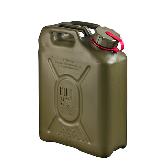

No, I just know they used to and I just thought maybe they would for these. I think if I were to build one I would make it like a Jerry can. It would just sit there full of fuel then when I am low I get out and pump from one tank to the other with two filler necks. Lord knows the filler door is big enough to fit 7 or 8 filler necks. 😆

The large fuel door on the 250 implies to me that there is a dual filler neck in some other market. Never researched it. But like my 80 series when I need extra fuel best bank for the buck is a Jerry. For the few times I need extra fuel I can’t justify the expense of a larger tank install.

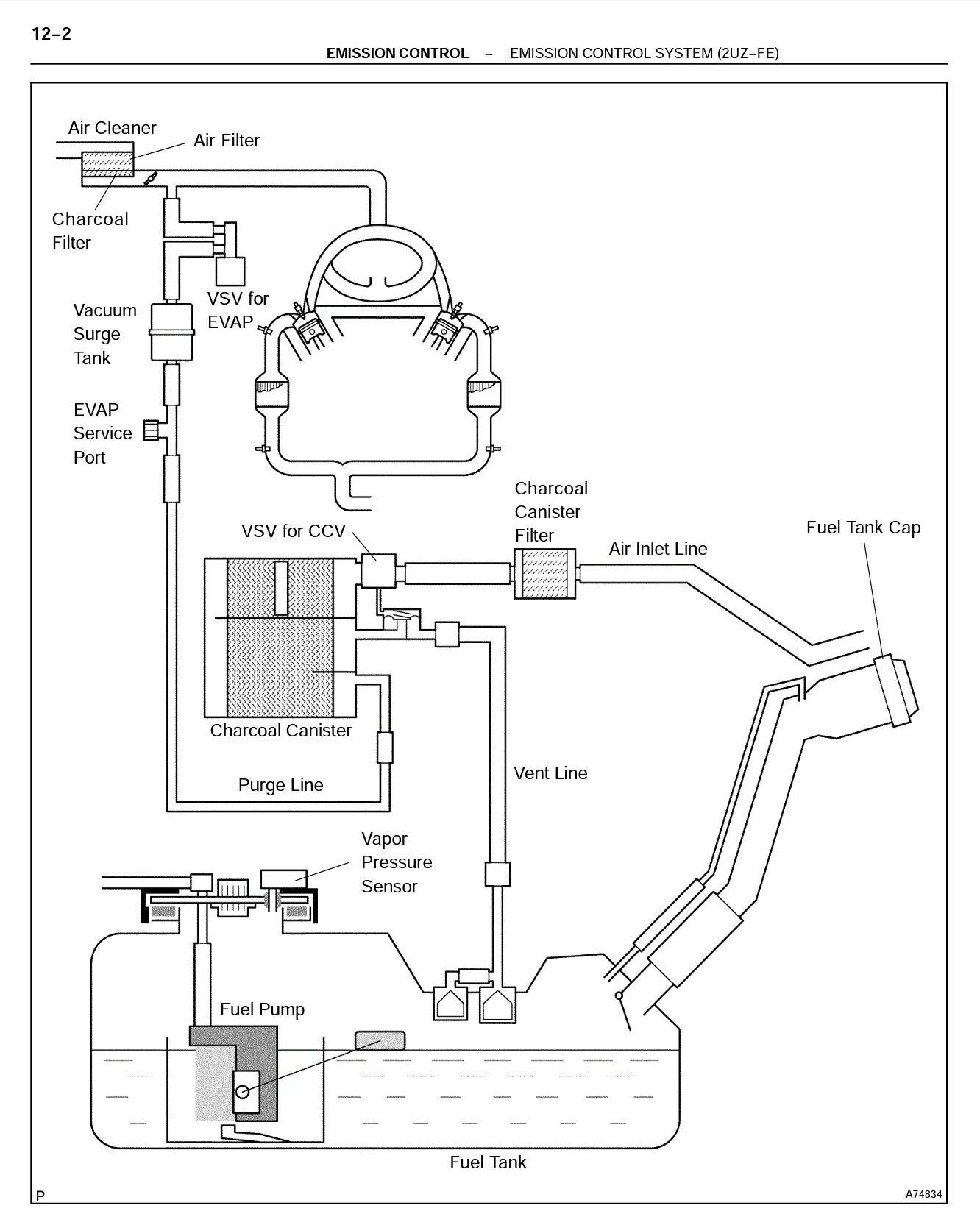

Without having access to fuel diagram we cannot be sure if the fuel tank design is the same or not. Many hybrid use stricter emission system and got different charcoal canister system. This can trigger CEL and disable a lot of systems.
Most factory dual tank are not compatible with US emission standards. A few tried retrofit OEM subtank and found they use simpler emission system. They are prone to trigger CEL on US emissions vehicle.
