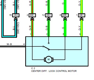

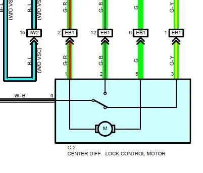

Should be able to test with a voltmeter from ground to different pins to see if it is getting power.
This might help with which pin. Since the motor reverses 12V can be on either leg of motor depending on direction.
Edit - Looking at CDL relays it looks like pin 2 or 3 (OR not both!) need to grounded for relays to feed power to motor. Normally done by travel limit switch in CDL actuator.
It looks that pin 1 and 5 are powering the motor.
So if I use a 9V battery and switch between pin 1 and 5 that would test the motor, right?
To close it pin 1 positive and pin 5 negative, open it pin 5 positive and pin 1 negative?
Not sure you want to be applying power directly to the motor, its geared way way down and without limit switch and control circuit you might break one of the arms in the actuator (saw a post here of a broken arm in one). Also I have not decoded the circuit to know which way to power it for a direction.

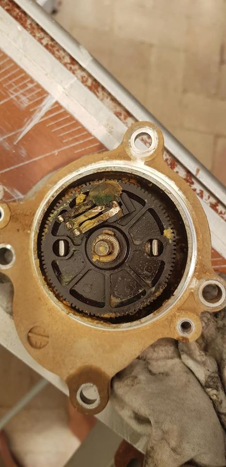

Finally had the time to tackle the CDL issue.
Opened it up and it didn't looked too bad.
Then opened up the rotor housing: oops.
Full of rust and one winding blackened.
When measuring the resistance between pin 1 and 5, it was infinite.
Received second hand actuator.
