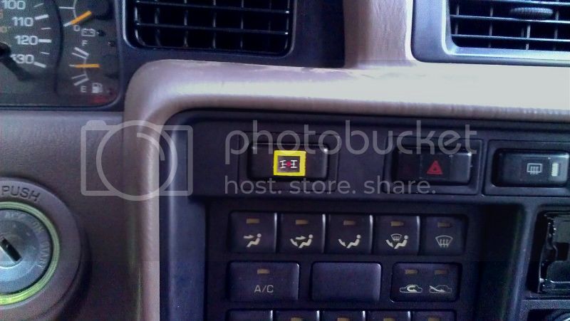

Here is mine in the dash. Was a Hazard, I replaced the icon inside the square hole and have a plastic cover...looks professional from the seat, can tell its off of a printer if you look close. Its the skull and crossbones one.
