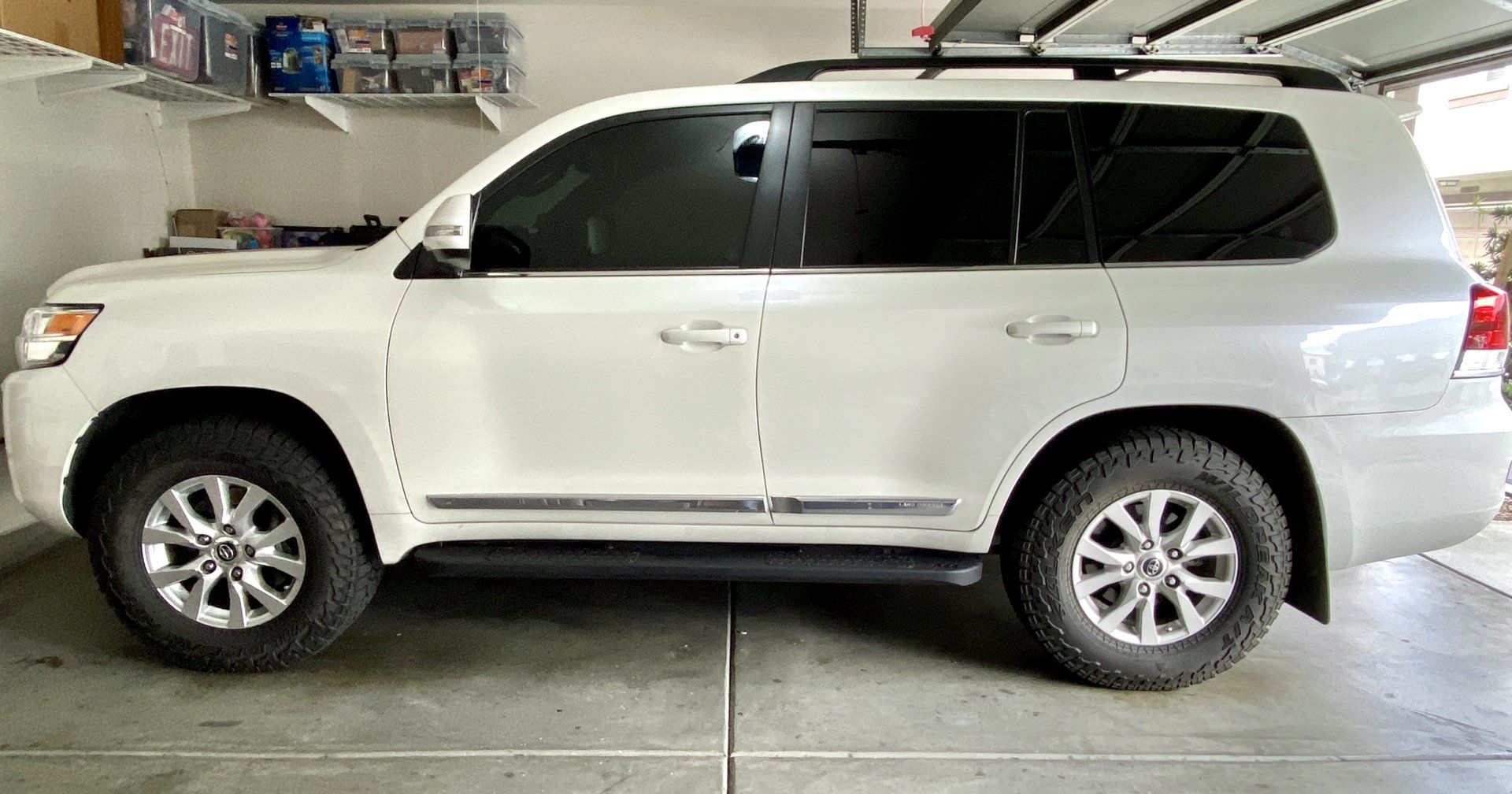

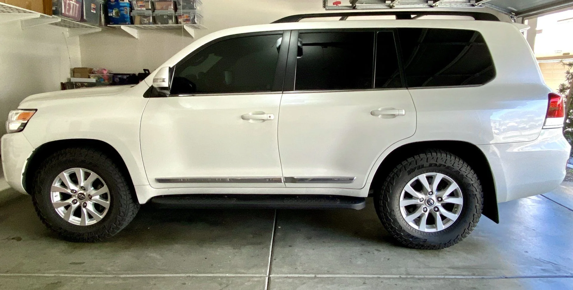

Finally got around getting the front spring oem spacers installed! Found a local shop that specializes in Toyota. Spoke with the owner and shop foreman to get a feel if they knew their way around the KDSS and all. Found out they’re both cruiser owners and and know about opening the KDSS valve no more than 2.5-3 turns. Informed me about the spacers possible affecting the radar and Toyota releasing internal document about it. Anyways, I felt like I was at the right place and got it installed. They charged me 2 hours labor and got an alignment down the street. Overall happy with the outcome. Gained about an inch front ground clearance and leveled out a bit. If I run into issues with radar, I’ll try to level/calibrate the sensor.

Have any shots directly on or from behind of your rig. Curious how the 275s look.
Not at the moment. 275's do look a little skinny to me. Next set would probably 285/65's if I keep the stock wheels. Only downside is, the selection and price.
