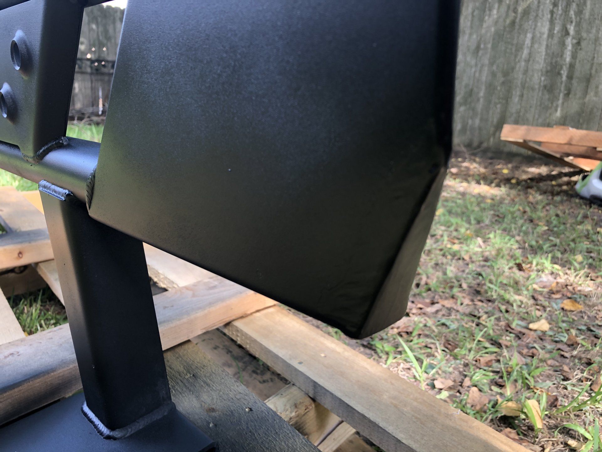

Well it looks like CBI doesn't want the negative publicity. My buddy spoke with them today and they will be sending out a revised set to him next week. The squeaky wheel gets the grease. I hope this replacement set is correct and arrives in a timely manner.
Happy to report that CBI rushed out a new and corrected set of sliders to my buddy this week. He swapped out the old ones and is ready to rock.
Original faulty set, protruding into the wheel well and making contact with the tire with only a slight turn of the steering wheel.
New set, shorter and quartered inboard to better clear the turning front tire.
That looks 1000 times better. I still can’t believe CBI wouldn’t make it right until a lot of attention was brought to the issue.
“Actions (or the lack of) speak louder than words” It really says a lot about their company and management.
Now that's how a proper business should run! 👍
