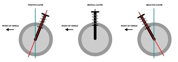

Caster is measured from a vertical line through the center of the front axle.
The front wheels turn on an axis that is tipped FORWARD of the vertical line at the top, and rearward at the bottom. This is "caster."
That would depend on the goal, positive or negative caster, most Cruisers prefer positive.
Thus a stinkbug results in increased negative caster (your image is flopped from mine) and is not ideal. When I first got the car in August, I wanted to fix the stance quickly. I figured; pop in some spacers and I'm all set. Reading about caster plates vs. bushings and the trouble of 4"+ lifts has me going the other way. I'm sticking with 33" tires, so I don't need the height, I think I'll be happier with softer and lower rear springs and leave my front end alone for now.
