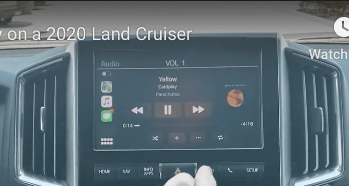

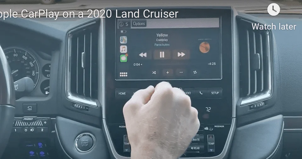

For those of us that don't have NaviPlus, what is the banner that goes on the screen?
I already posted it in this thread. See these two screenshots. When you change volume or something there is a 1 or 2 second delay before the factory "volume" and banner goes away. That is all.

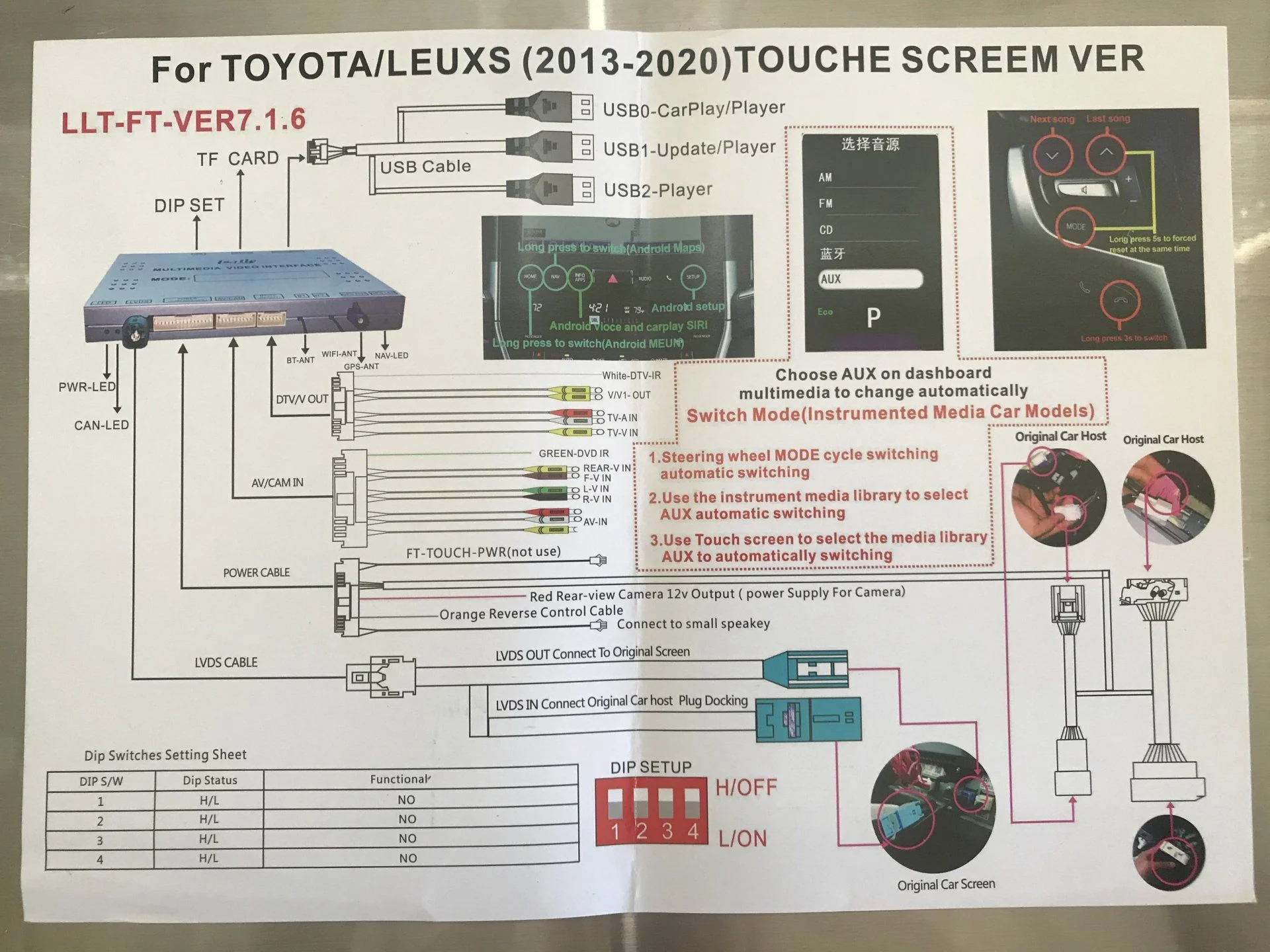

From what I've gathered, installation of the NaviPlus unit is pretty similar to installing the EC Offroad unit that I installed, other than needing to route a cable for the microphone the NaviPlus unit uses (which I'm glad I didn't have to deal with). That being the case, these are largely plug and play installs. Taking the dash apart to get access to the cables that need to be plugged in is pretty easy - just take it slow so no trim clips get broken. Based on past experience with local car install shops, I'm more inclined to trust that I'll do good work UNLESS you have a place you know you can trust to do a good job.
Not sure how similar they are but this MIGHT help?
