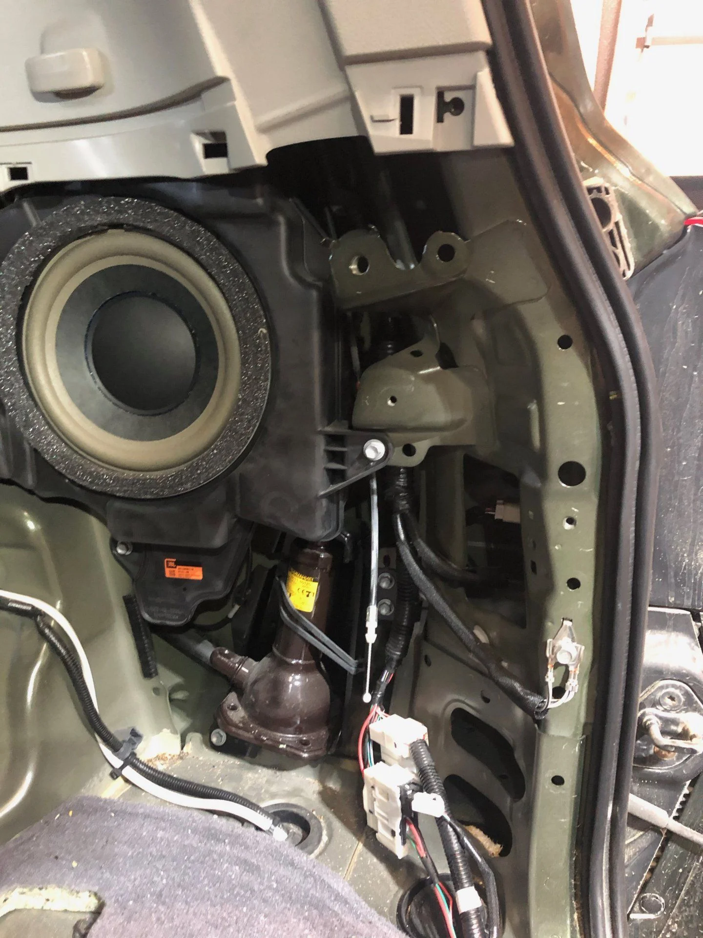

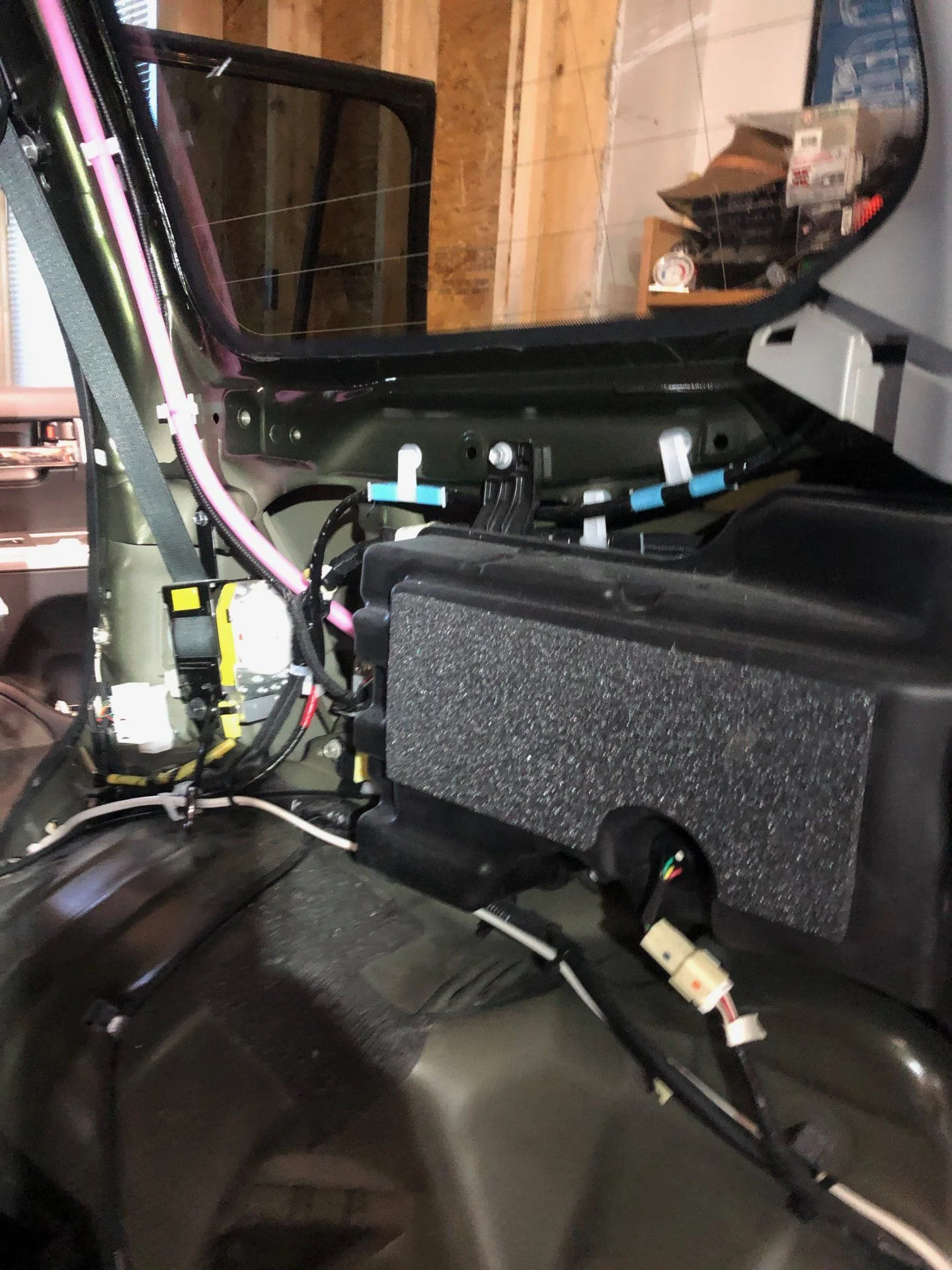

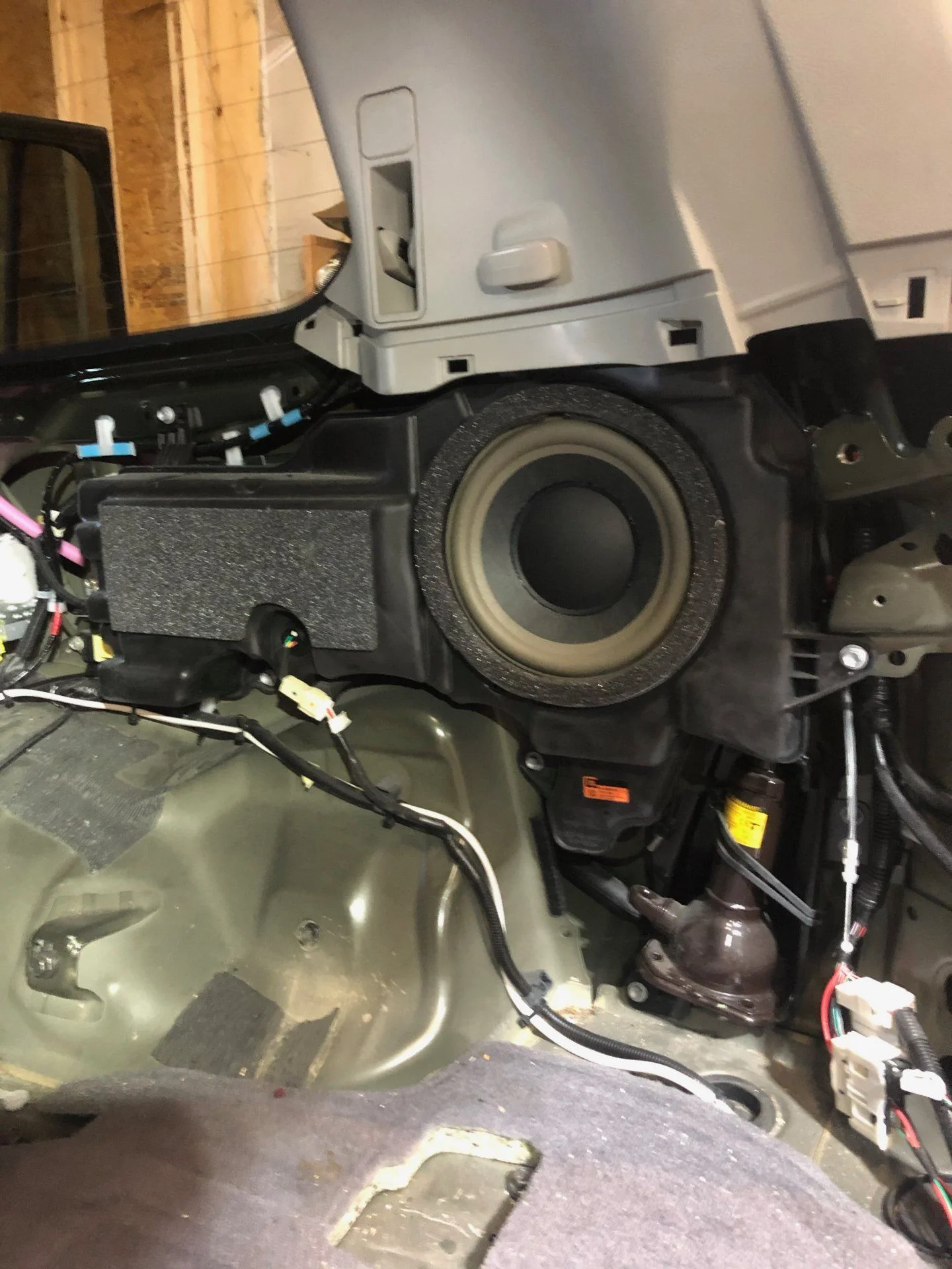

Seems to me the drive side had more stuff behind it than the passenger.
You need to start by removing the tail gate bridge.. and go from there, start at the back. Like said above you need to take the whole panel off.

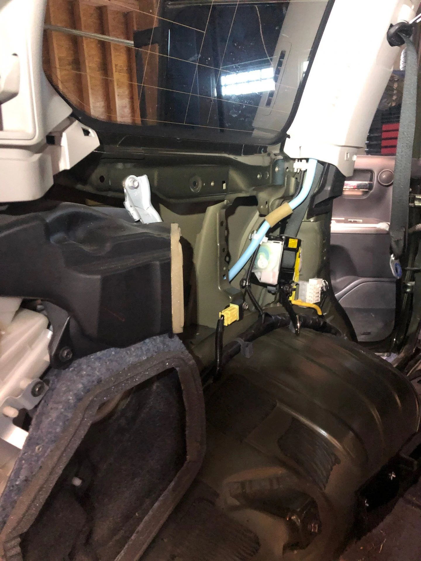

The whole rear AC takes up a ton of space on the (US) driver side, then again, the giant subwoofer enclosure eats a ton of room on the passenger side. There's a fair bit of room in the jack storage compartment area, especially if you ditch the jack and take off the bin attached to the removable door panel.

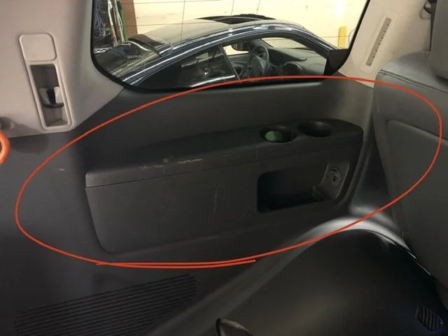

Does anyone have any idea what that little plug looking thing is under the cupholder? Its electrical and I cannot find a single thing abput it even in the users manual.
That is a temperature sensor for heat/air conditioner.
