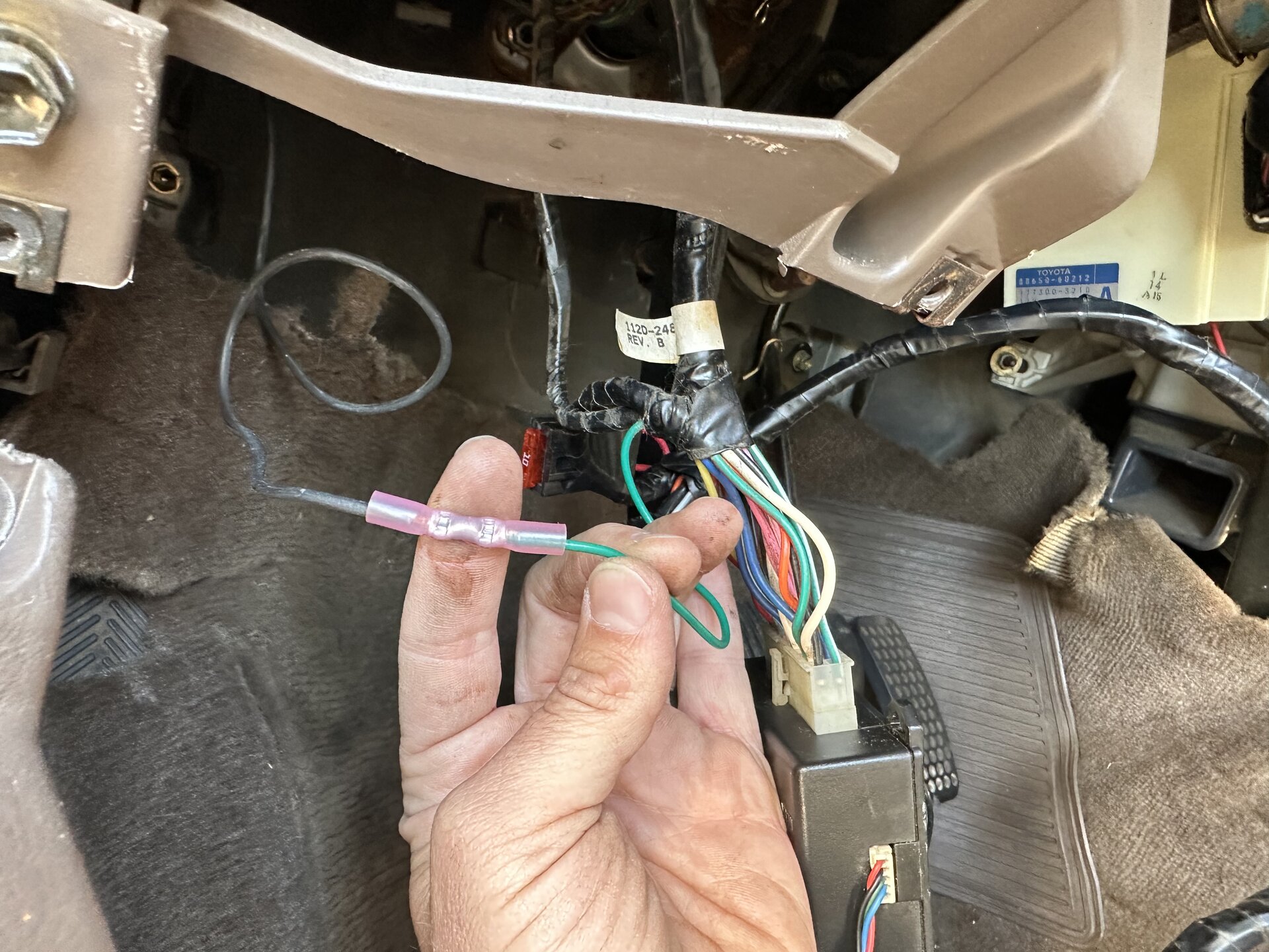

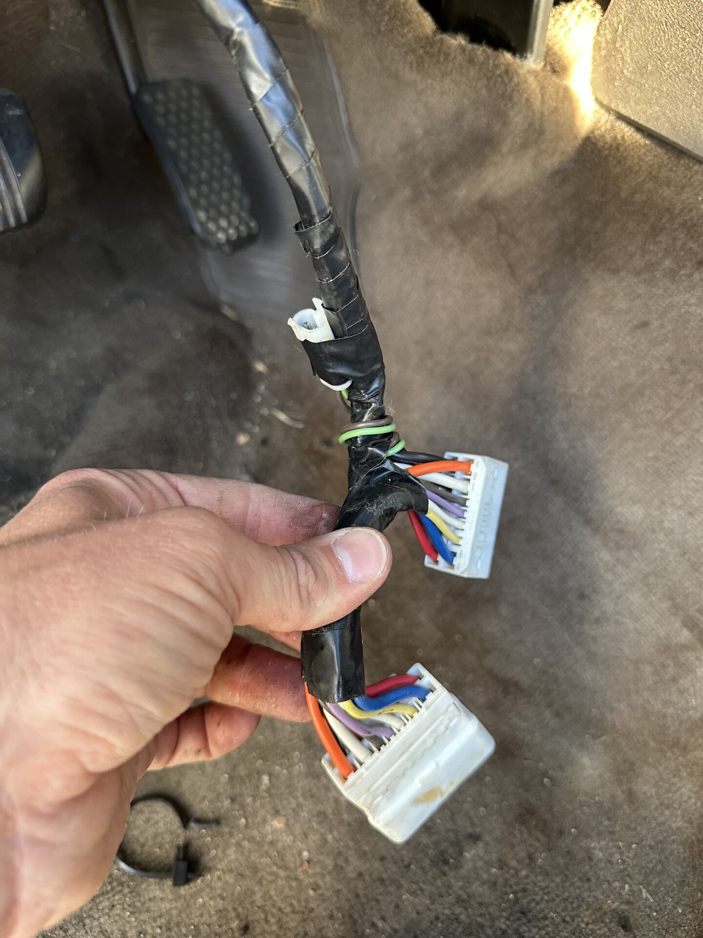

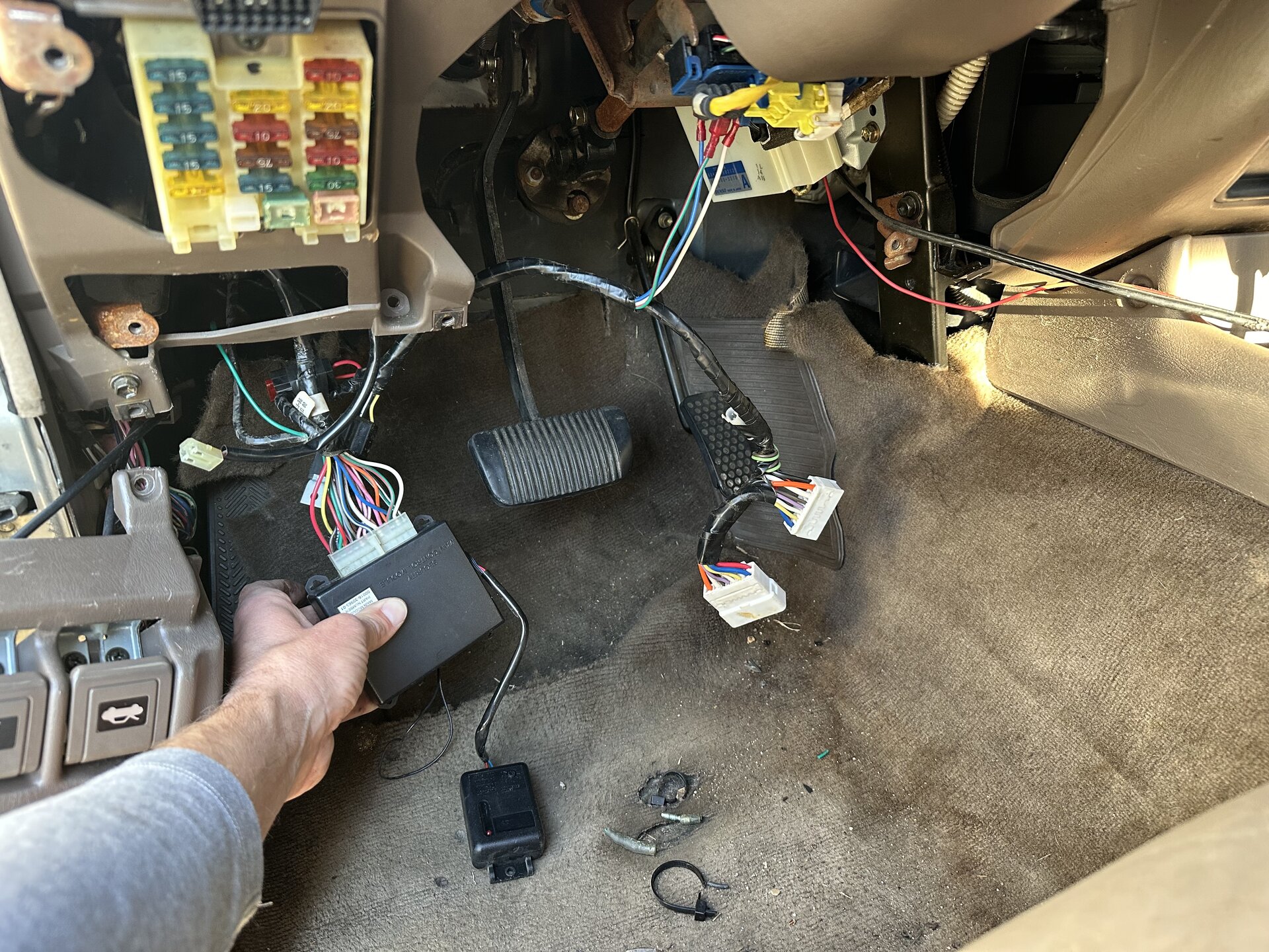

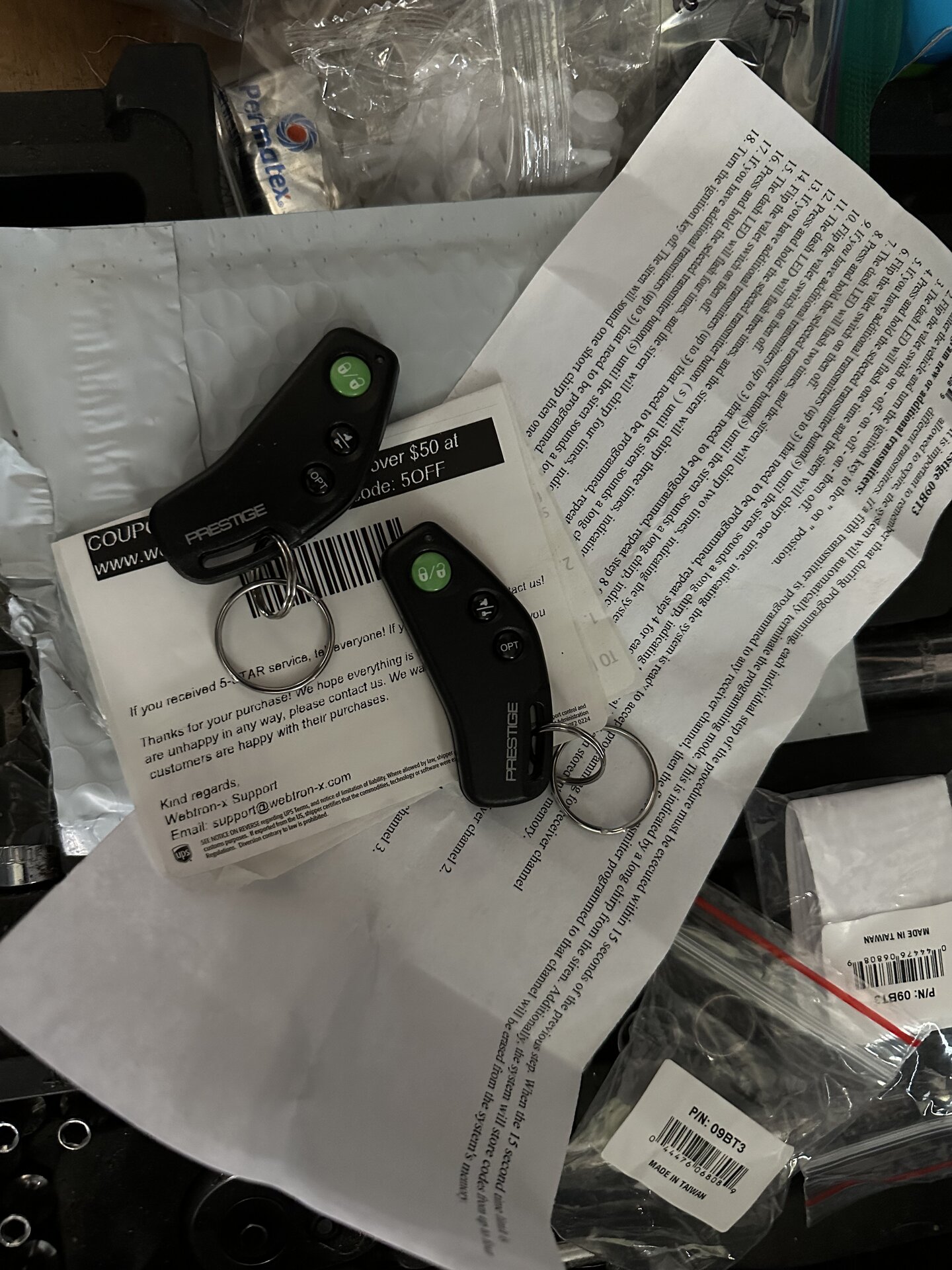

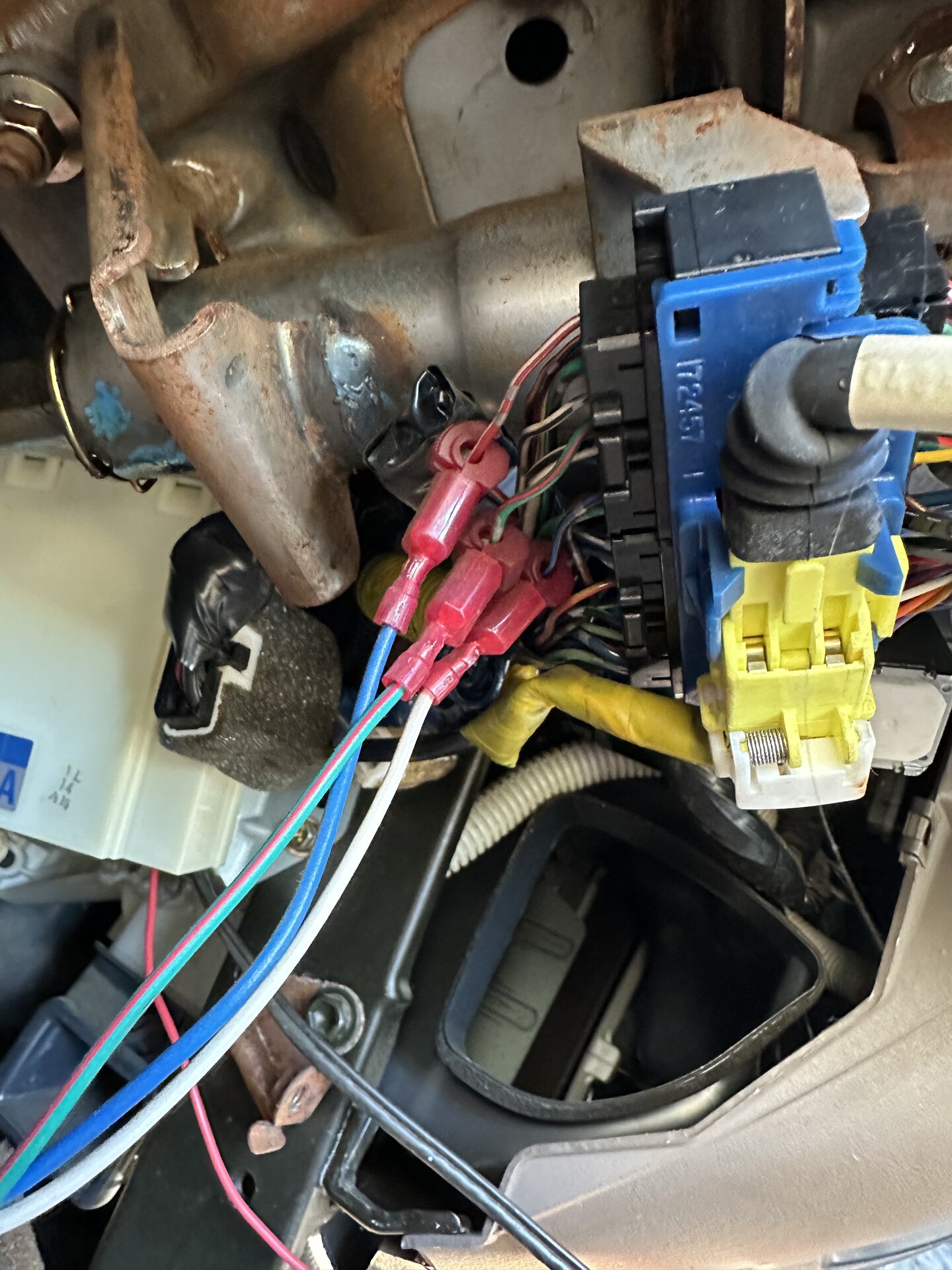

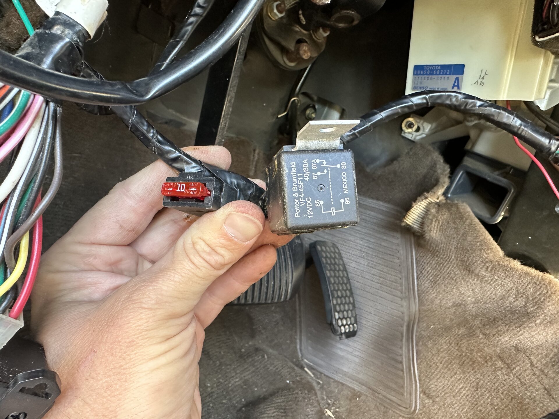

Bringing this one back to life. I’m working on the Keyless Entry on my 97 40th Anniversary Reatorstion. Per this thread, I found that I also have a Southeast Only Dealer Installed Prestige Platinun by Audivox alarm system, model APS-400 (corresponding Keyless remote FCC ID is: ELVAT5G. Model APS 95 BT3).
Before I chunk the system in the trash, I wanted to see if I good bring it back to life. I bought 2 new APS95BT3 Prestige remotes off EBay for $20 each (and free returns). When I went to program them, I quickly figured out that I do not have power to the system at all. I removed the knee panel portion of the dash and this is what I found. Clearly a lot of unplugged stuff. The 10am fuse is fine, but all the unplugged stuff is likely why I have no power. Can anyone help me decipher what is going on here?
And if this is pointless and I just need to kill off the system and do a Viper one or something, how would I get this back to stock?
