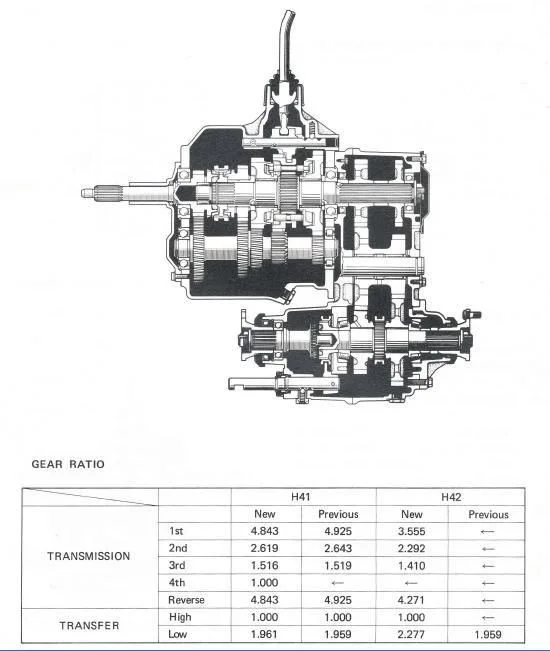

There are not any external features of the H41 that set it apart from the H42.
The only sure way to tell is to remove the top cover and look at the size/count the teeth of first gear, or when it is not installed in a vehicle, to put it in first gear and count the rotations of the input shaft vs the output shaft...
The H41 definitely should have a noticebly lower 1st gear:
Maybe you put in another H42 by mistake?

Ricky is slightly mistaken.
The H41 is always the low 1st gear package in the H4x series. They are 5.2ish in 74-earlier, 4.9 75-80, 4.8 81-later.
The H42 is the tall 1st gear version, with 1st gear always around 3.6
well, I learning every day, I believe your correct, the link with all the different gearings is verry interesting
