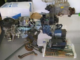

The fj and hj starters are quite different and are not interchangeable. These parts from the 2H diesels are long lasting and with serviceing are very long lasting.I can post some clearer pics tomorrow morning as the starters,alternator and air compressor are packed in a box. I am sure Cruiserdan would be able to source most parts for you. There are many shops in Oz that will ship to the USA for the less comon parts.The 2H is fitted in forklift trucks in the USA and engine parts would be available there. see Toyota forklifts.
