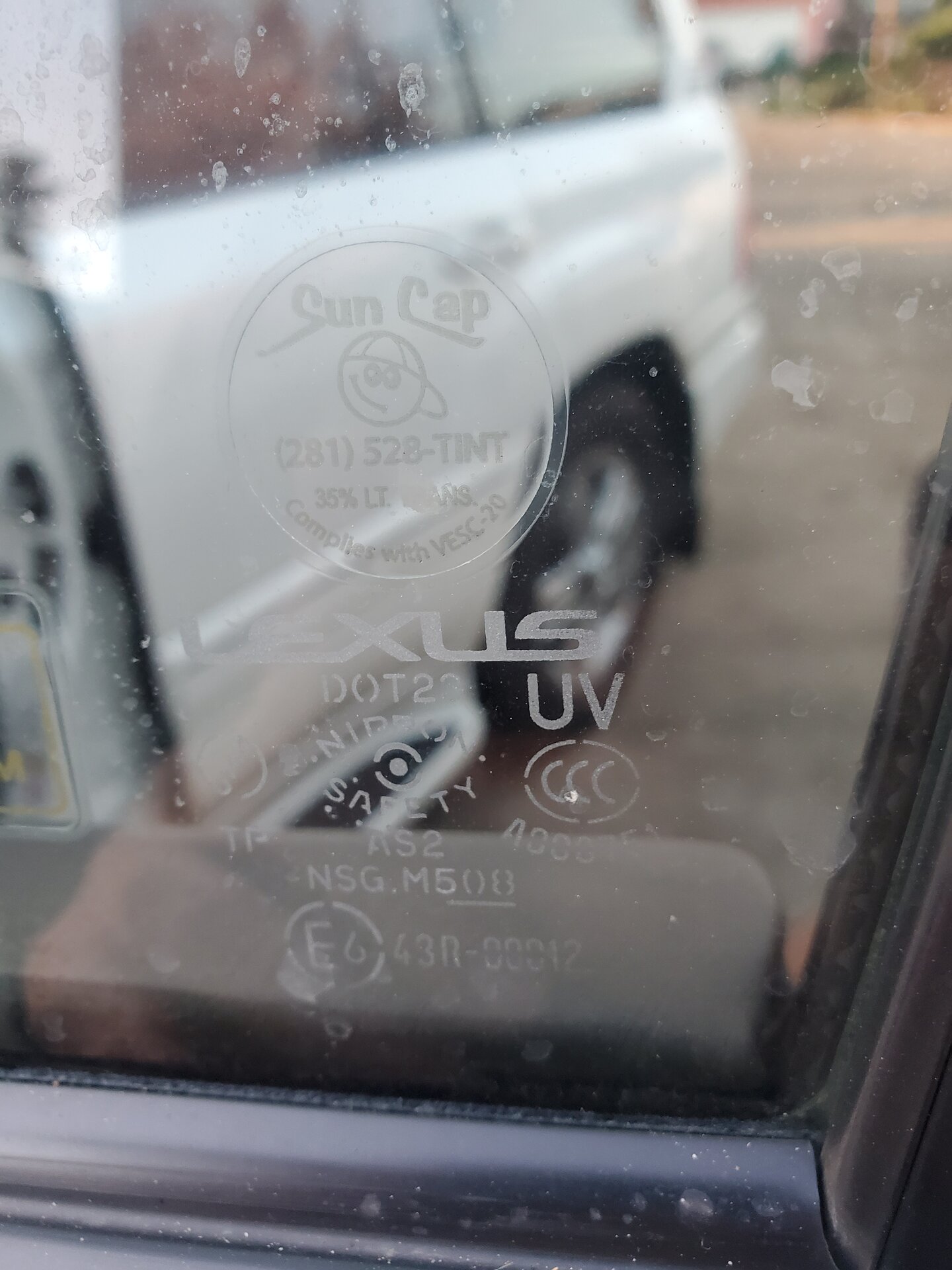

I have some aftermarket tint on my 2006 LX. It is gray and dark and... reflecty. Not just on the outside, but because it's pretty dark (35%), it seems to reflect more of the light from the inside (for example console lights when it's cloudy or even the raindrops themselves when it's rainy).
I assume the actual % transmission is even lower than 35% since it's factory glass so there's probably already green tint on it.

2. Factory tint is around 20-35% VLT. That's to say 20-35% of light goes through it. Your sticker indicates 35%. That's relatively light in the tinting world. If 35% is "reflecty" then you must have some really, really old and terrible tint.

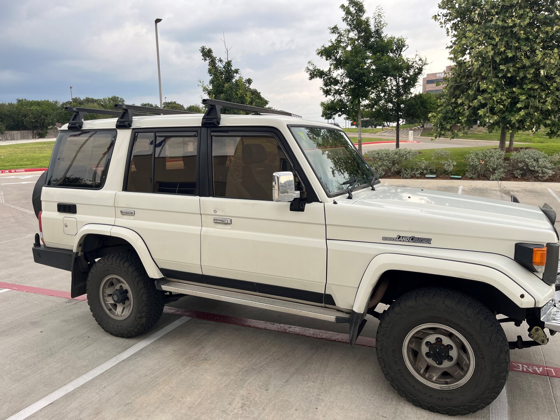

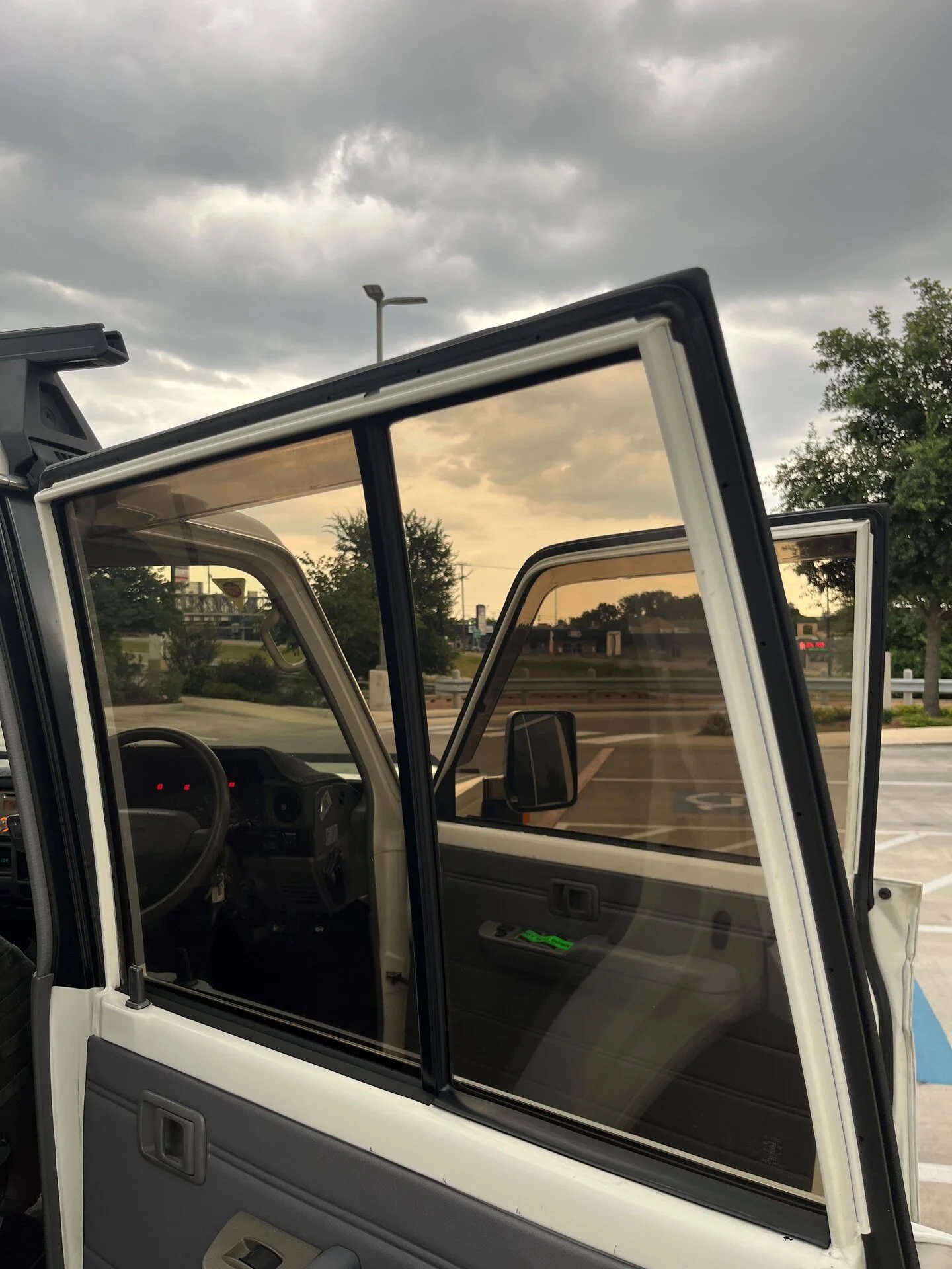

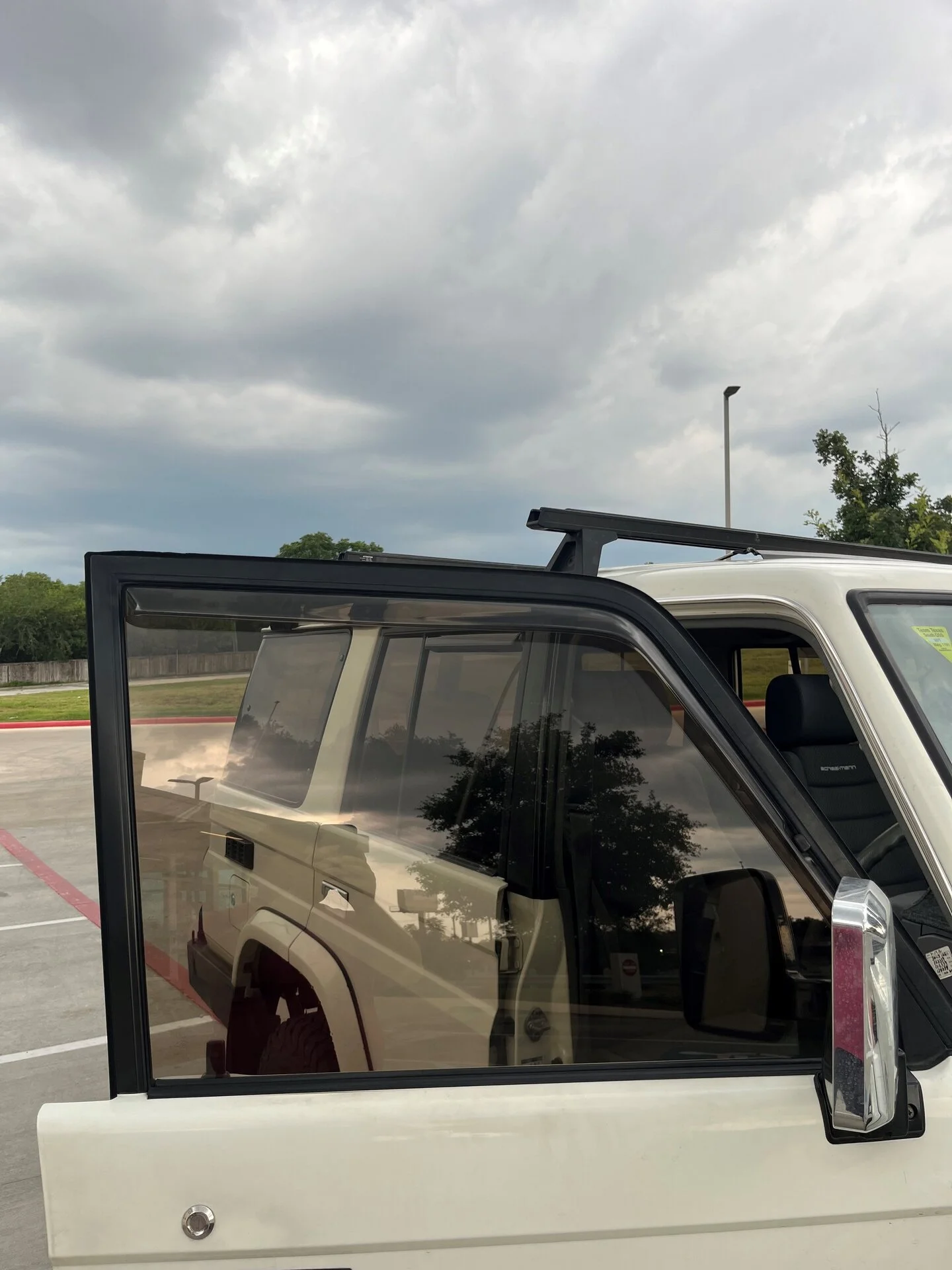

Not a 100 series and I did a lot of research across the 80 series and 100 series threads as those two sections seems to be where the most discussion comes up for bronze tint so I thought I would chime in with some results of my own in this thread being it is the most recent discussion of the tint.
I took a chance and had some suntek HP bronze tint 40% installed all the way around to replace the failing tint on my HZJ77. It came out really good but no idea how it compares to the factory bronze on the 80 and 100 series. It was not easy to find a local tint shop to even buy this tint for me and only one of them would actually do it. Pretty much all other tint shops would just not even bother or claimed to never heard of bronze tint.
Anyways here are some pics of the 40 HP bronze tint. I may end up going back to get 18 HP bronze on the rear glass. Not sure yet.
View attachment 3335504 View attachment 3335505 View attachment 3335506
That looks so dang good. I haven't gotten around to getting mine retinted but definitely going bronze.
