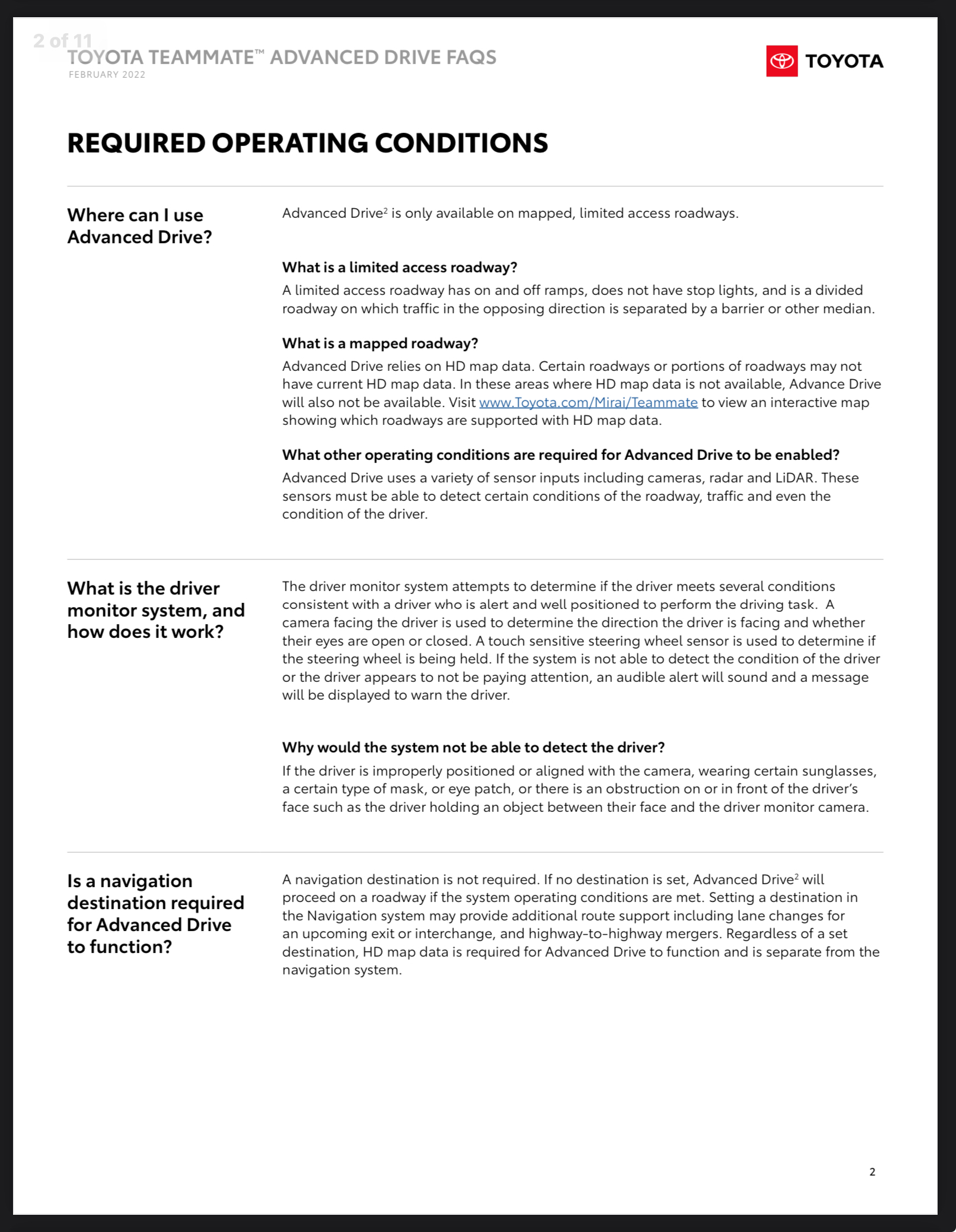

My premium package has it. All premiums and FE should have it based on Toyota website. Explanation of system below. I’ve got all the nanny’s turned off so can’t comment on how effective the system is. Wife’s Subaru has similar but camera is above infotainment.
