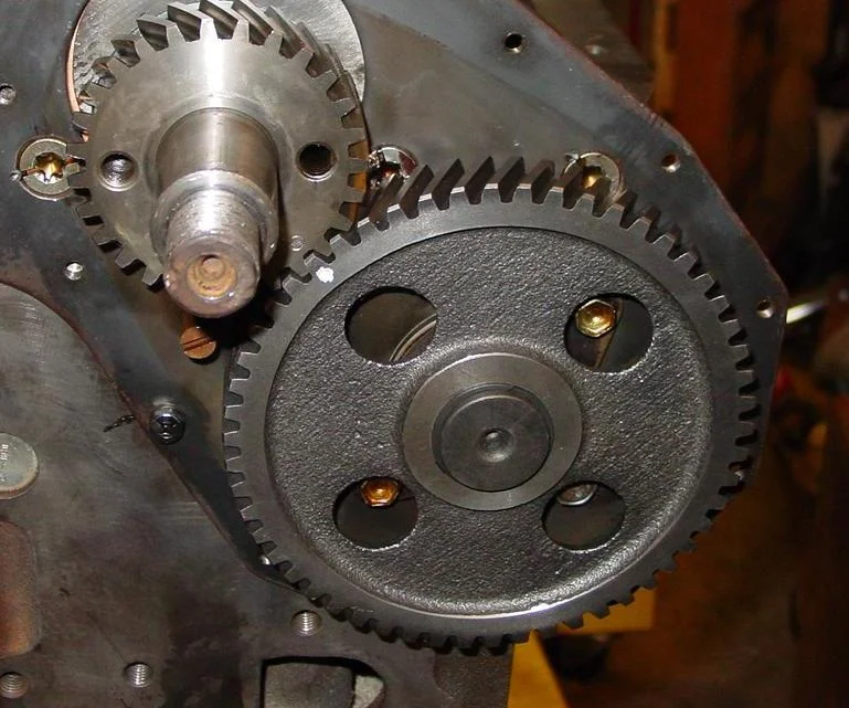

The end plate is between the timing cover and the block...there is a gasket that sometimes fails and looks like an oil pan gasket leak...but is not.
:beer:
Picture is from JimC in the BEST 2F thread...
(will be the same on an F engine)
(upside down on an engine stand) ;)
attachment.php

As you may have already been warned, make sure the brass oil squirter is not overtightened and bottomed out on the front of thre block, behind the plate. Also make sure that you put the various length bolts back into the correct holes. You can bottom out a long one by putting it in a short hole. Either of these mistakes can lead to a leaking plate.
