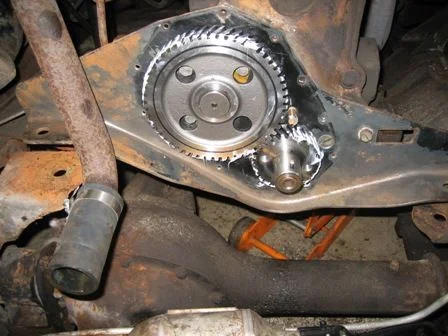

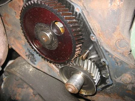

Even if you've got a low mileage excellent early F this can, and probably will, happen to you! :mad: I've had a couple go, this one is Fox's ( so I lied, there are pics). Symptoms.....................you're driving down the road happy as a clam.............and then poof, engine is dead. :eek:
When you check it out there's no sparky, because the cam isn't turning the dizzy.
This looks a lot scarier than it is, yes the F is an interferance engine:

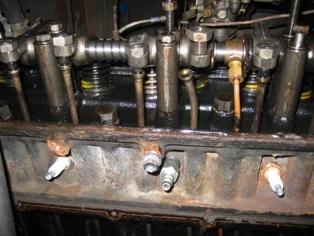

OK, first thing to do is to see if there was any damage to valves or pistons. Kinda tough to do a compression test with no valve action. :confused:
What I do is pull the valvetrain and check all the pushrods. In this case, the intake for #4 was obviously bent, the intake for #1 just slightly. Check the pushrods by rolling them across a flat surface.
Then put an airchuck in the sparkplug hole (see pic) and bring the suspect cylinder up to TDC. Hit it with air, if it kicks over the motor and you don't hear or feel any air rushing out, you're "probably" good.

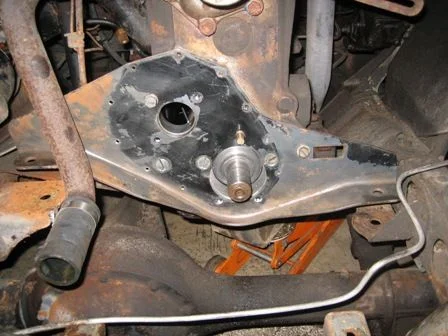

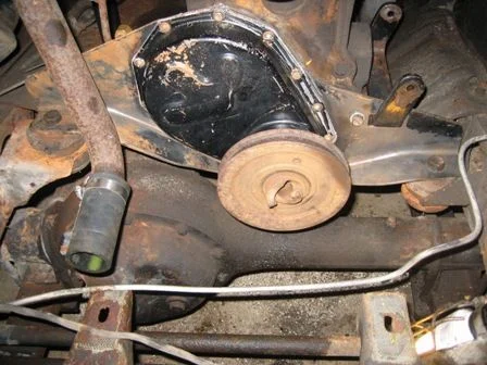

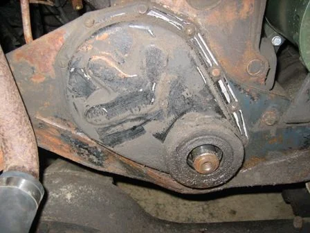

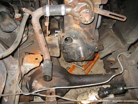

Nuts, now I know why Toyota changed this design. The timing plate is the motor mount. :rolleyes: This was the biggest pain, jacking up the motor and removing the motor mounts (which, by the way, are toast, Fox).
No Krylon or Rustoleum here. :flipoff2: Note the panhead slotted screws used on the timing cover of the early motors. (Mike, that brake line belongs in front of the radiator and should be clipped to the radiator frame horns.)
