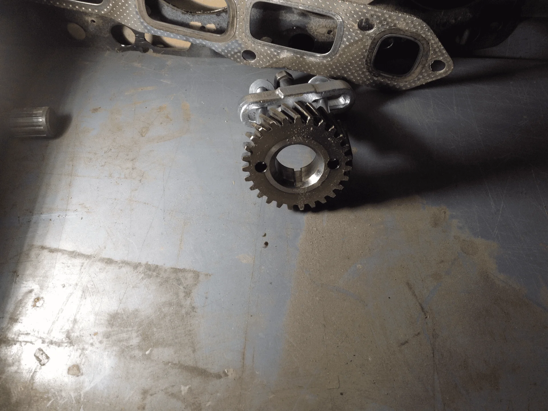

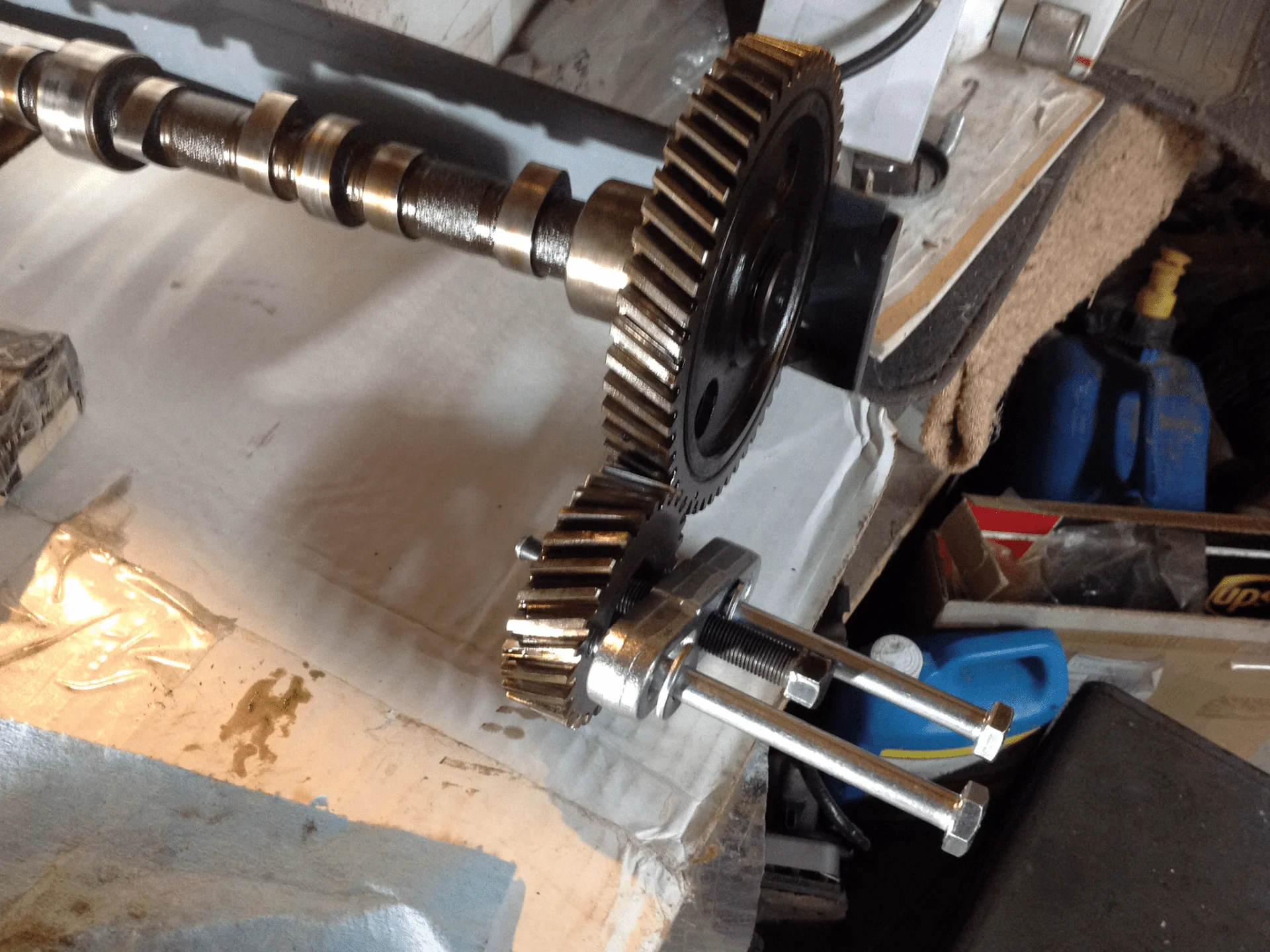

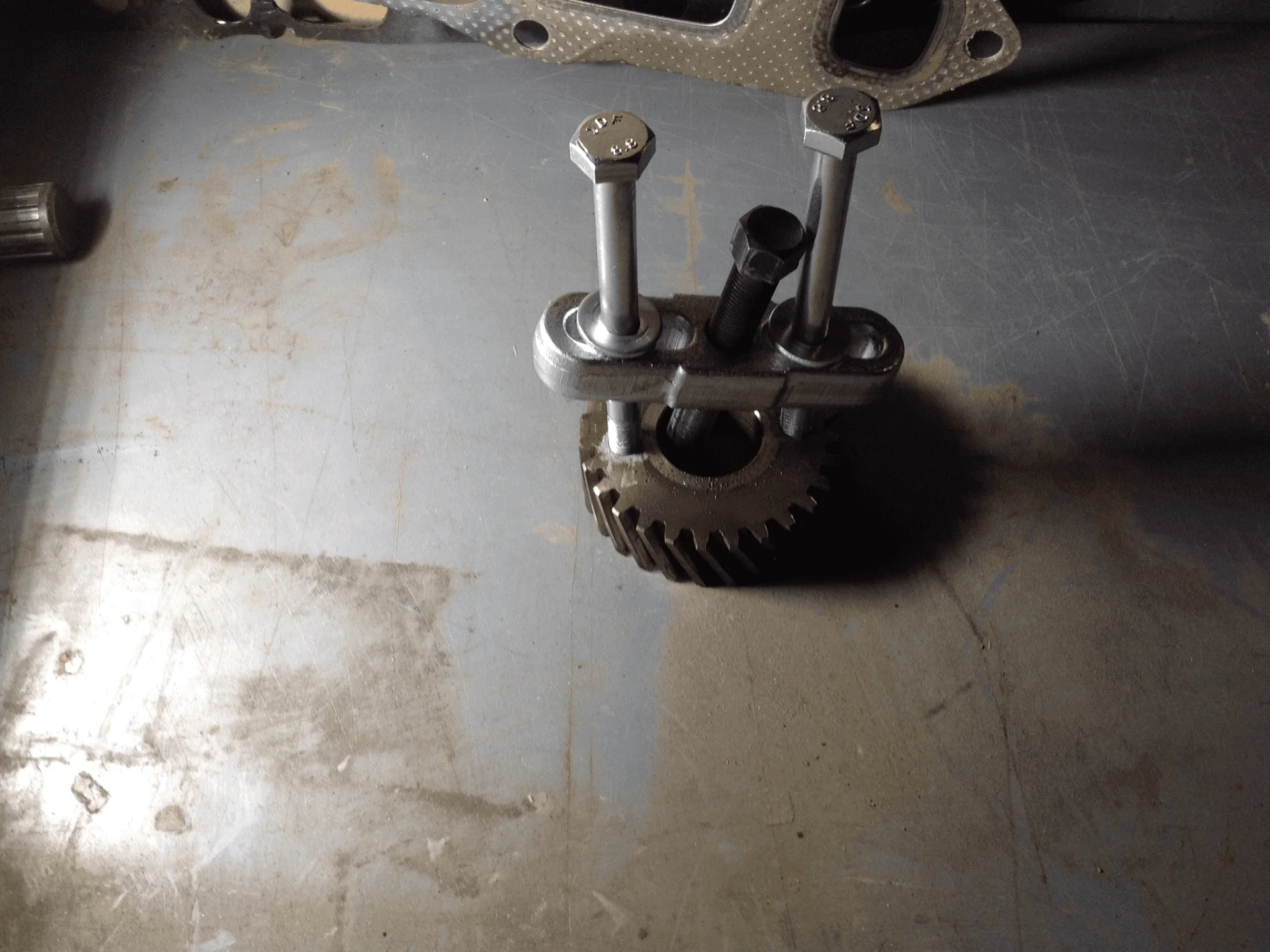

Thanks, John. IHaynes shows removing the small gear on the crankshaft with a puller like your pics. Was asking about the large gear attached to the camshaft. It has a snap ring which I was able to take off with snap ring pliers. The gear seems on the camshaft pretty tight. Didn’t want to start banging or yanking on it until I checked with folks on here.
