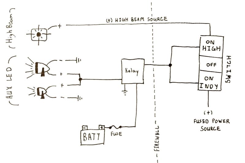

Without the EWD for your rig, this is quick sketch of what I would do with the gear you have. Adding a 5A fuse on the high beam source (if tapped at head light or in engine bay) would be a good idea that is not shown. I am not sure where a (+) high beam source can be found behind the dash without digging into an EWD.
I'd skip the underground cable splices and simply solder/heat shrink the weather pack connector pigtails to the lights.
I'd skip the underground cable splices and simply solder/heat shrink the weather pack connectors to the lights.

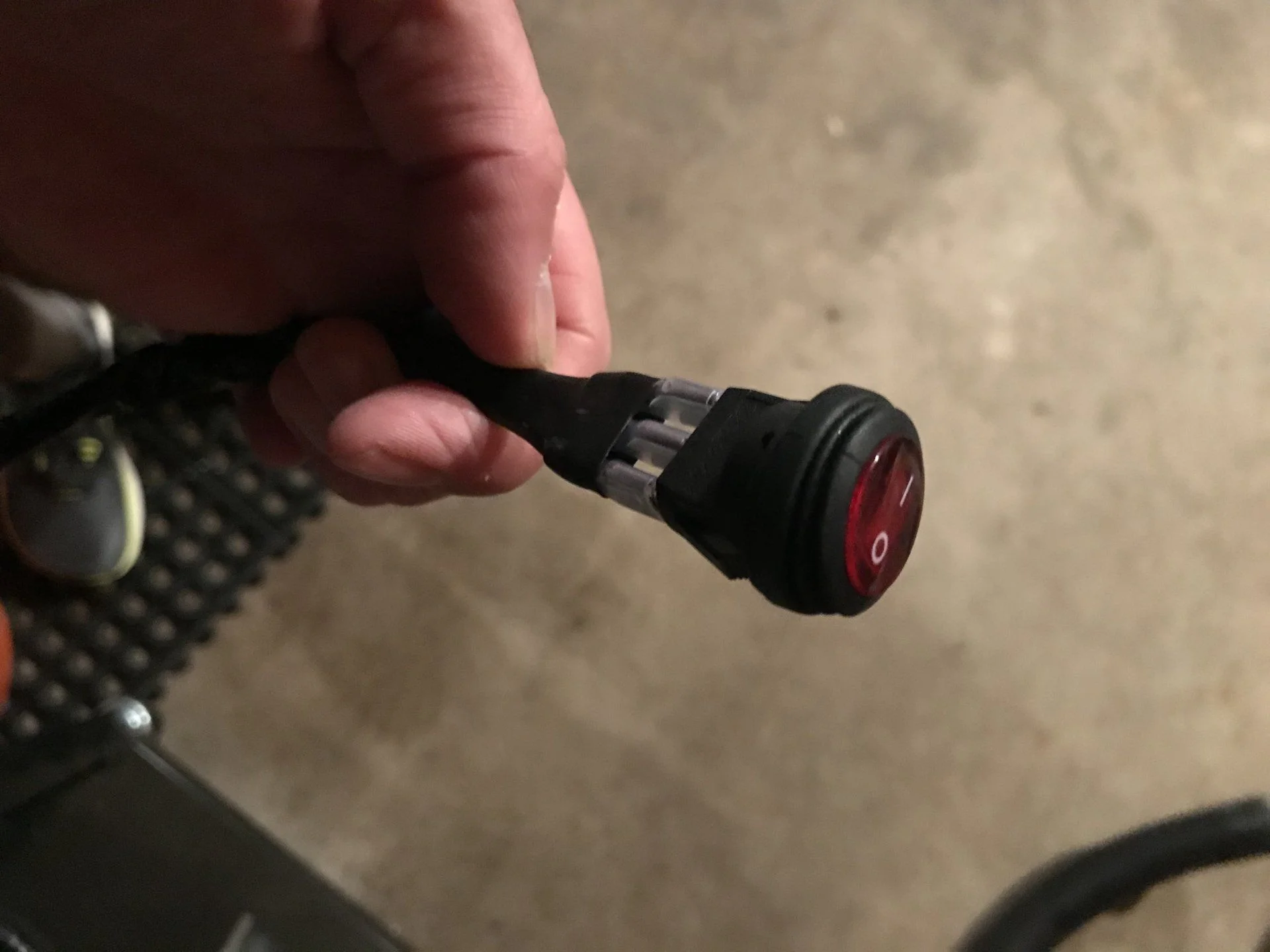

The switch with the hella kit is illuminated so that solves the 3 wires running to it. The new switch is not lit so should I just discard the black wire? Do I need to terminate it somehow?

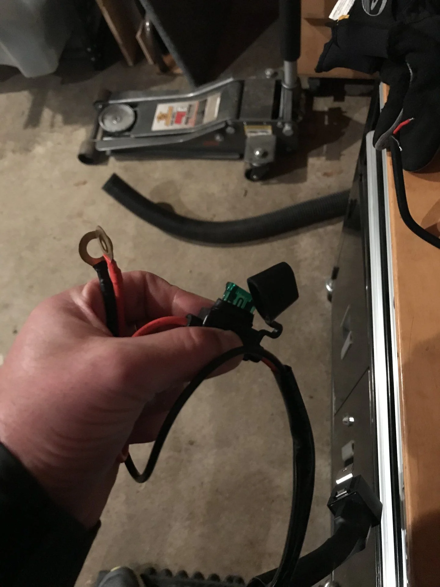

The two ring connections that are coming from the harness. The red goes to positive and has a fuse in line already. Good! The black wire I assume is the combined ground from the two lights and should be grounded by the battery somewhere as the cable is about the same length as the fused red one. Right?

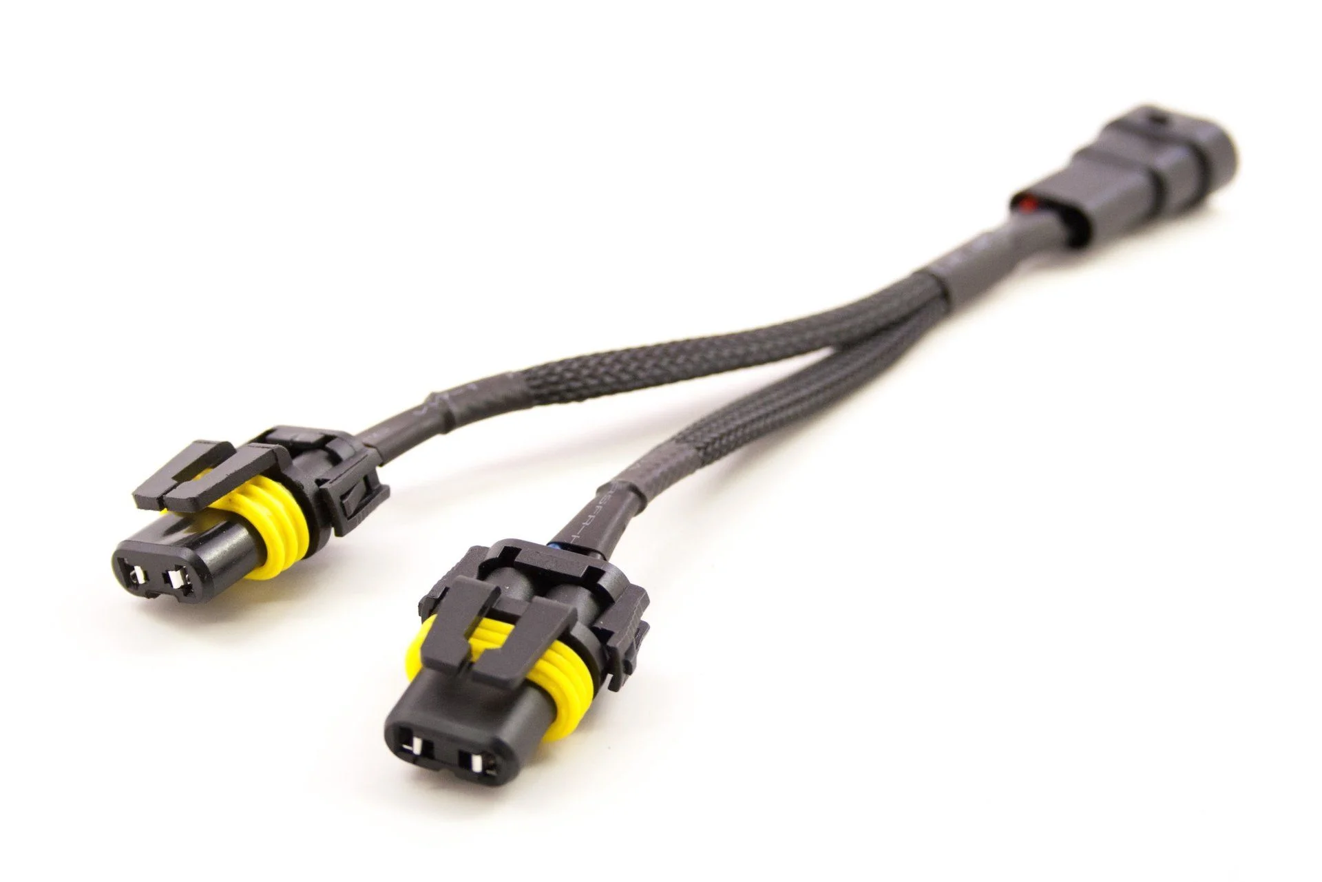

To tap into your high beam without cutting into the wiring harness (this is optional, of course), consider something like the TRS splitter (High Beam Splitters). You need the one that looks like this, I think (for an LX at least, possibly different if you have an LC)
And then something like this (well, the opposite of this)

Oh yea! That looks like a great option to keep things clean and organized. The goal is to not hack this one together... I have had a car that was wired up by someone who clearly cut corners on the components and connections. Those look like good options.
So you take the end of the high beam connector, split it, run one back to the high beams and then run one back to the double throw switch with a 5a fuse in the high beam (source) line?
Also the trs splitter goes 9005m (which is the right connection for the high beams I verified) to 9005f/9006f. Is that for splitting to some other source? Wouldn’t I just want 9005f/9005f on the split side? Does it matter? They look very similar...
That sounds right. The high current stuff is all drawn directly from the battery and through the relay, so you just need to get a single line/trigger to your switch from the split to trigger the relay.
It might be. They sell a ton of different configurations, good eye looking out for the right one. At minimum, it'll have to plug into the factory harness and one side must plug into your high beams.

High Beam Splitters
Nice, yeah those look right. Grounded lights are pretty common on the LCs. It's been the same since at least the 60 series.
With the Stedi harness—totally understand. I didn't look far enough into it to see if they had a wiring diagram, just looking at that would be helpful (rather than just buying their harness).
And one wire should do the trick. @87warrior's diagram looks spot on. (Really, the only thing I've done is get you to buy more stuff...:rolleyes:)

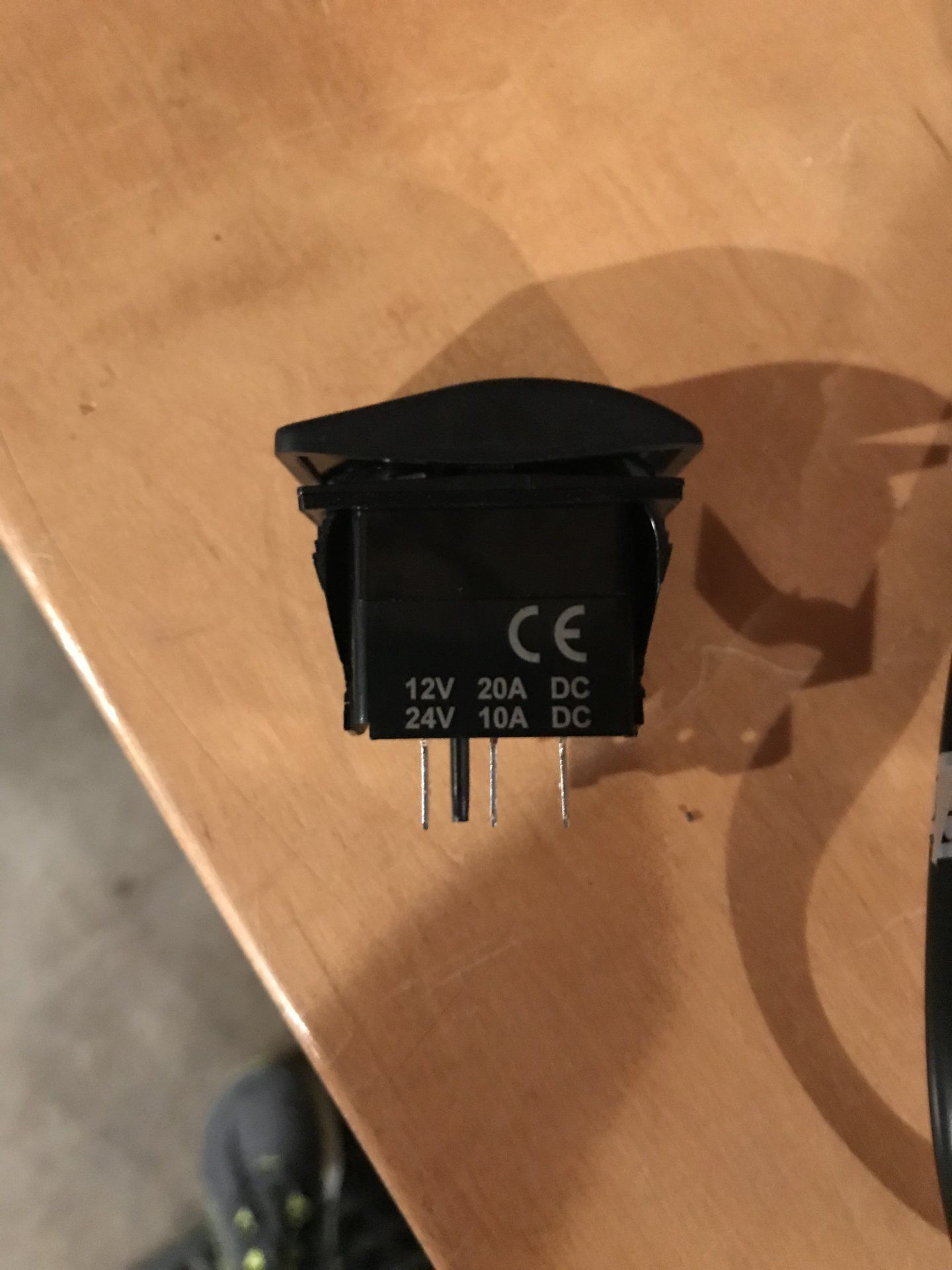

1. how the double throw uses the other spade connectors from the hella single throw illuminated switch.
Your switch looks basic, which is good. The spade terminals on the far left and the far right should be the fused (+) feeds from the headlight and the independent source. The center spade will be the trigger wire running to the relay. This is slightly different from the diagram above since the basic switch consolidates the trigger internally, no need for a splice outside the switch.

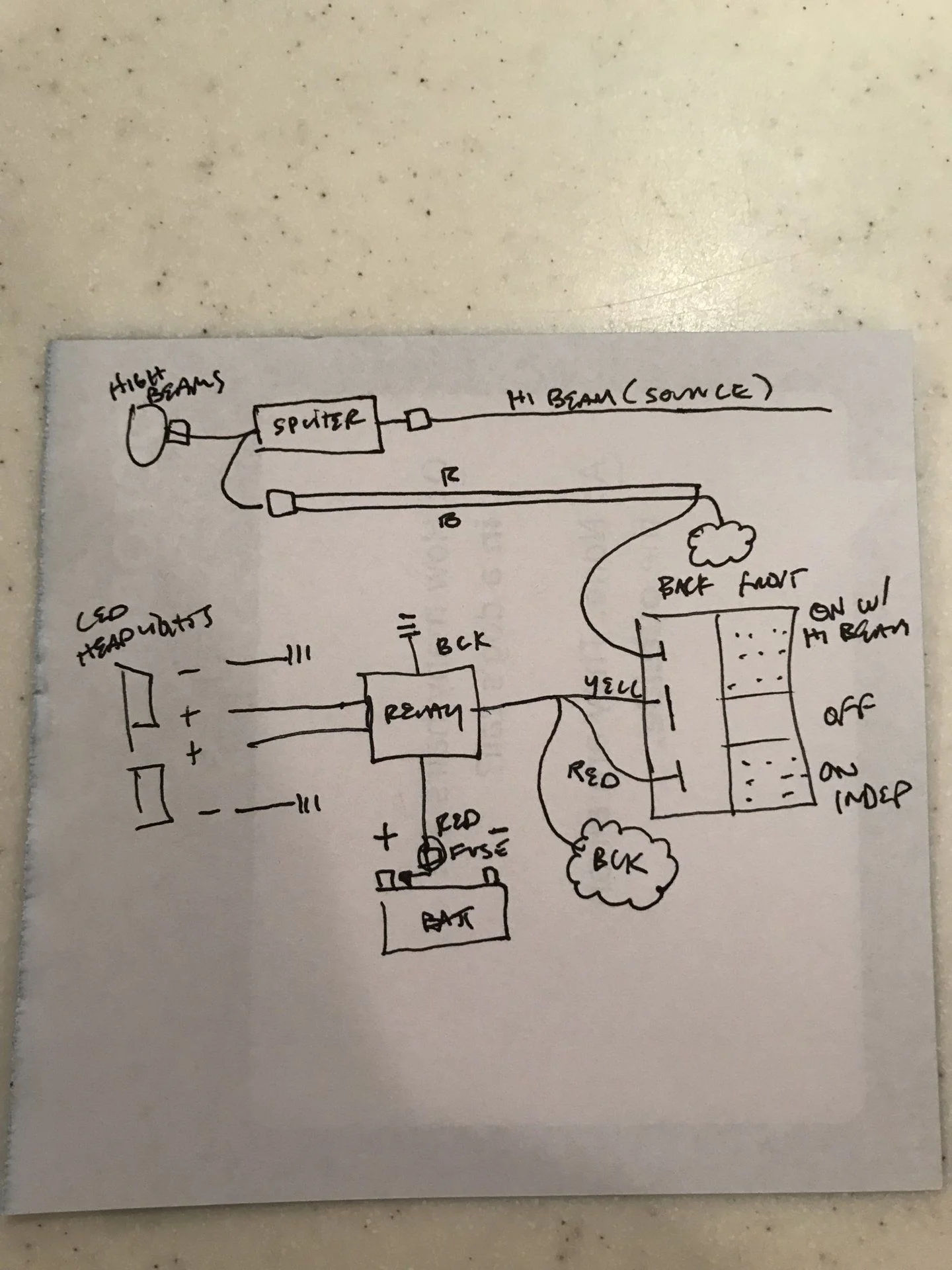

Thanks! Hate to make you respond again... I'm just not sure i'm getting all of the details that I'm still wondering about... There are 3 wires going into the switch that came with the Hella kit. Should I attach the positive (+) red and yellow (switching to relay) to the bottom and middle terminals on the new switch and just leave the black wire spade connector that was plugged into the illuminated switch unconnected?
Do I need to put the 5A fuse in the hi beam source path that comes from the headlight splitter? Which line does that go on. red (+) or black (grnd) and can it go right at the headlamp splitter or should it go by the switch end of the wire?
I can still return all of this stuff aside from the switch on Amazon and just buy the stedi harness... it would be a wash price wise...yay? Nay?
@mookamatook you are almost there 👍 Within the Hella instructions there should be at least one wire diagram for the harness. Can you share a picture of that? It would help clarify how Hella built the harness and allow us to answer those questions without speculation.

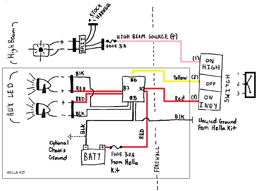

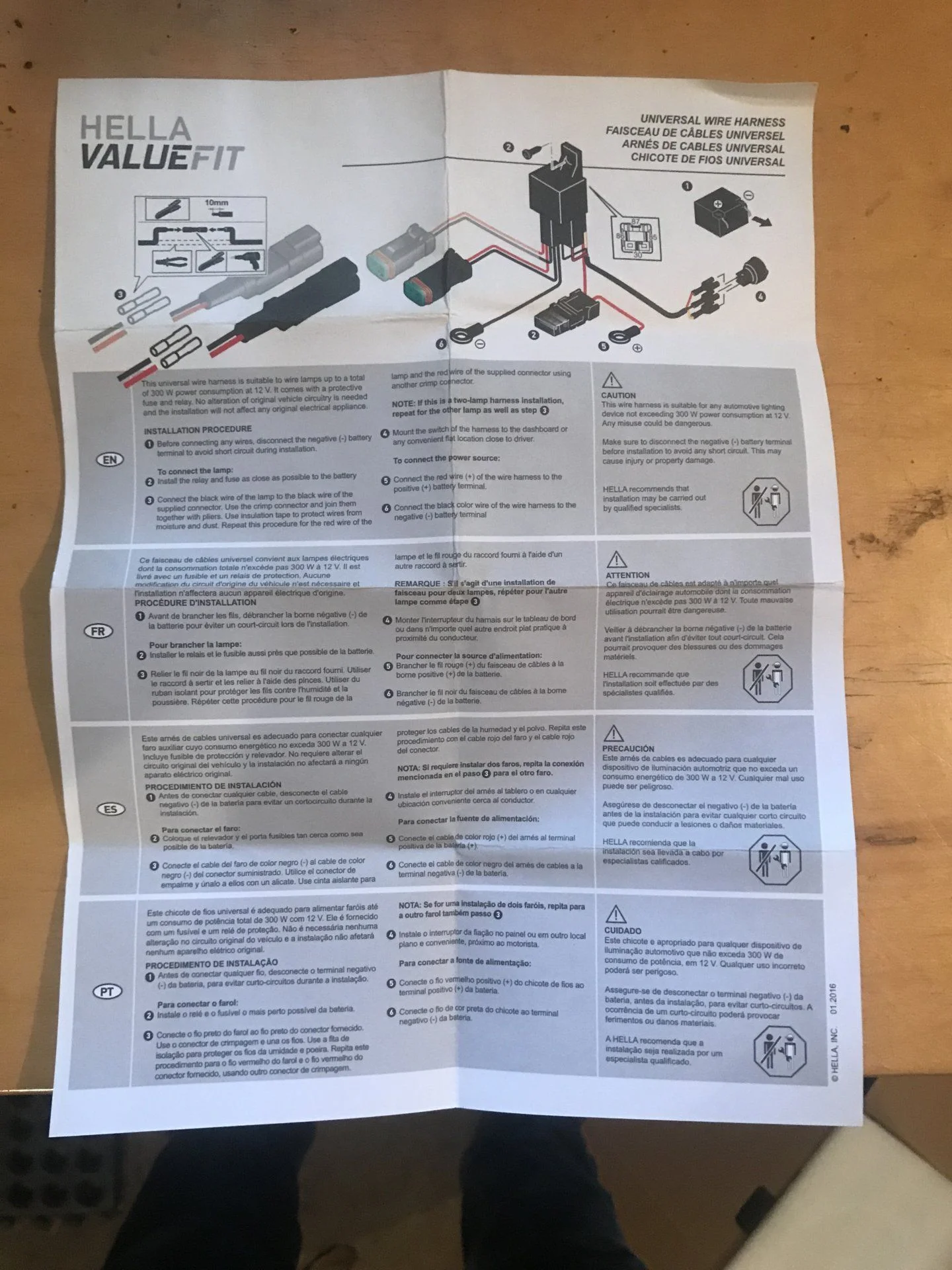

That Hella diagram is terrible! I am surprised that is all the detail they would provide the customer.
It looks like they use a 4-pin relay and run everything back to the relay. Below is how I think the Hella kit is wired based on their cartoon diagram. Integrating the high beam light trigger and new switch should be pretty basic.
A couple of notes:
  • The Hella kit is using independent switch power by piggy backing off the main fused power supply. Your lights will work anytime the switch is flipped to the independent power source.
  • I think it is silly to run ground back to the battery and would choose a chassis ground instead.
  • You can remove or terminate the ground wire intended for the illuminated Hella switch. However, if you upgrade to a lighted double throw switch in the future, that ground wire would make lighting it very easy.
  • Since you are going to use the headlight splitter and a male harness adapter for the high beam power source, I would simply remove the black (-) pigtail from the male harness adapter to avoid any confusion.
  • Don't use Black or Red wire for the high beam source wire to avoid confusion at the switch. I chose pink at random in the diagram.

What happens to the ground wire coming off the 9005 split on the switch side?? The + goes to the 5a fuse and back to the switch, got that. But do I just pull the ground off the male adapter? Also can I just leave the spade connector from the switch light hanging if I don’t ground it somewhere in the cab? Or do I need to terminate it somehow, somewhere? Or I could just get an illuminated switch and return the other one. Does this look right?
12V DC 20A 4-Pin LED ON-Off-ON SPDT Rocker Switch - Amber Amazon product ASIN B01M752E5X
Lastly for the high beam source wire, what gauge is best practices for that application?
Simply remove the pigtail from the adapter. You are only using the (+) from the headlight. The splitter is just being used as an ultra clean way to tap into the high beam source. We don't care about the high beam ground here.
That will work if you like the style. I am partial to simple Carling style switches, but that is just a personal preference.

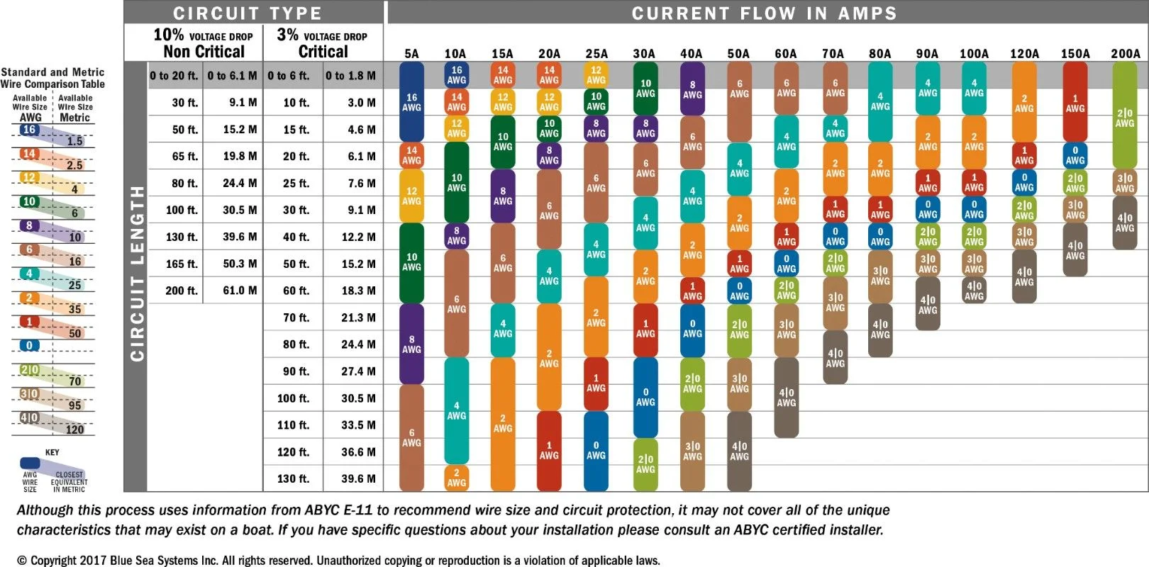

I use this chart to help determine wire sizes. You would probably be fine with 18AWG, but 16AWG is recommend. If you have heavier wire, it will work too.
