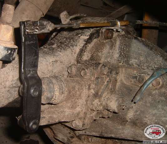

You can use a gear/throttle cable for an outboard enginge. A friend of mine has done this and it works grate and it's cheap. Just take a measure and order one with the correct length at the nearest boat shop.
A picture from my friends mount
http://nlck.no/forum/files/lockercable.jpg
