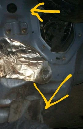

If the cab firewalls are similar to the same years of 4Runners, then the e-brake outlet will differ from the 4 cylinder to 6 cylinder models. The 4 cylinder has the e-brake exit the cab at the firewall behind the engine. The 6 cylinder exits the cab at the bottom of the firewall near the floor.
Hmm. I hope thats not the case but I am sure I will find a way around it with both types of hardware available.
Looks like the dash location is the same or similar anyways.
Thanks and if anyone can confirm Id appreciate it.
I doubt it will be a deal-breaker for you. I believe Toyota did this to clear the exhaust cross-over pipe on the V6. You could probably use either one and be fine.
Pic. My 89 v6.
Looks like the 4cyl hole is there.
