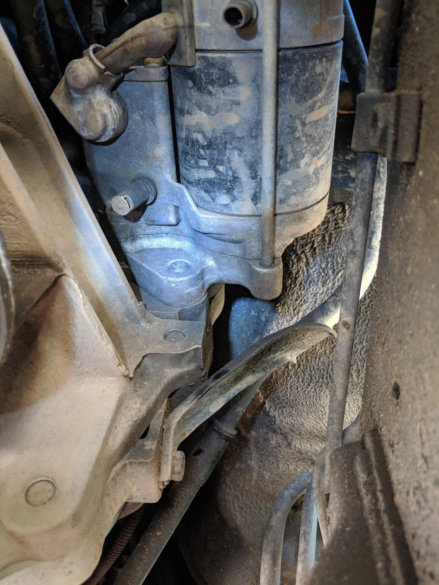

Finally had time to think about pulling the starter today and noticed this.
1997786
Am I correct that this is the lower starter mounting bolt that was broken off? I am assuming this could contribute to misalignment and the starter drive dragging as mentioned above?

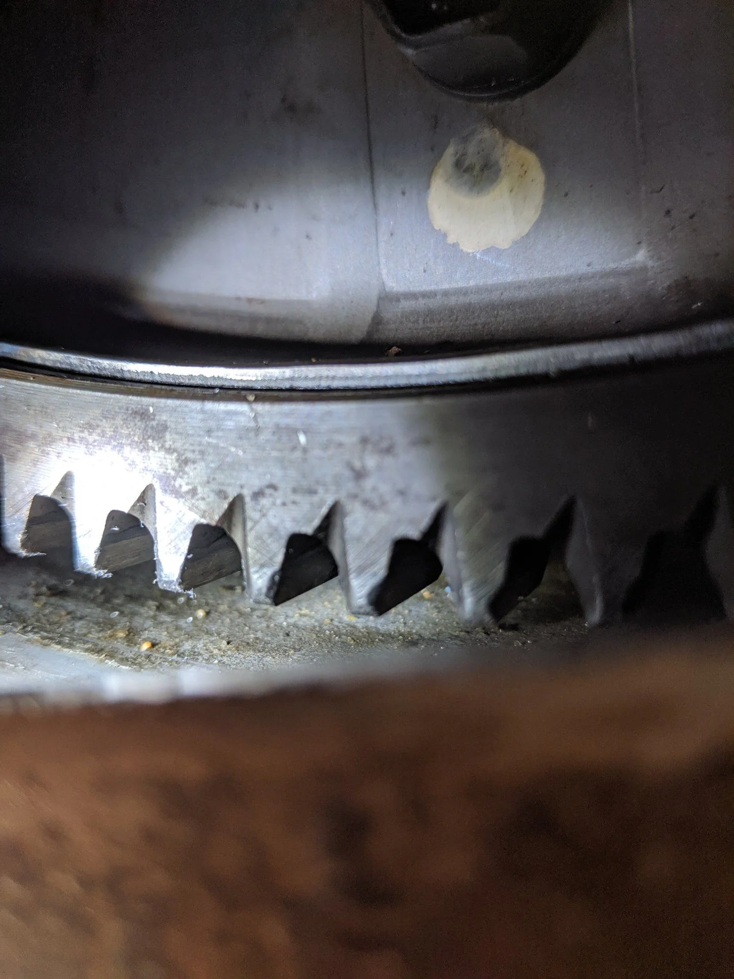

Here is a shot of the flexplate. I hope this can be fixed with a starter replacement and not a new flexplate. How do my teeth look? (Notice the fine metal shavings clinging to a few.)

Teeth look normal both on the starter and the flex plate.

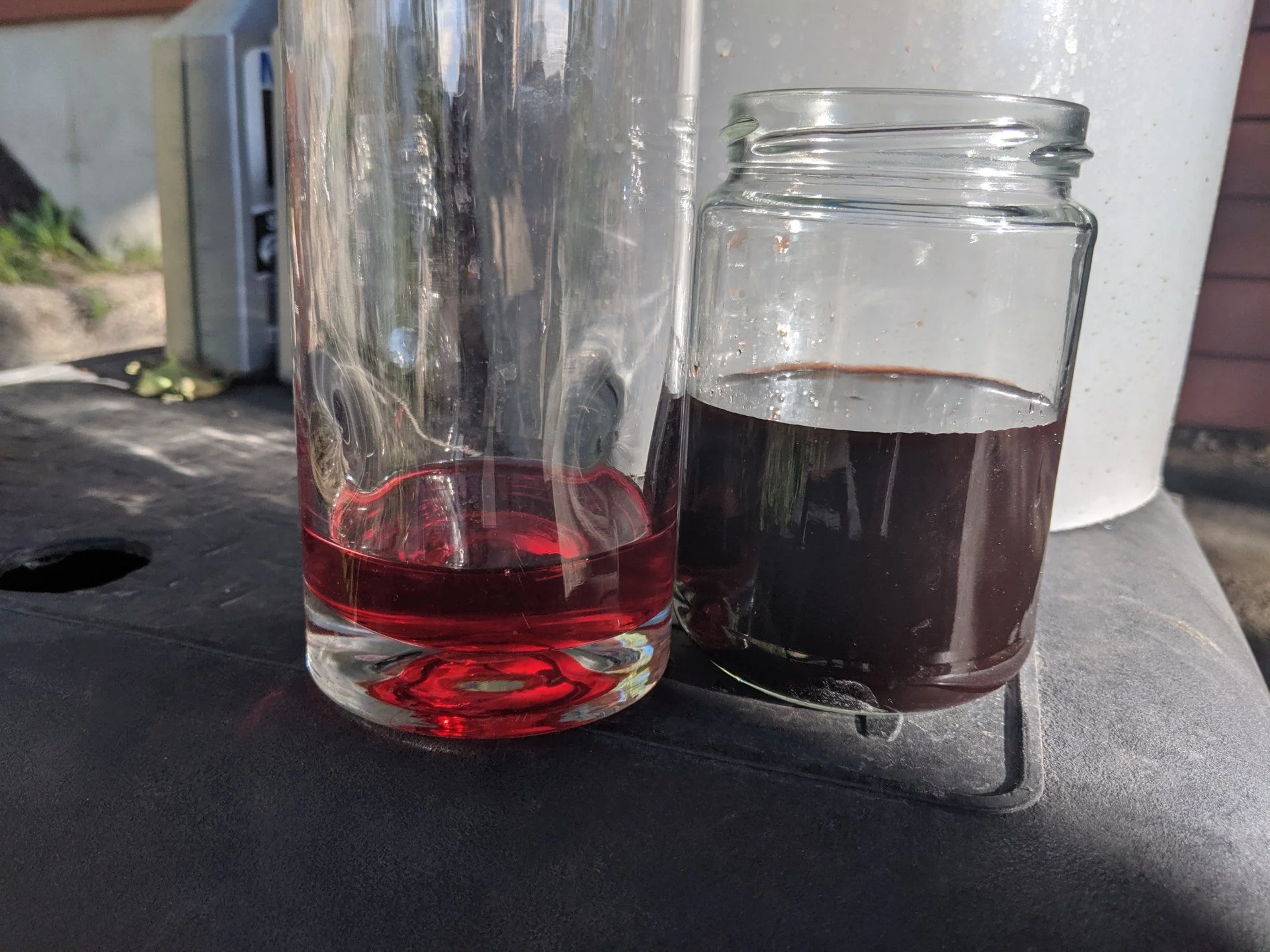

Since I already had lots of ATF around from a recent power steering flush I decided to take the 30 min for a quick drain and fill. Figured it could not hurt and that was one of the fluids I have not changed yet.
1999462
Not nearly as dark on a paper towel. Definitely needed changing but does not appear or smell burnt. Strange since it looked much better on the dipstick.
4.75 qt out and 4.75 back in. Waited for a cold start this morning and no change in the noise. I did run a magent through the old fluid and it is clean, no metal shavings. Is it worth sending the used ATF to Blackstone for an analysis? I'm pretty sure the issue is not internal.
