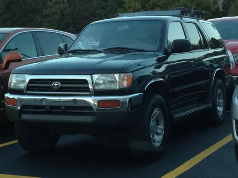

I'm looking into buying a 98 4runner . It appears to be in decent shape. Rusted bumpers etc. The frame looks good. Any advice on specific items that I should check before purchase? Thanks everyone for your advice.
140,000 miles, automatic 4wd
Here is a pic

I'd look real hard at the rear frame (and everything under the truck). Maybe 'test drive' it to an exhaust shop and have them put it on a lift. I'm from Michigan, and I'd work hard to buy a 14 year old truck from almost any other state! This vehicle may have been parked over dirt its whole life, and never garaged or washed in the winter. Read other FAQs about stuff like rear axle bearings and seals, and the radiator issues with auto trans trucks.

I have the same 4Runner, I paid $3200 for it almost 2 years ago in NJ - NJ is a great place to buy an SUV since there are no mountains no woods, the toughest driving this thing had on it was driving kids to soccer practice. It also had around 140K miles. I would try to talk them down by at least $2K.
