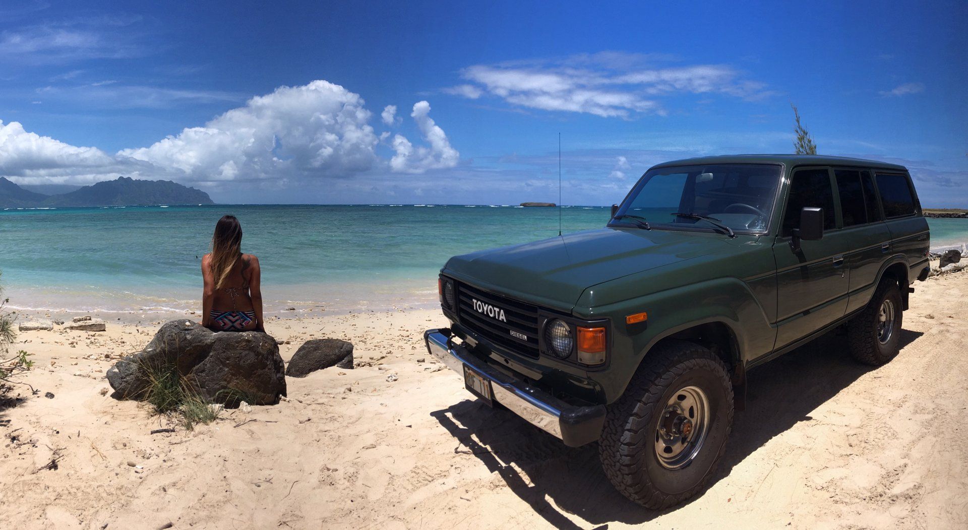

That is just too funny.
To the OP, if you shave the badges off the new cruiser I'll buy them, they are hard items to find.
Hahaha - I love the attention the shaved badge is getting. I simply was trying to display my wrenching ability and clearly chose a detail that is unheard of in the community haha!
