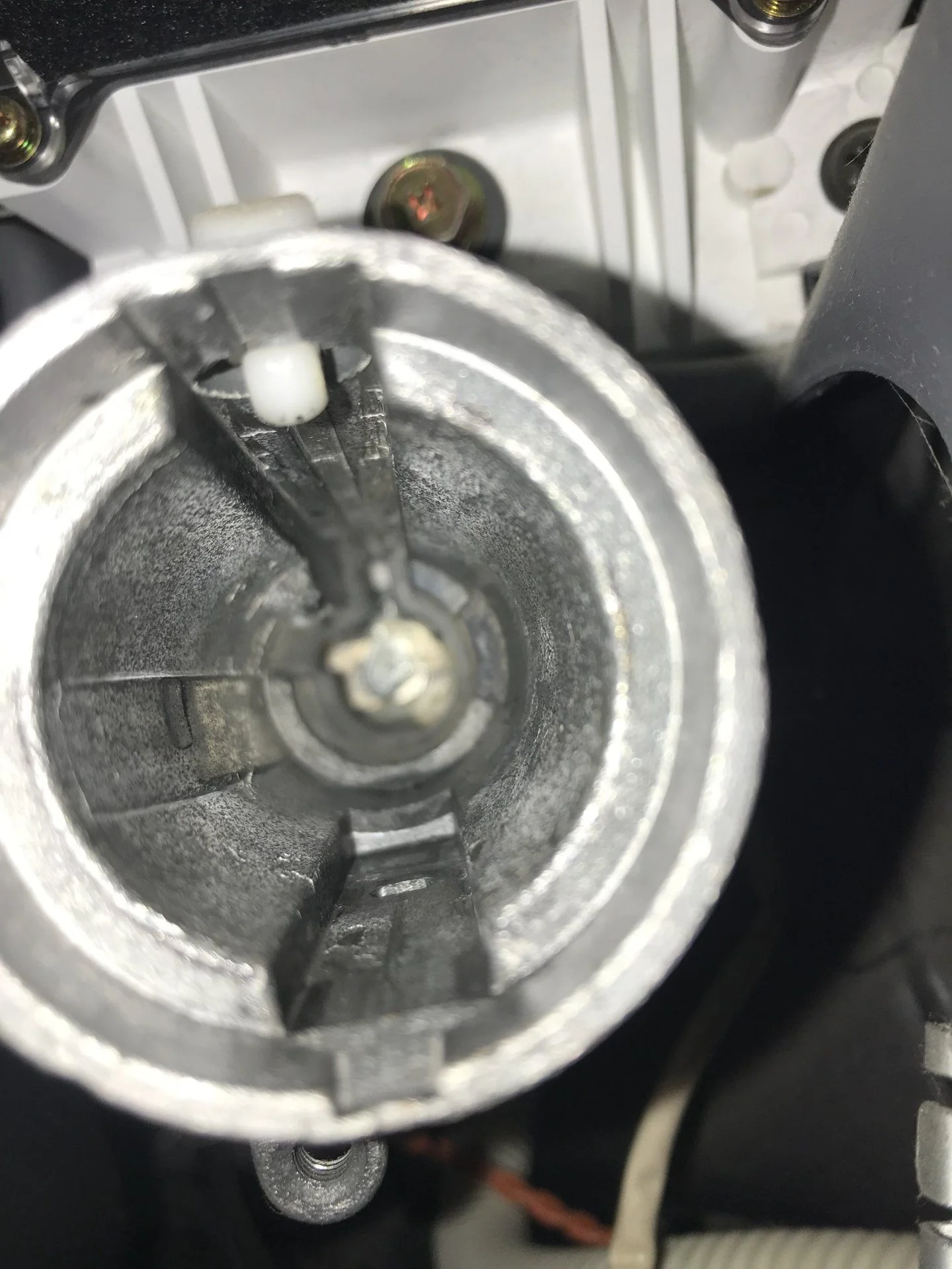

Anyone have tips pulling that broken piece? I am having the hardest time trying to get it to budge. I’ve got a hook/pick set but cannot get even close.
I did manage to get it to spin around but still stuck.

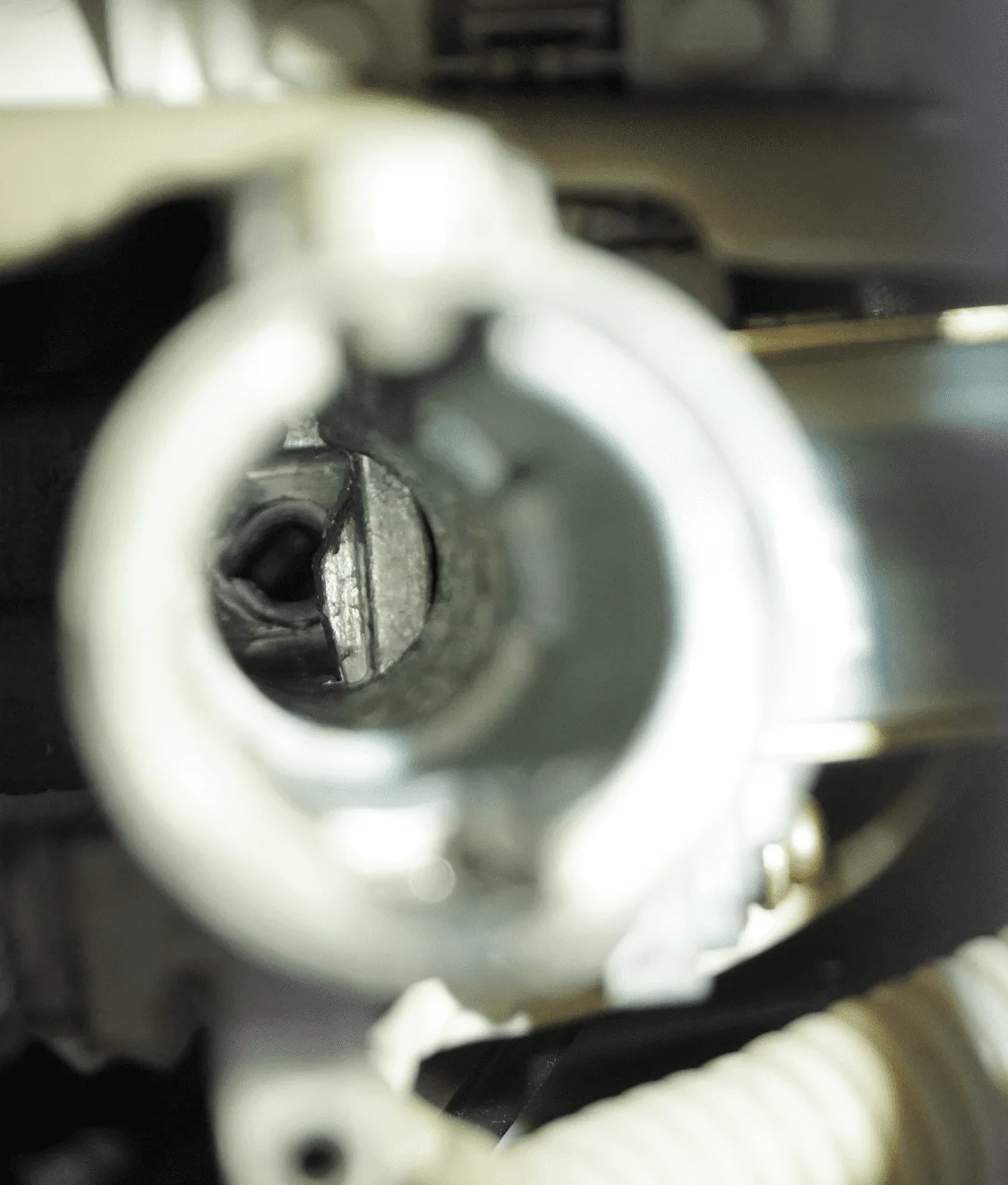

Picture of my rod as broken
1923276
I forgot to take picture of the broken piece's position but the steering lock pin was already pushed out to the right - it was not in the way.
I did not remove the black vent below steering wheel to get to the screws of the white round plastic sensor. I did not find it hard to reach with screw-driver from behind.
I first tried to back off the white round plastic sensor only 1/8th". This was not enough. My broken rod would not rotate counter-clockwise. I could rotate only clockwise 90 degrees (which also released the steering lock pin making it in the way). Versus the YT video, the 12" forceps have rounded tip and they pushed lock ping out of the way while grabbing rod. When I rotated rod back counter clockwise to found position - this also moved the steering lock ping back out. Shrug.
Even 3/16" wasn't enough.
I then carefully backed off the sensor by 1/4" inch. Only then could it rotate broken piece counter-clockwise 90 degrees and came out easily with the forceps.

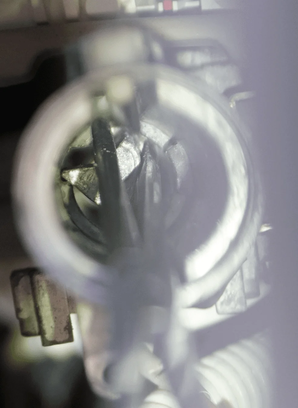

1923293
The steering lock pin was released again while removing the broken piece.

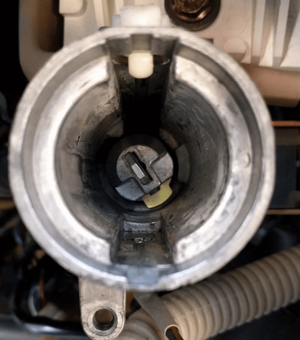

1923294
I put the new rod in as described (12 oclock). I do not believe I was able to turn it counter clockwise to seat the slot of the rod end as described. This may have been a mistake. I then turned it clockwise and it felt solid - turned to 3-5 oclock'ish and settled on 4 oclock as prescribed.

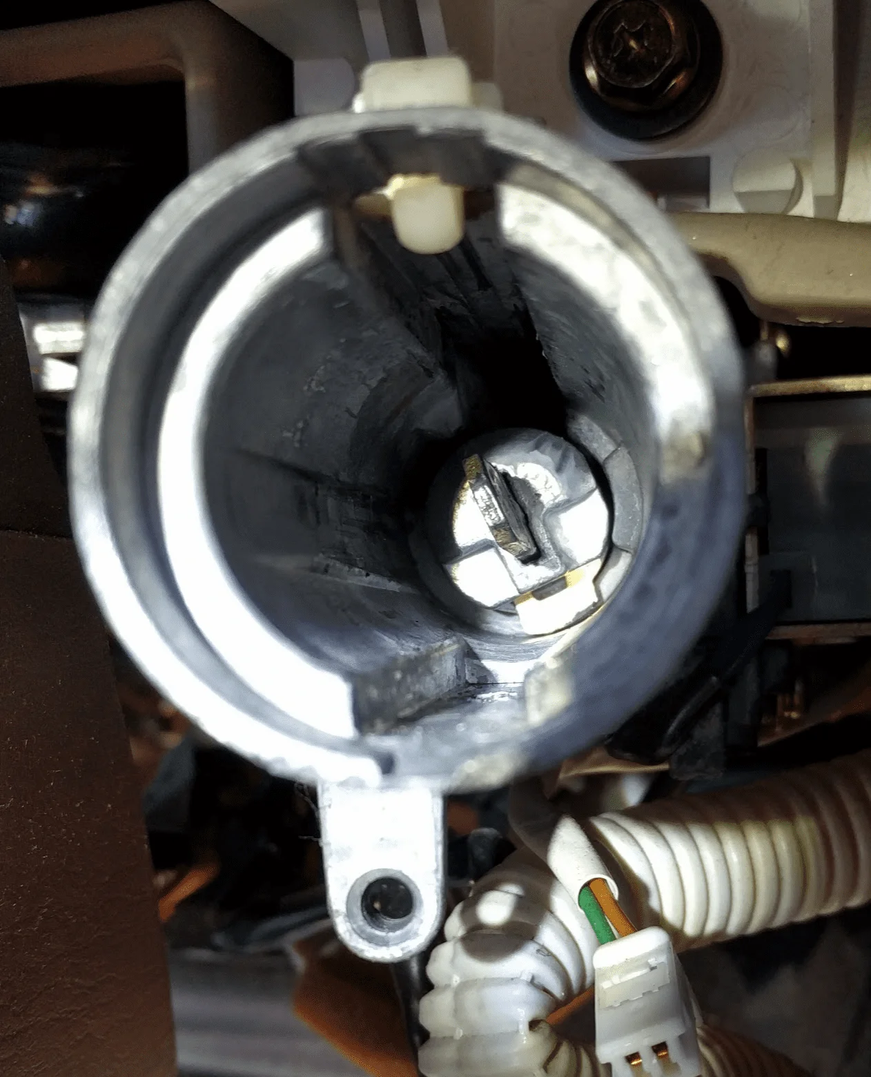

1923295
I found that tightening the screws was harder than I expected. I believe if you feel you may not have the rod slot seated correctly. At a point near fully tightened the sensor screws I heard a snap sound and a round white tab popped off the back of the sensor - about the size of paper hole punch-out. Ugh.
I think I had goofed and noticed that the brass tab was now at 3 to 3:30. I tested the play of the rod - it was not moveable. I decided to loosen the sensor again and once I had backed it off about 1/8th", with my finger on the rod, I felt/heard a click. Clearly the rod had now seated itself correctly in the sensor. I turned the rod back to 4 o'clock and tightened the sensor screws (which were also easier to tighten).
The rest of the procedure worked fine. Once I had the black/clear ring screwed in and plugged in I jump started and steering turned freely when ON.

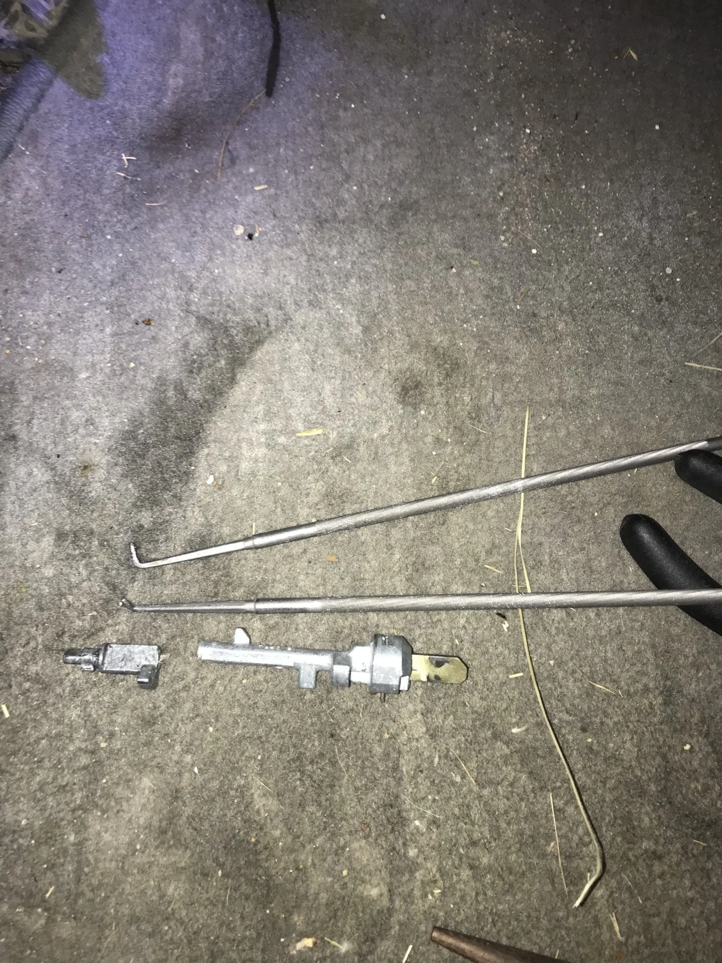

Im working on replacing the camrod in my 2000Lc ignition right now. I was able to remove the broken piece by making picks out of two long files. They are chainsaw files and i put them in a vice to bend the ends
