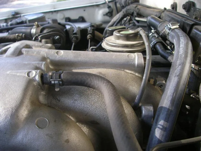

RE: 2/93 '80, non california emissions, no temp sensor in the EGR valve.

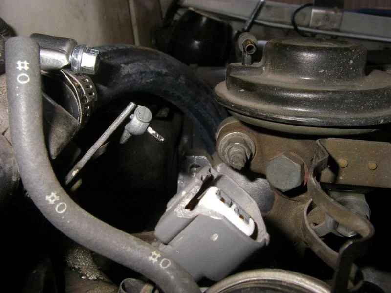

anyone have this and is there a lot of difference from one with the sensor? I'd like to trick the CPU using the 1K OHM resistor, but does my truck look for the signal or what?
partly melted plug is the jumper that Mr. T put there from the factory, and the bolt/plug that fills the port where the sensor ought to be is just that. I have to assume that the EGR system is functional or the plug would not be melted, but can I presume that without a watchdog on the EGR valve/temp the CPU does not care if it sees the right temp, and it will not throw a code or CEL?
I need to OHM the plug now that I think about it, could it be a factory fooler????:hillbilly::hillbilly:
nope- 0.2 ohm :confused:
Bigger picture of the 2nd one please.
That looks suspiciously like where the EGR Modulator is supposed to go.
If so, that's the EGR Valve right behind that empty bracket. On the exact opposite side of that (walk around to the other side of the engine bay) is the EGR Temp probe.
you're right Gabe- the modulator lives in that bracket, I popped out of the way to take the picture. the plug/bolt visible behind the bracket is the only opening for any kind of temp probe, nothing on the drivers side. (USDS)
I have not disabled the EGR yet, but thinking about doing it and seeing if I get a CEL this weekend; I am headed to the coast so I figure it will come up if it is capable. My guess is that the ECU does not care what the EGR temp is, but may throw a code for something else if disabled?
in the first picture the melty plug was installed in the pigtail from the second picture, it is a straight jumper (0.2 ohm)

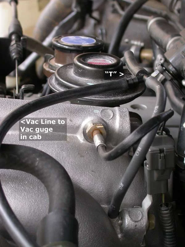

Finally found a pic.
attachment.php
Right smack dab in the middle, to the right of the "Vac line to vac guge [sic] in cab", and below the "T".
Easy to miss.
aww hell, I thought it was in the EGR body itself. Still not sure about if the ECU looks for a signal, I assume not with a factory jumper in there that is not a fooler, I'll see about mod'ing the plug with resistors if I throw the CEL this weekend.
any thought as to what I am looking at in that second picture? (the plug) can you look at yours and compare when you have a shady minute?

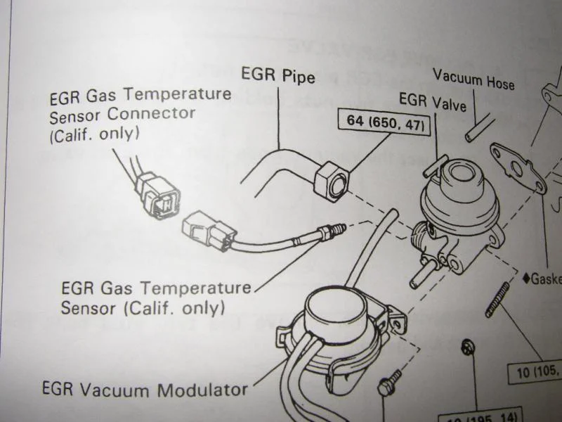

thanks for the picture, although from the FSM it appears the probe is in the EGR- I need to look further:hillbilly:
The picture is looking from the DS side towards the PS side. You can see the intake on the left, and the EGR Valve is in front, the Modulator (which you removed) is behind it.
The FSM is not entirely clear on this.

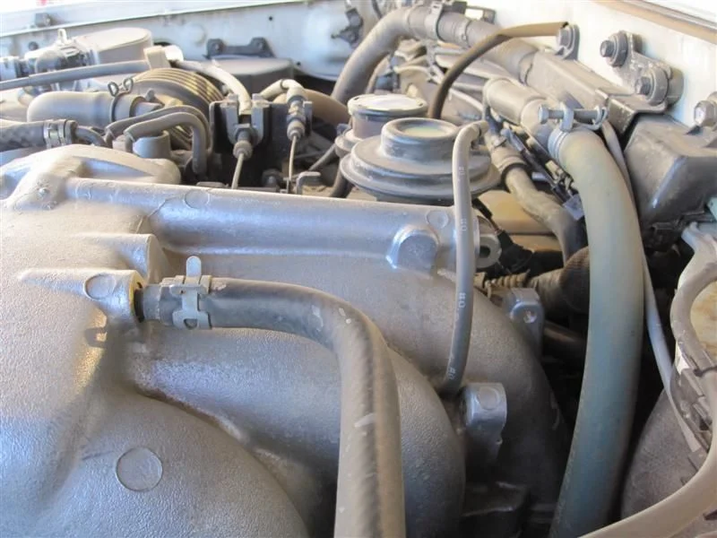

The funny apart about T's pic compared to Ebag's is 93 vs 97. I have a 94 and have the exact mssing part but looks like the form on the intake for fitting.... (sorry for the lack of techy terms).

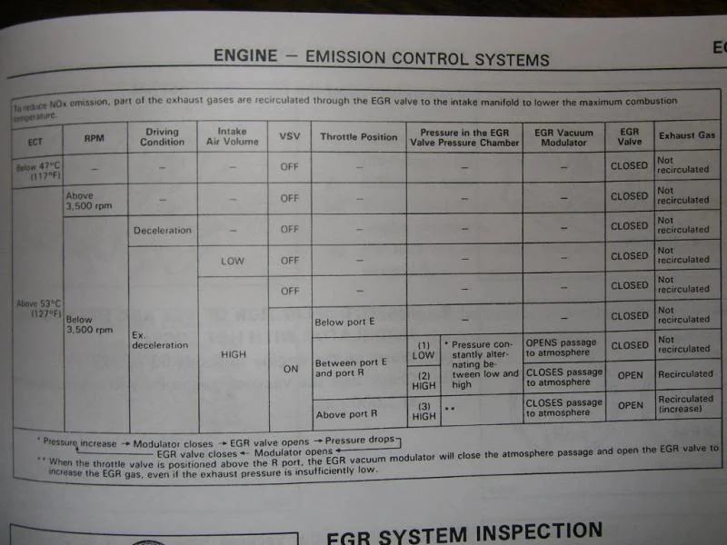

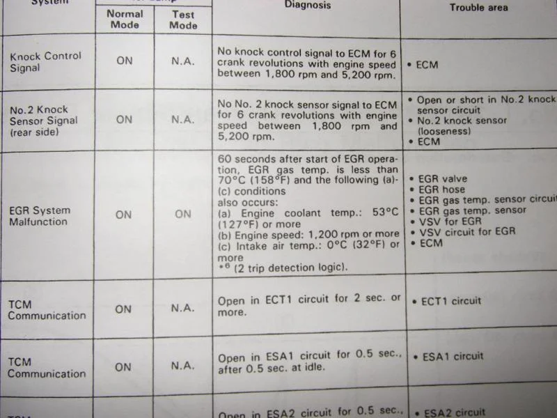

here's why I thought the temp probe was in the EGR valve itself,
and the code 71 for EGR trouble. any help or more 'MUD?
if it has to have 60 seconds of EGR operation under 158*F and I have no temp probe, I have to assume there is no code 71 logic in this ECU. :hhmm: I'll have to make two trips to find out I guess...

tblume: I realize now that the mystery bolt I was wondering about in your second pic (in the EGR valve) is where they blocked off the EGR temp sensor.
Have you thrown an EGR code since that has been unplugged? I wonder if the ECU doesn't get info from that sensor if it will just ignore it. I think I'm going to go unplug mine, and see what happens over the next few days.
That would make a certain amount of sense as not all trucks had the EGR system....one less ECU variant to produce.
no code in the year plus I have owned it, and it was never plugged into anything; there is just that factory jumper plug completing the temp circuit. also no mention of testing the temp probe in my FSM that I can find...

If I read the FSM right I need 60 seconds of EGR temps lower than 158*F (who's measuring though) at intake temps above 32*F and rpm above 1200. Check on both the last items, but how would the thing know without a temp factor? Tyler had the #71 CEL on without a temp probe, so there must be something else like the o2 sensor like gnob said?
