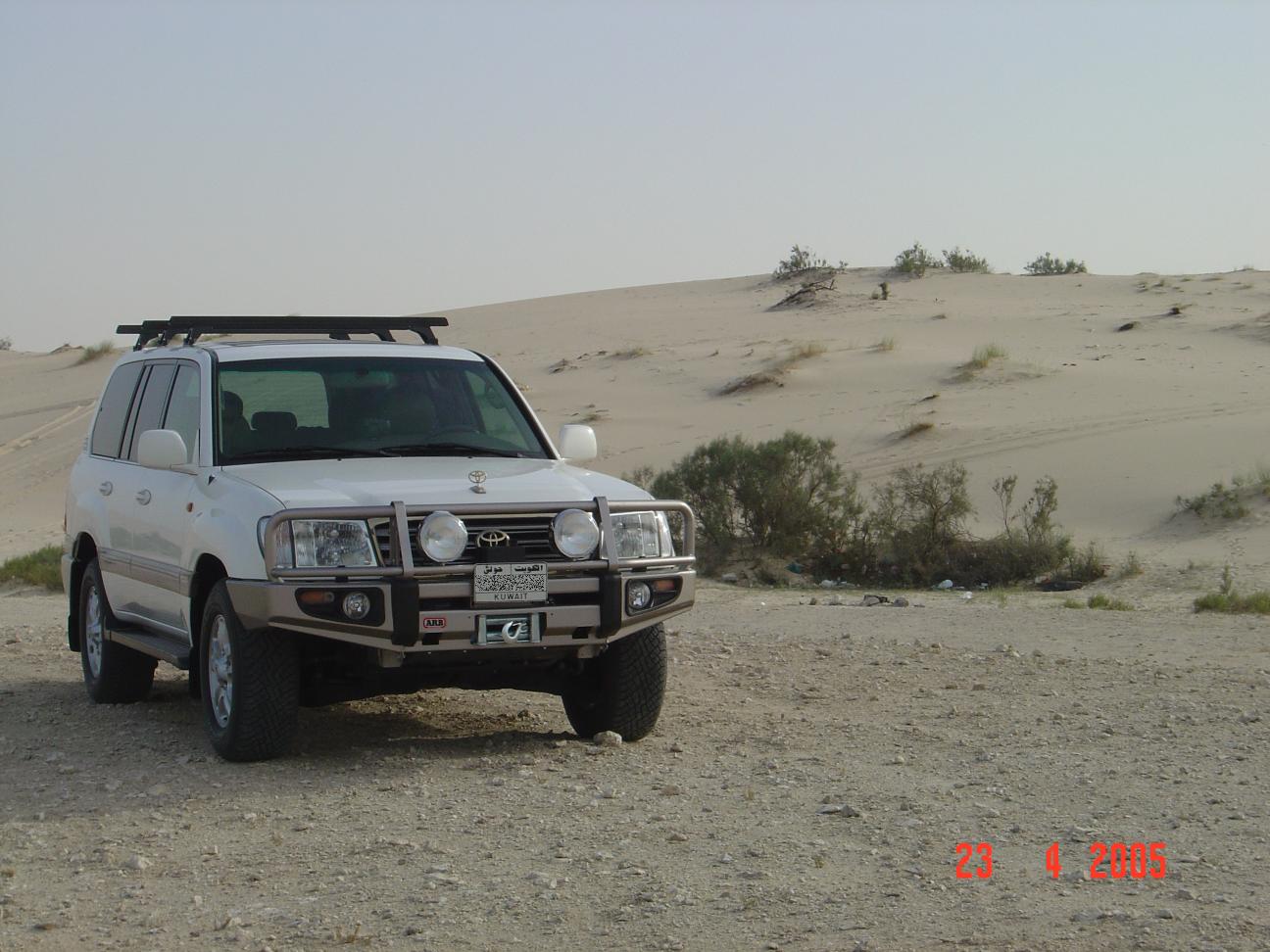

it's finally done!
thanks for all your input the front is finally done.. :bounce:
ARB bull bar
OE T-Bars
Warn 9.5XP winch
After installing the OE T-bars the 100 handles much better on sharp turns.. though it's not as comfortable on bumpy roads now..
Tested the winch also yesterday when a Chevy truck got stuck in the soft sand.. a huge improvement over the OEM winch.. got that Chevy out in seconds :)
after I installed the bumper, t-bars and winch.. the dealer checked the AHC with their computer and found that it was off by only 6mm which was fixed.. the lowest setting now seems messed up cause it takes a long time to get the LC down due to the thicker t-bars.. and once I set it back to the normal position the front kind off jumps into position rather than slowly lift up..
I do really appreciate all the help I got from all of you guys.. thanks again :)
