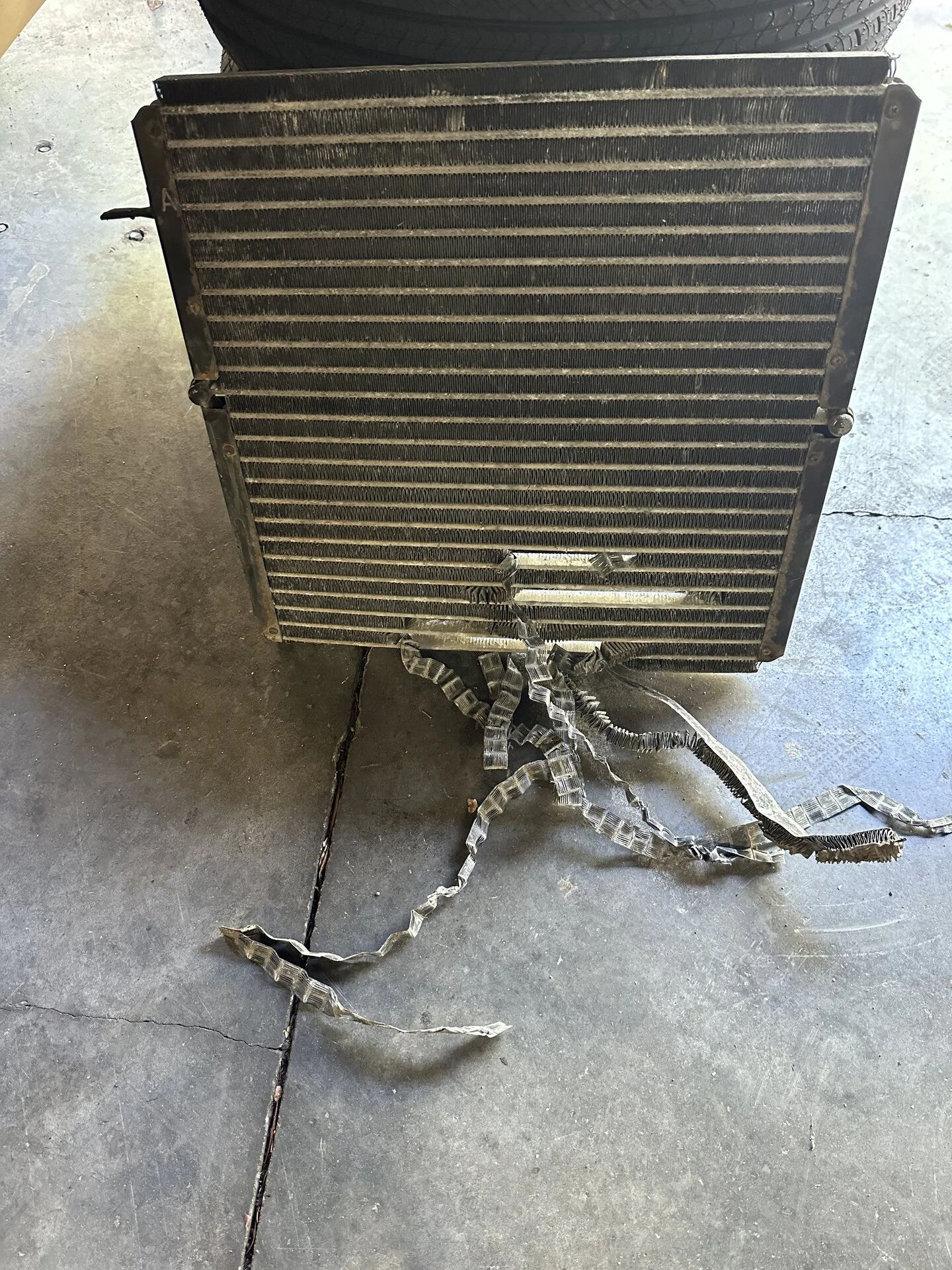

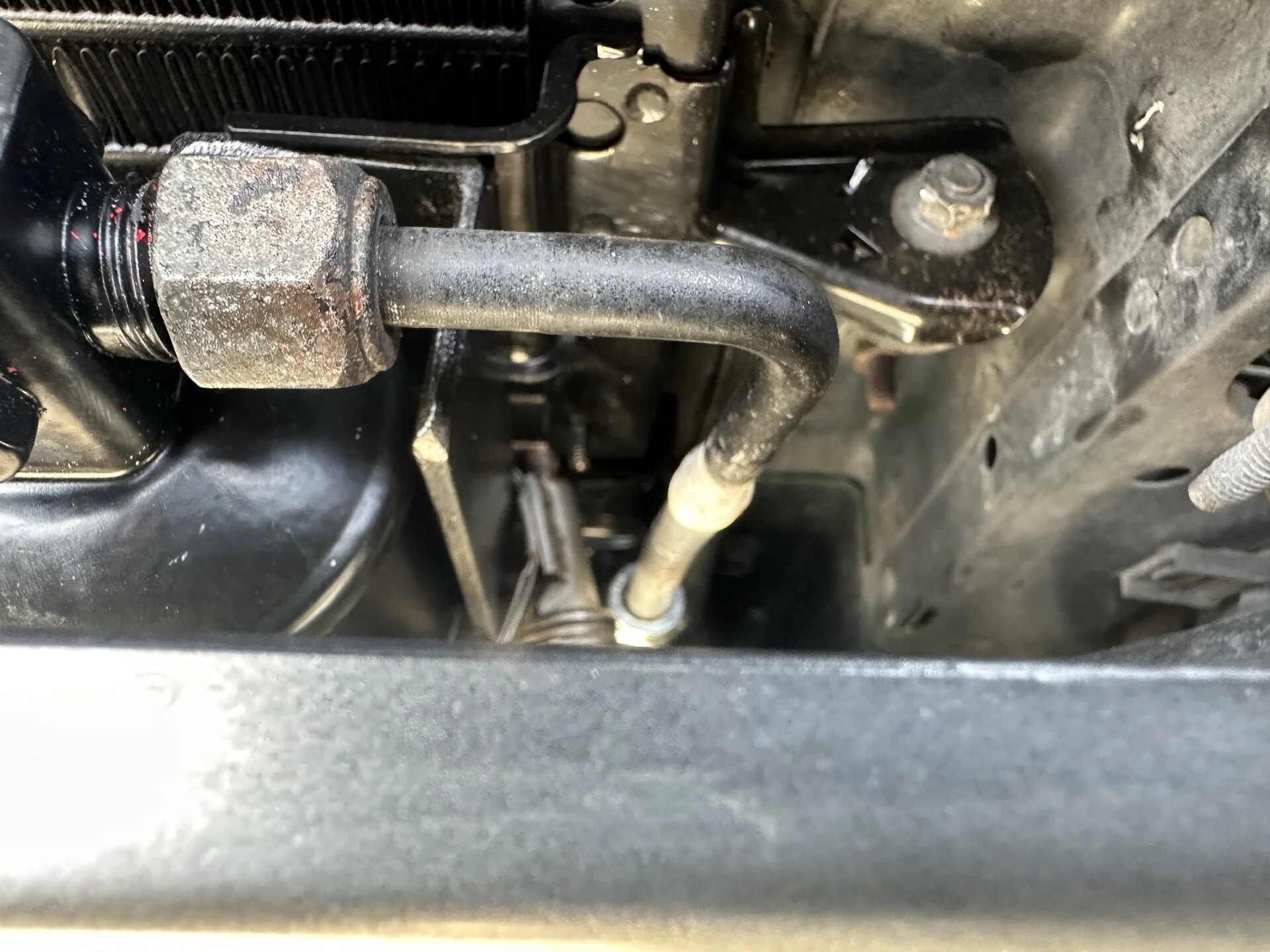

Finally found the ac condenser in stock in AUS through Cruiser Brothers in California. The original part no. for the 77's was unavailable anywhere (Japan, UAE, AUS). I ordered this recommended replacement. The drier was wrong. Also, the flared fitting on the tube connecting the condenser to the drier was too large. I had a radiator shop cut it and weld on the right one. Alas, ice cold ac for me here in Florida. The original condenser was disintegrating.
