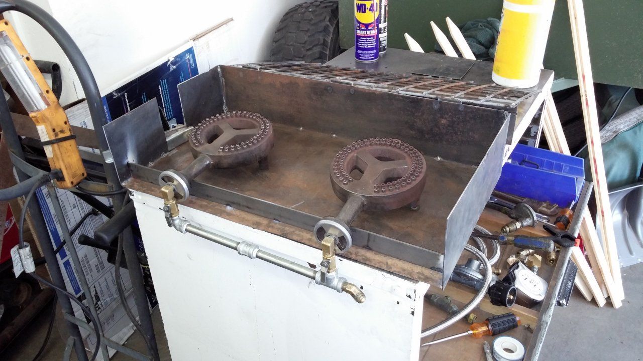

On the kitchen is the 10" deep SS sink and the stove top. I built the stove using burners from an old Camp Chef stove.
All painted up. It just drops right on to some tabs that I welded between the rails. Unfortunately this is not a lightweight solution. I would rather buy a Partner Steel stove that should be just about the right size. This stove works decent in the wind. Dutch ovens fit just right.
