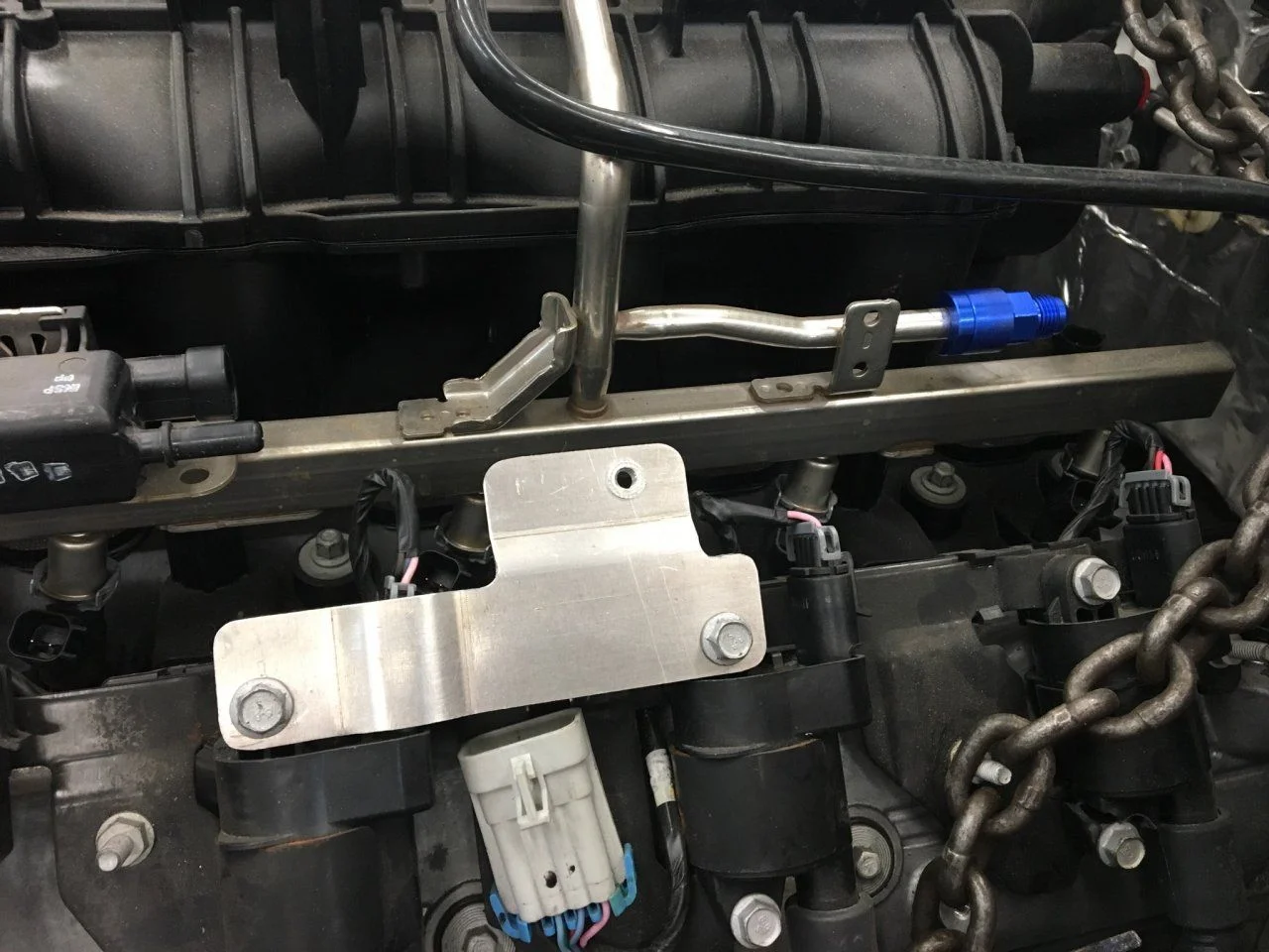

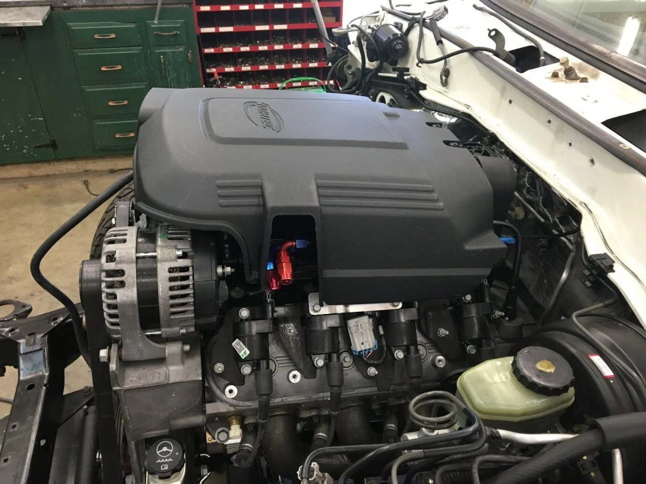

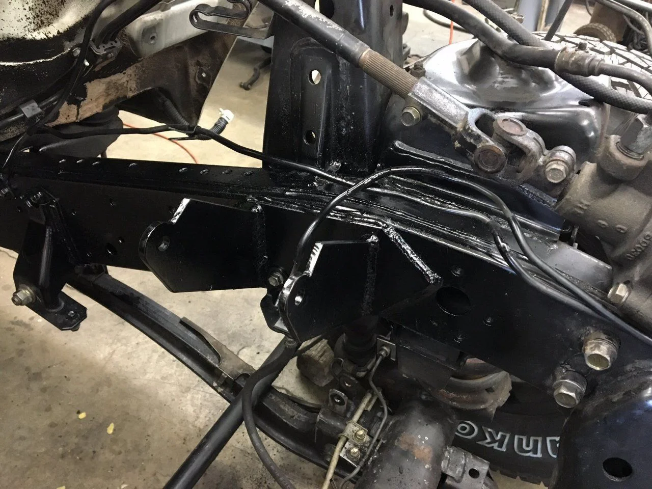

Now to the juicy part, engine mounts are done, firewall is massaged for clearance (see pics) and today I got most of instrument cluster swapped. (I am using th 2013 Silverado cluster) it's almost made for it.

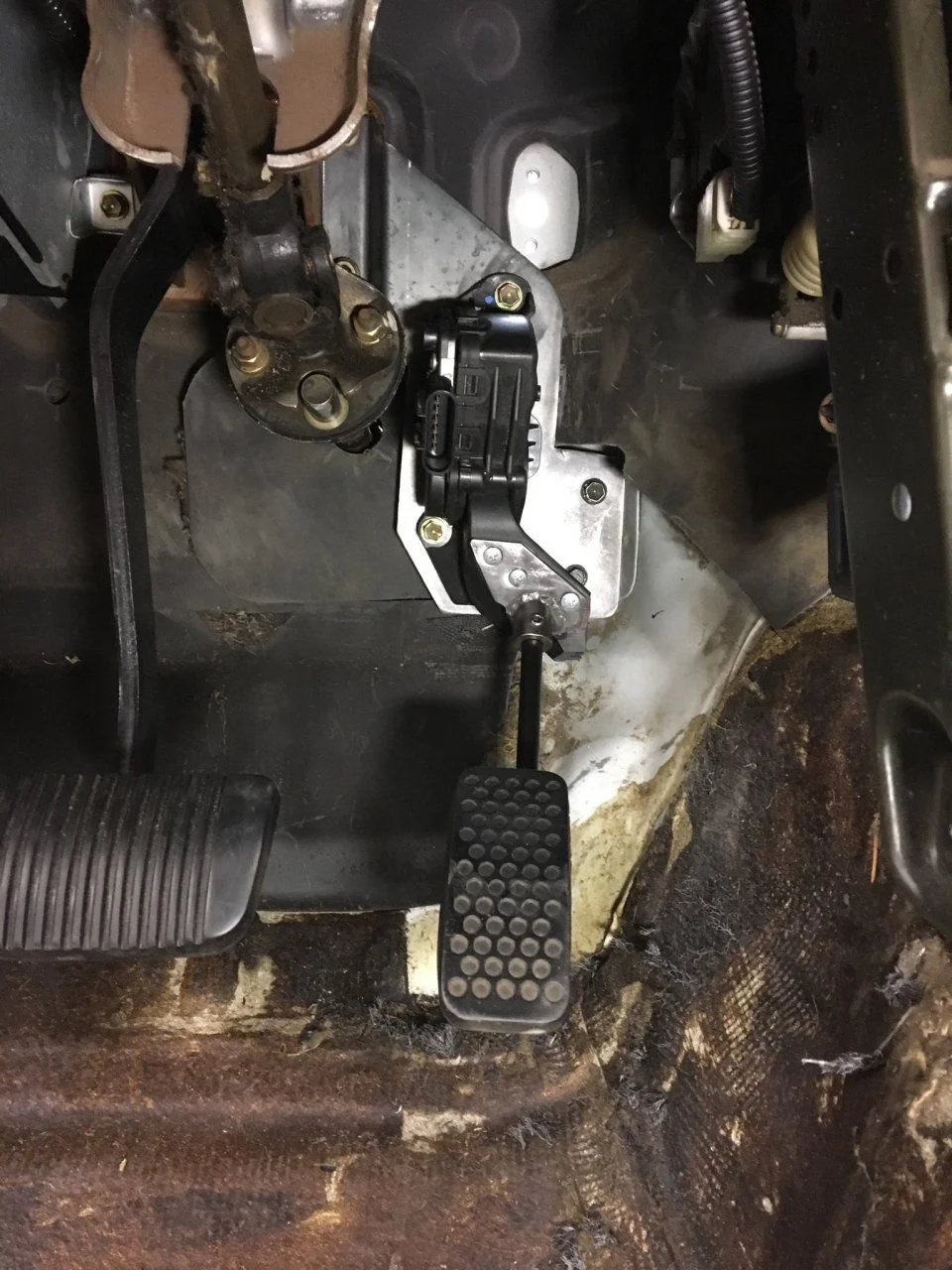

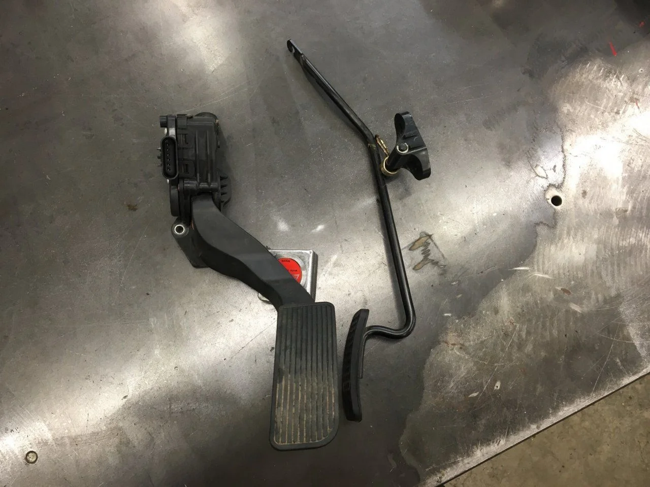

Mounted the fuel filter/regulator. Mounted the throttle pedal assembly complete with the stock 80 foot pad.
