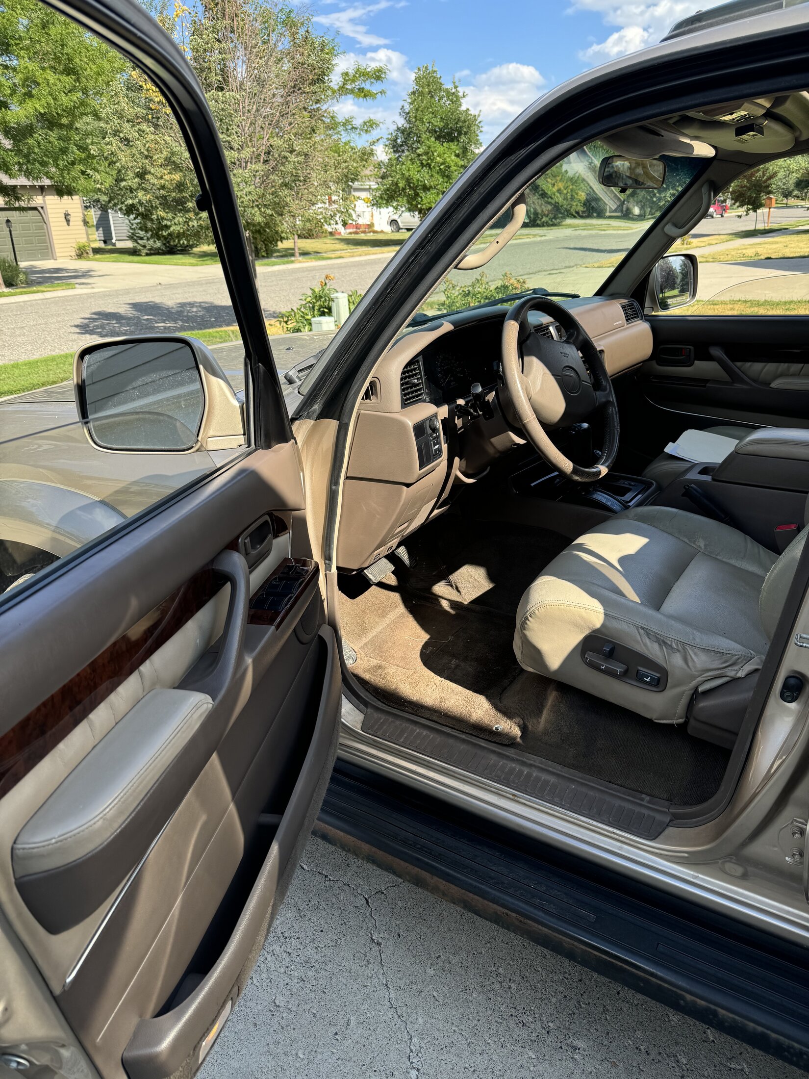

Open driver door and it looks great, again for the age and mileage, amazing. Obv driver seat lower is recovered with vinyl or something.
Insert key, fires right up, start pressing buttons and it all works. Windows, sunroof, antenna, climate, stereo, front wipers(rear no function), lights etc. it’s clean as a whistle in there.

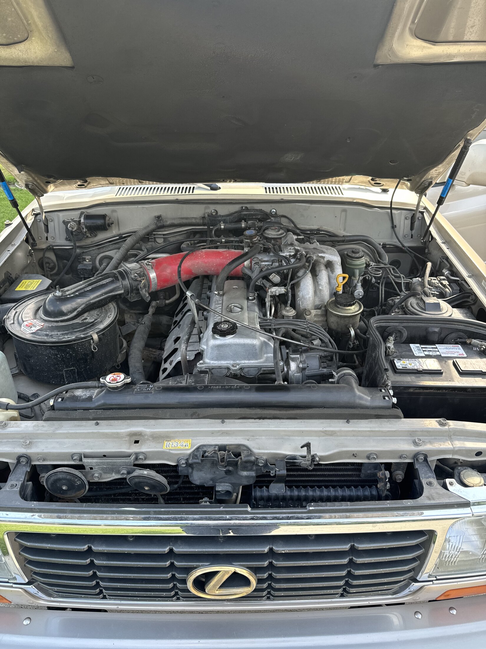

Newish radiator (scary?), fluids look good, it’s purring along. Bone stock aside from the silicone tube. Not super dirty under there, oil present but nothing smells burning.

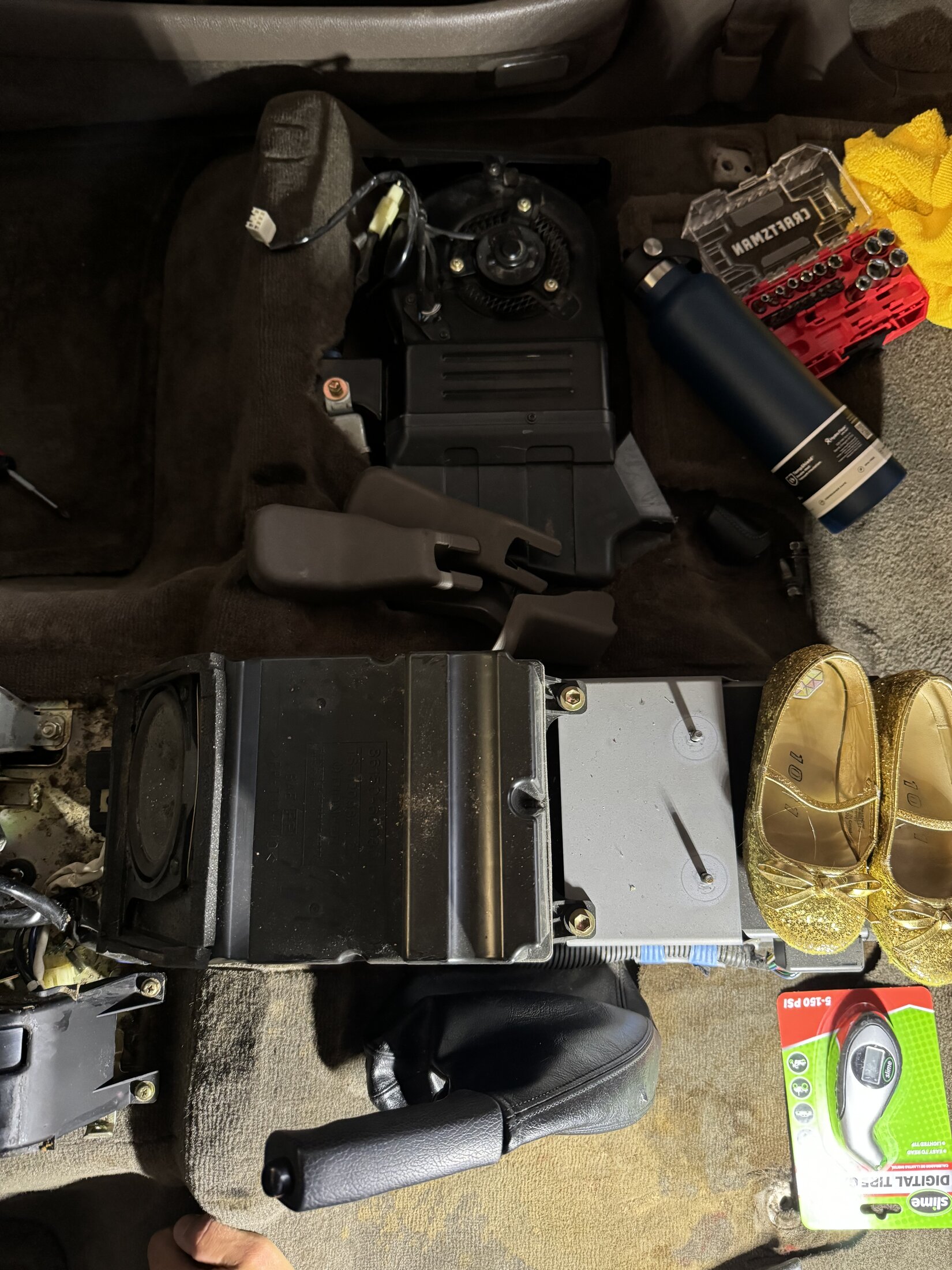

Get the seats and console out and start cleaning. Again very pleasantly surprised at how clean- PO(s?) spilled plenty of coffee but otherwise squeaky. No dust/dirt under the carpet. Where’s the dog hair?
Parking brake lever looks brand new. (More on that later)

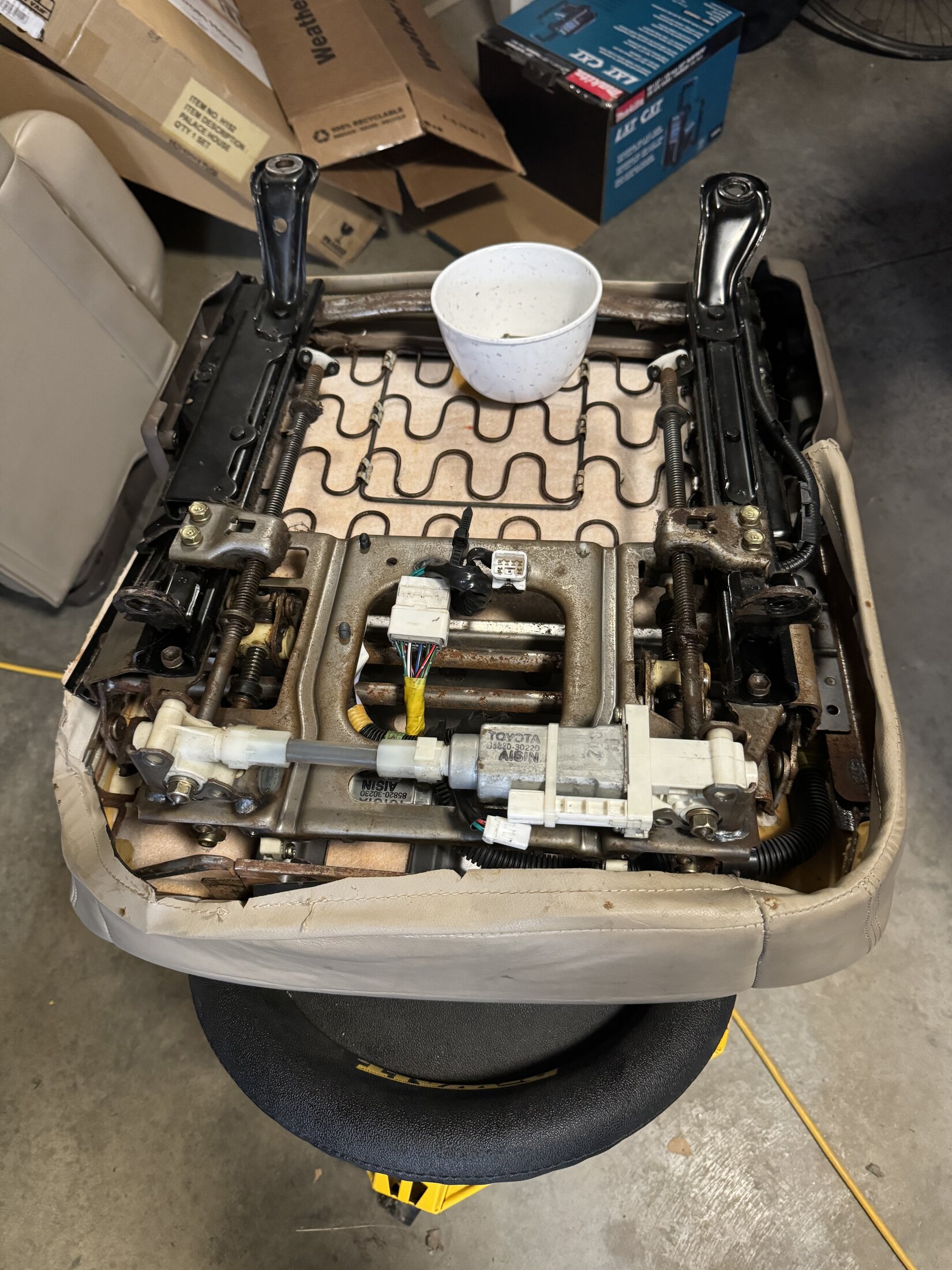

Passenger seat gear probs. Got the gamiviti replacement, replaced, no dice, I must have screwed something up so will have to take another look. Driver seat works great so whatever.

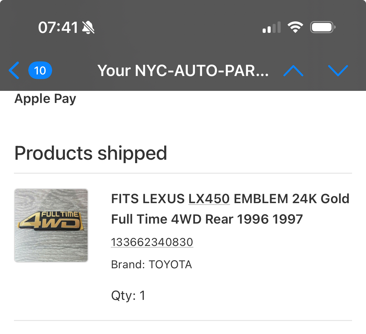

Originated in Iowa, Gold package installed shortly after initial purchase in Jan 1997. Boom. This was missing but not for much longer
Thanks to Mud I realize not all ‘97 450s came with this badge but how can I resist?
Passenger seat gear probs. Got the gamiviti replacement, replaced, no dice, I must have screwed something up so will have to take another look. Driver seat works great so whatever. View attachment 3719316

Did the white plastic circle cap that threads in fall out again? Seat won't work without it. Highly recommend the solvefunction metal bracket that keeps it sandwiched in.
I believe the full time 4WD badges were only on the 96s. Never seen a 97 with them.
@TXMeatball copy that, I did put a little screw in the cap per gamiviti video but I’ll double check- maybe i drove it in too far or my threaded rods aren’t perfectly lined up.

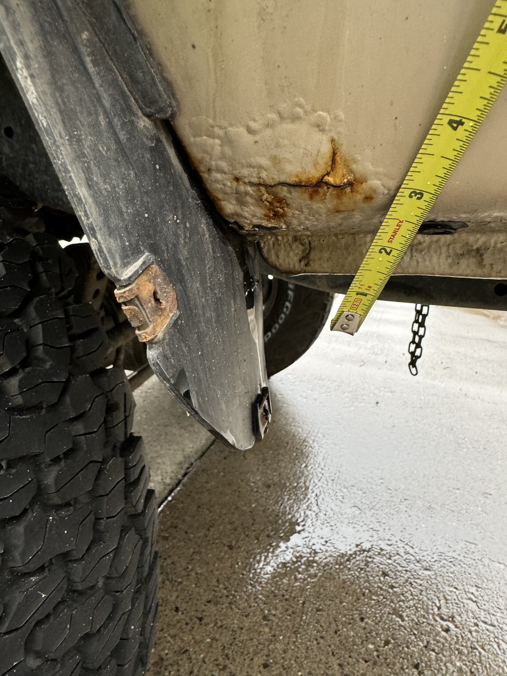

Couple good spots of cancer in the passenger rear wheel well, no idea what to do here, problem for future stupid

On the seat gears, make sure both sides of the track are even. If they get very far out of sync, then the whole thing tends to bind up.

Copy that on the seat gears- I bought a few extra cogs from gamiviti so will try again soon.

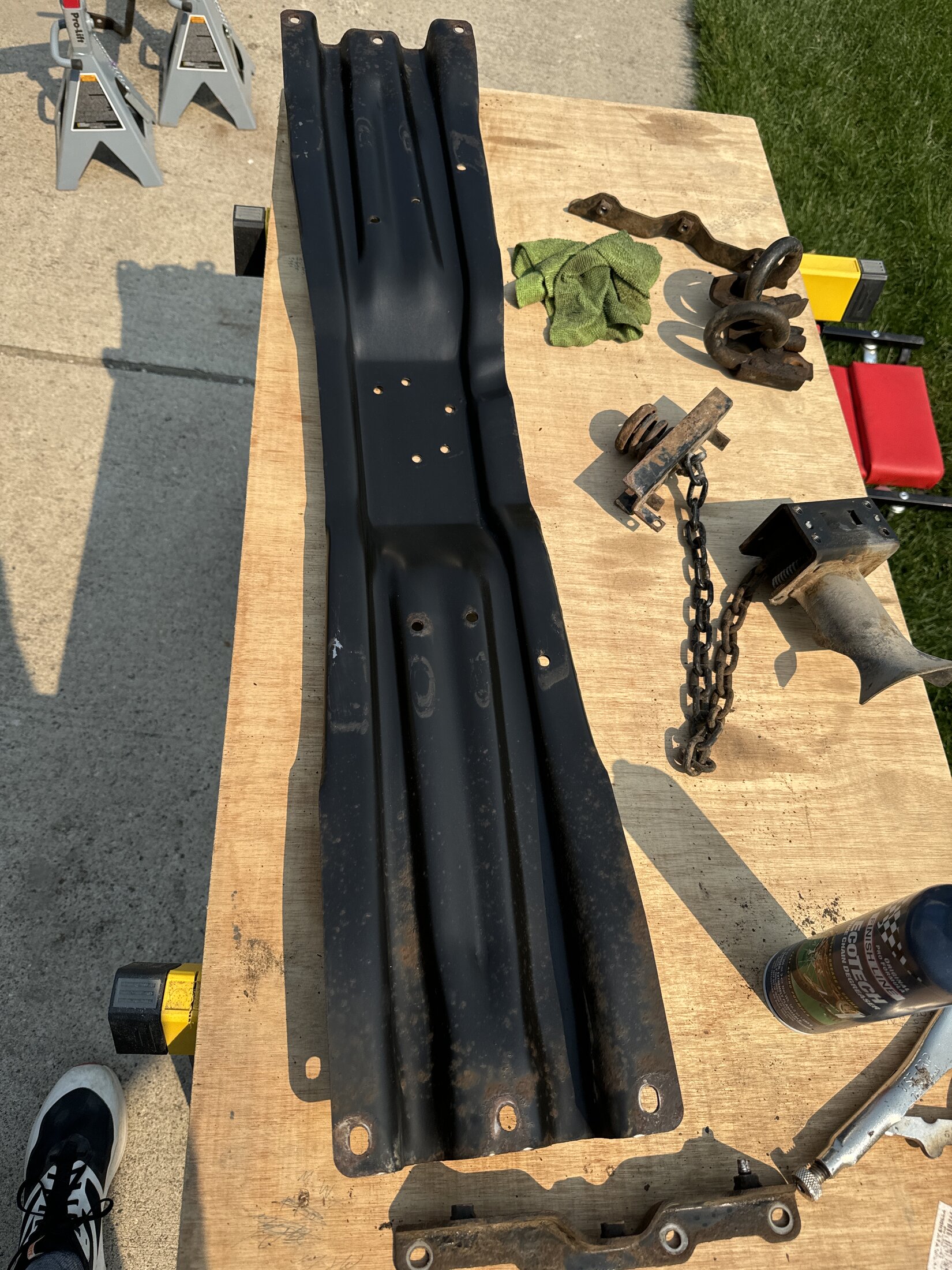

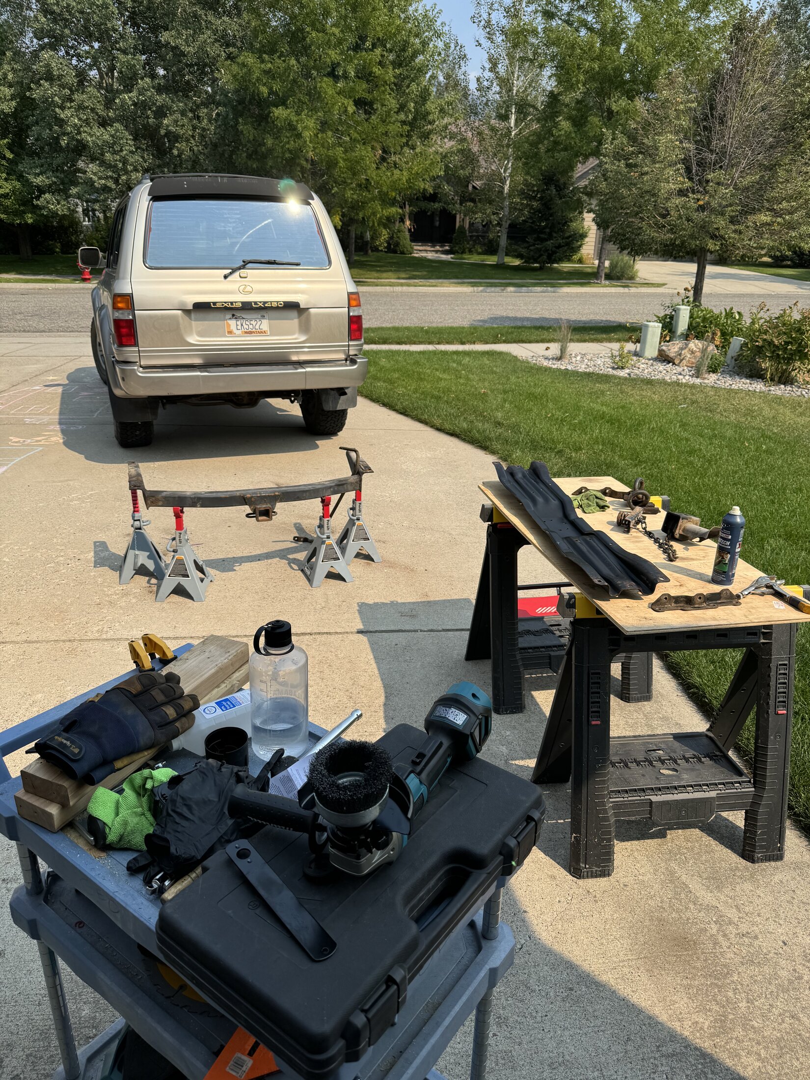

Today I managed to remove the spare tire cross member and receiver hitch.
The plan is to install 3” spacer lift to tuck the spare up there a little tighter. Also rust mitigation. Replacing all hardware.
Cross member not too dang rusty. All bolts were pretty seized and I’ll have to drill one out that broke.

Ok got the spare crossmember wire wheeled, primed and painted yesterday afternoon along with spare tire lift hardware mounted w/ blue loctite on bolts
Also got the receiver hitch off, wire wheeled, corroseal yesterday and rust reformer coats today. Redundant but I am kind of testing this coating combo. Does not need to look good just rust proof.

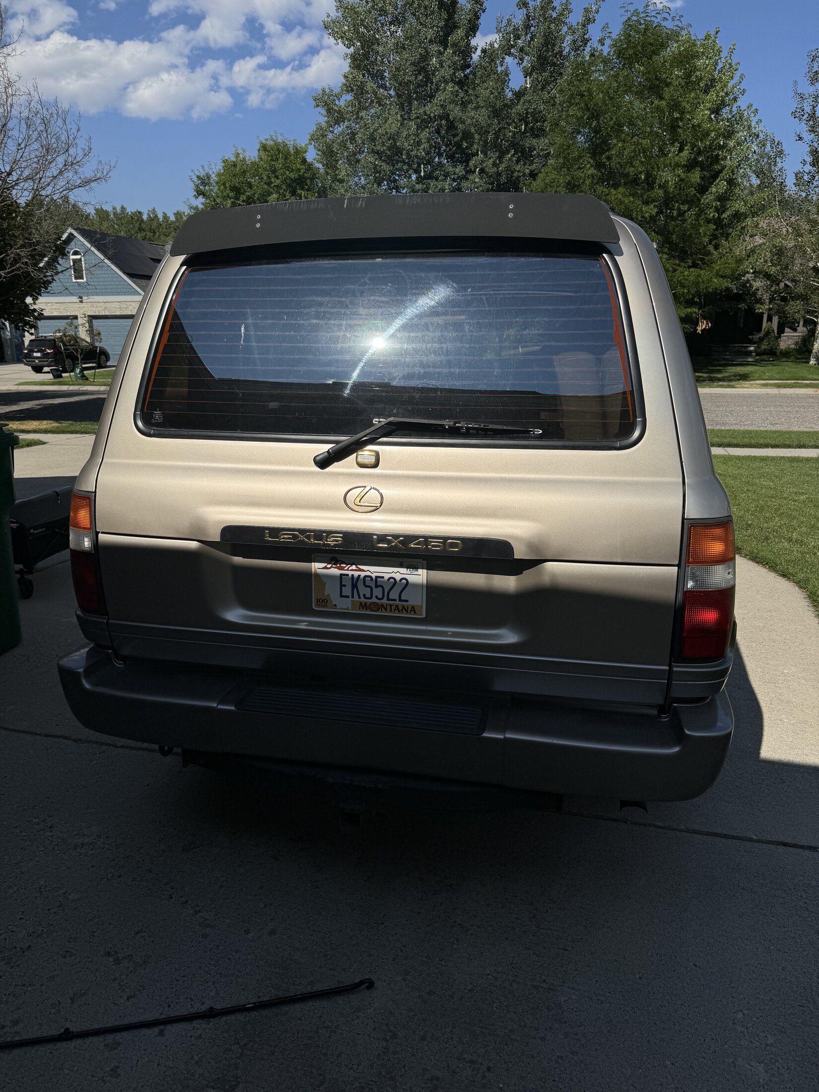

Today in project creep stupid I have removed the rear bumper cover
I think it could be way worse but there is rust to be treated.
Replacing all bolts with 10.9 from the hardware store. Chasing threads and anti-seize.
Immediate plan is get the rear bumper and spare tire area sorted, put back together and enjoy driving until winter when it’s in the garage and I can slowly work my way forward underneath.

Recent rain really highlighted these rust spots, so m going to get with a couple body shops to see what can be done.
