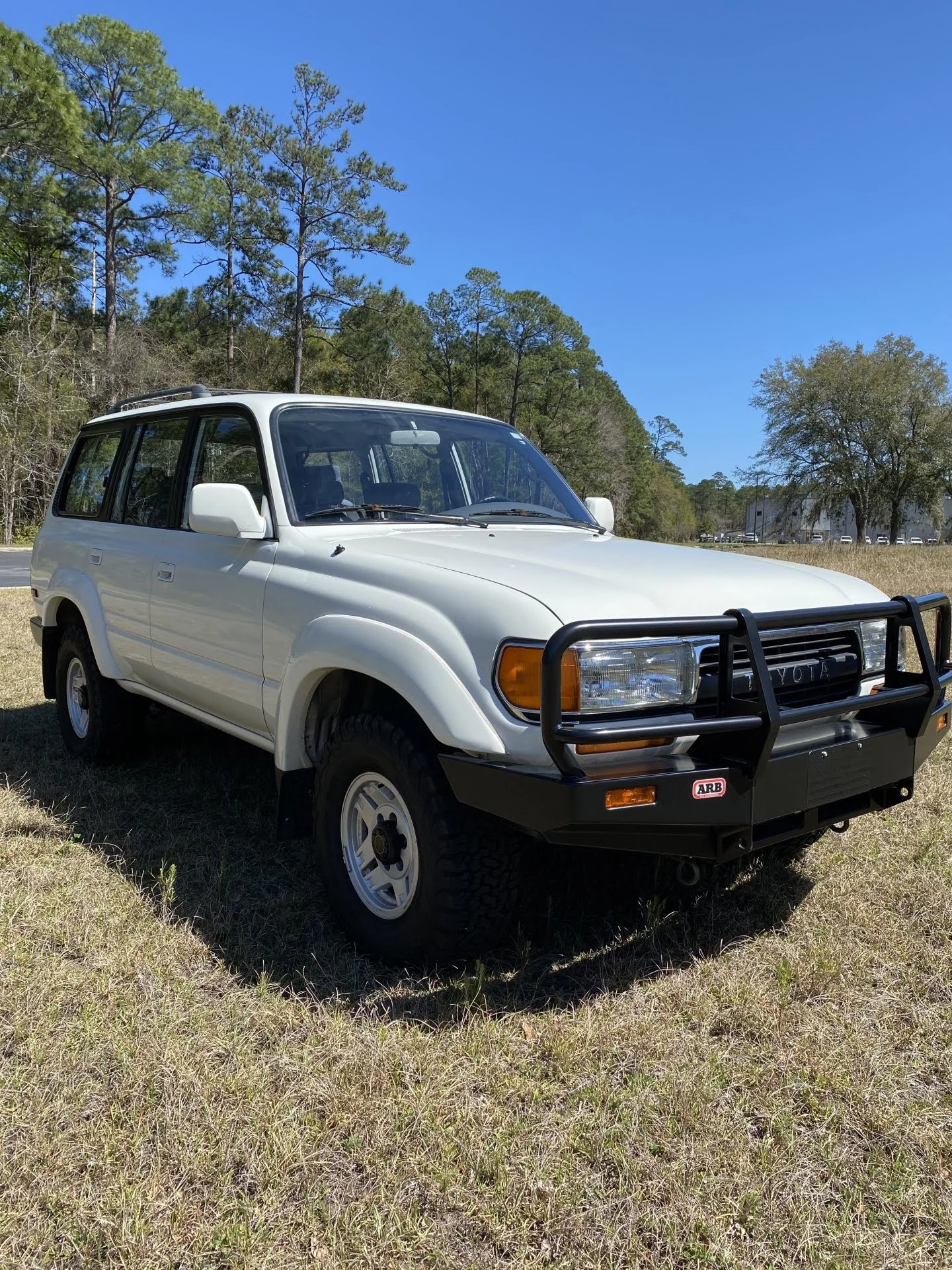

First time posting something like this, so lmk if I am missing the mark. I don't usually "name" my cars but with 3 girls (9, 7, 5) they wanted to name it, so here she is, snowball the mostly stock, 3FE FJ80 with 161k miles
I bought this truck from @JML403 in late March and it is as advertised. Really clean and pretty stock except the ARB bumper

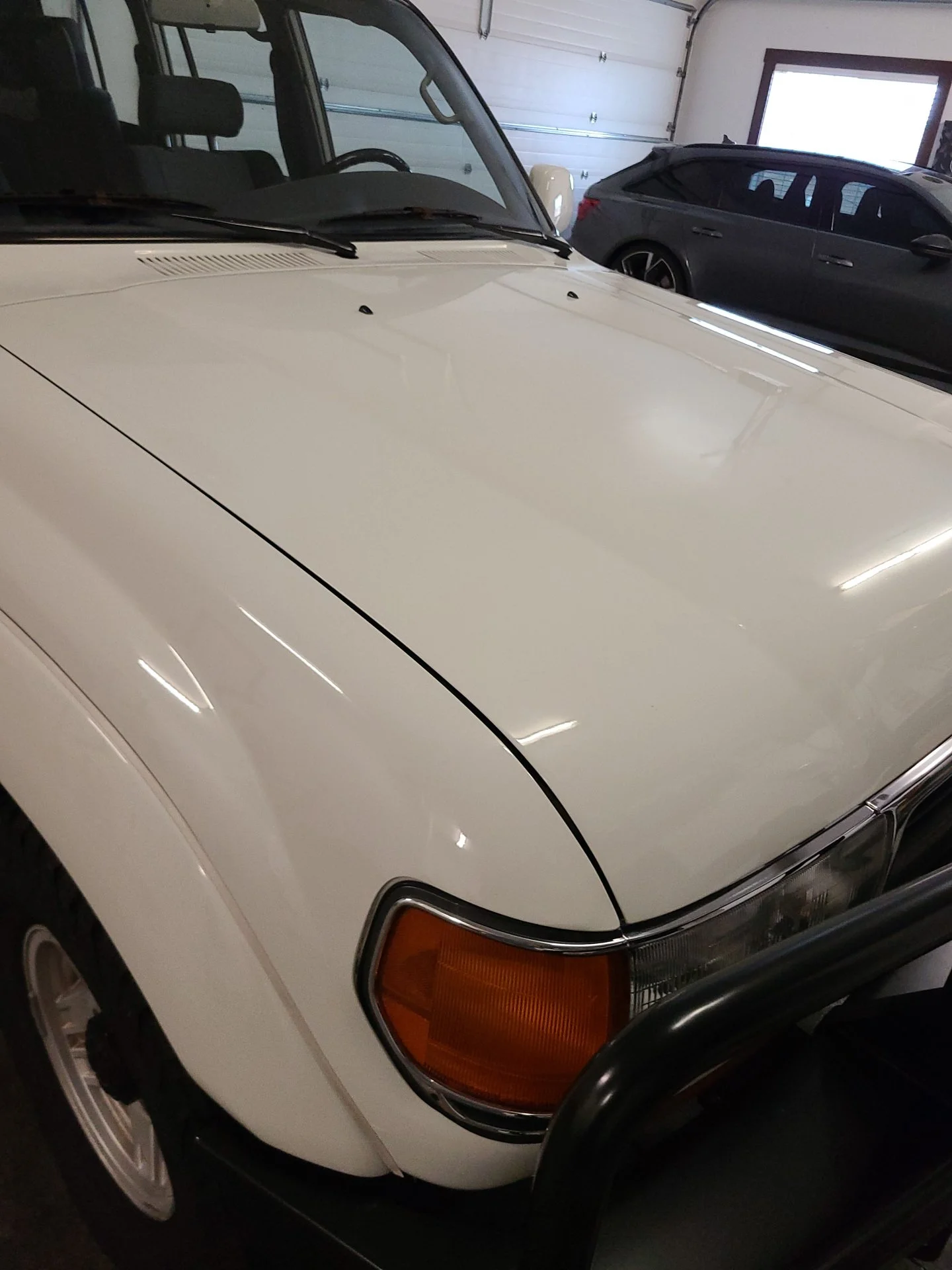

First project is to clean the vehicle, mostly the exterior. Get the paint dialed in and coated. Here's the steps I took:
1. Ironx iron remover. This stuff smells like rotting corpse. Works great!
2. Decon wash
3. Clay bar
4. Jescar correcting compound. Chemical Guys Hex logic pads
5. Carpro Eraser to remove residue
6. Crystal Serum Light ceramic coating
There was a lot of residue that came up with the pads. I think I went through 6 pads and blew each of them out at least once? I wasn't expecting that. You can see in this picture one of the pads I used and the residue...

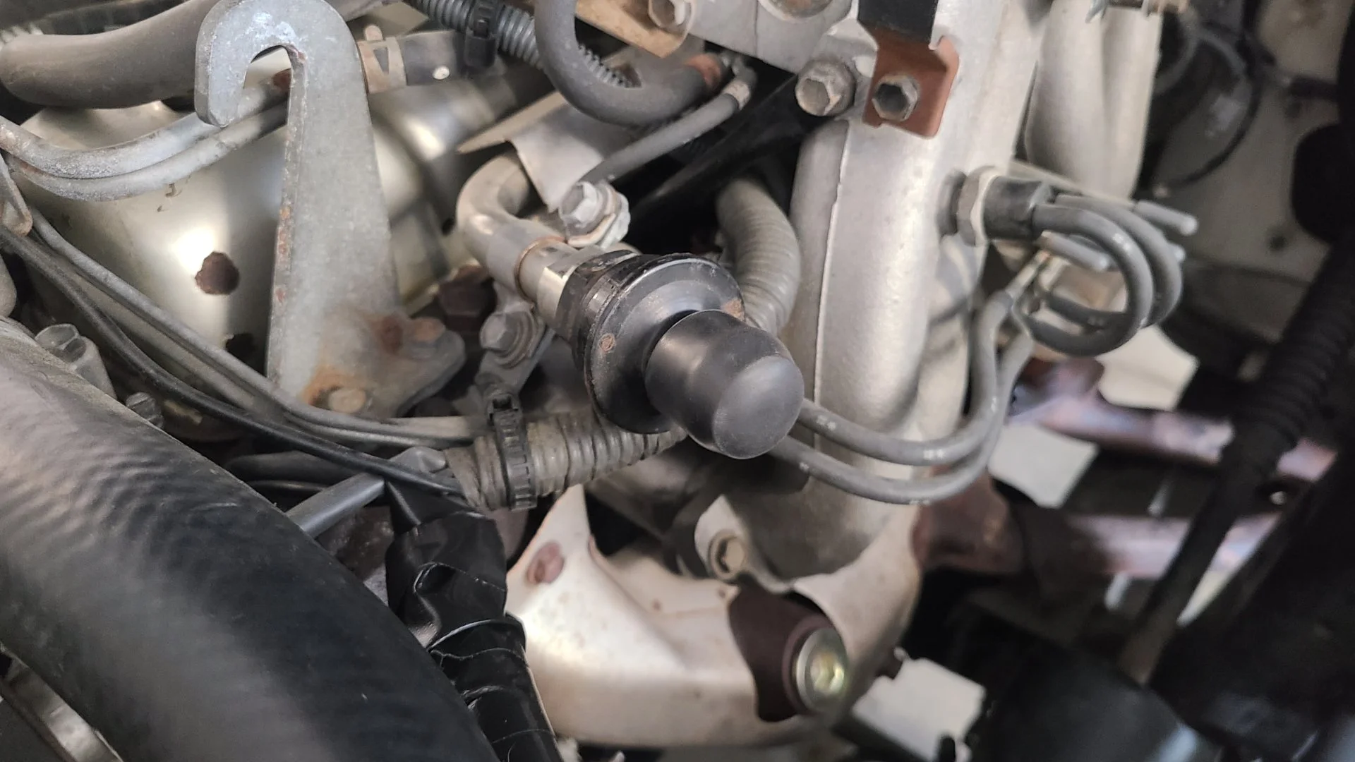

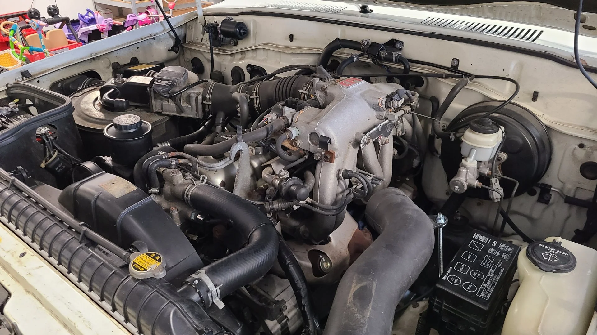

I started on the desmog today. More to come...
I ended up just capping the air rail, instead of removing those air injector things
Pretty clean! I used some 1/4 threaded rod to make a support for the fan housing, as you can see on the driver side wheel well. Waiting for Wits End to send over their “keychain”, aka block off plate. Then I can get rid of my janky cut up license plate 🤣
Saved all the parts!!
