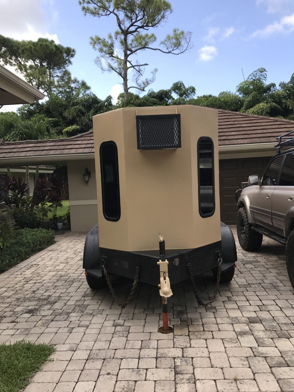

So here is the story; I have owned Landcruisers since I was 18 and have always dreamed of extended trips vagabonding the country, never happened. I absolutely love the 40s and have (3) of them, I also love the 45s and have (3) of them as well but let's face it there are limitations on how far you can travel comfortably, maybe it's just me? So, I have an LX450 with a 4BTQSB/4L80E sitting on 37s that is a dream for road trips, sure it is noisy if your sitting with the hood up checking things out with the engine running before a trip but on the road it's quiet awesome. Well, I took my wife to Overland Expo East last year and slept in the back, not bad but not ideal. There is 6'2" with the seats all the way forward. So I decided to build a trailer, why you ask? I wanted to build a trailer because I prefer being off the ground even as romantic as the rain is on a tent. I also wanted my wife to be able to stand and comfortably change her clothes. I almost forgot, I also figured I could contribute to the camping scene more often if I had air conditioning! And so the build began, first I needed to source a trailer. I have always had all sorts of trailers for all sorts of tasks and I can tell you from my experience that I would much prefer to have a tire failure with a second axle helping the save. I also wanted something small, easy to maneuver and a trailer that was very well balanced. I had considered one of the little tag along trailers with a RTT but again as romantic as the rain is I wanted to have sound insulation and climate control, you know, so that I can better celebrate the activity. I searched and searched and found an Air Force jet generator mounted to a trailer that doubled as the fuel cell. The size seemed right but I was worried about the weight as the military overbuilds everything, the trailer was lighter than I expected upon inspecting the weight cert and I figured that by the time I removed the generator, housing, top of tank and baffles it would slim down quite a bit. I took the plunge and purchased the trailer knowing that I would recoup some of the acquisition with the scrap value of the copper generator and aluminum housing. After taking everything apart and selling the scrap I recovered a little more than half of what I paid and ultimately had $300 in my platform, so far so good. One of the things about the military and the quality of their builds is that they are equally challenging to decom. What I ended up with is a super small trailer that comfortably fits (6) people on folding chairs and should be no issue for my wife and I to sleep in appropriate fashion. Its well insulated and the 5000BTU A/C gets the trailer like an icebox on low. I'm not here to preach on how things should be done but here is an example of what I did, no more and no less. Other than time the cost of this trailer has been insignificant. I am at the point where I am building out the interior so any ideas and/or examples are greatly appreciated.
I can't lie, at the end of day (3) of the inside build I actually took a little rest just as soon as the floor was down, lol.
Nice rig and an inventive reuse.
Do you have pics as sold by the Air Force so the type/nomenclature an be identified for future reference in case someone else wants to use this as a base for a similar build? When the gov't sells one of these, there are often more that come on the market as they are being phased out or replaced across the service.
I have not been able to find anything about this trailer assembly. The trailer is a 1970 but apparently it had not been used any distance as it is excellent condition.

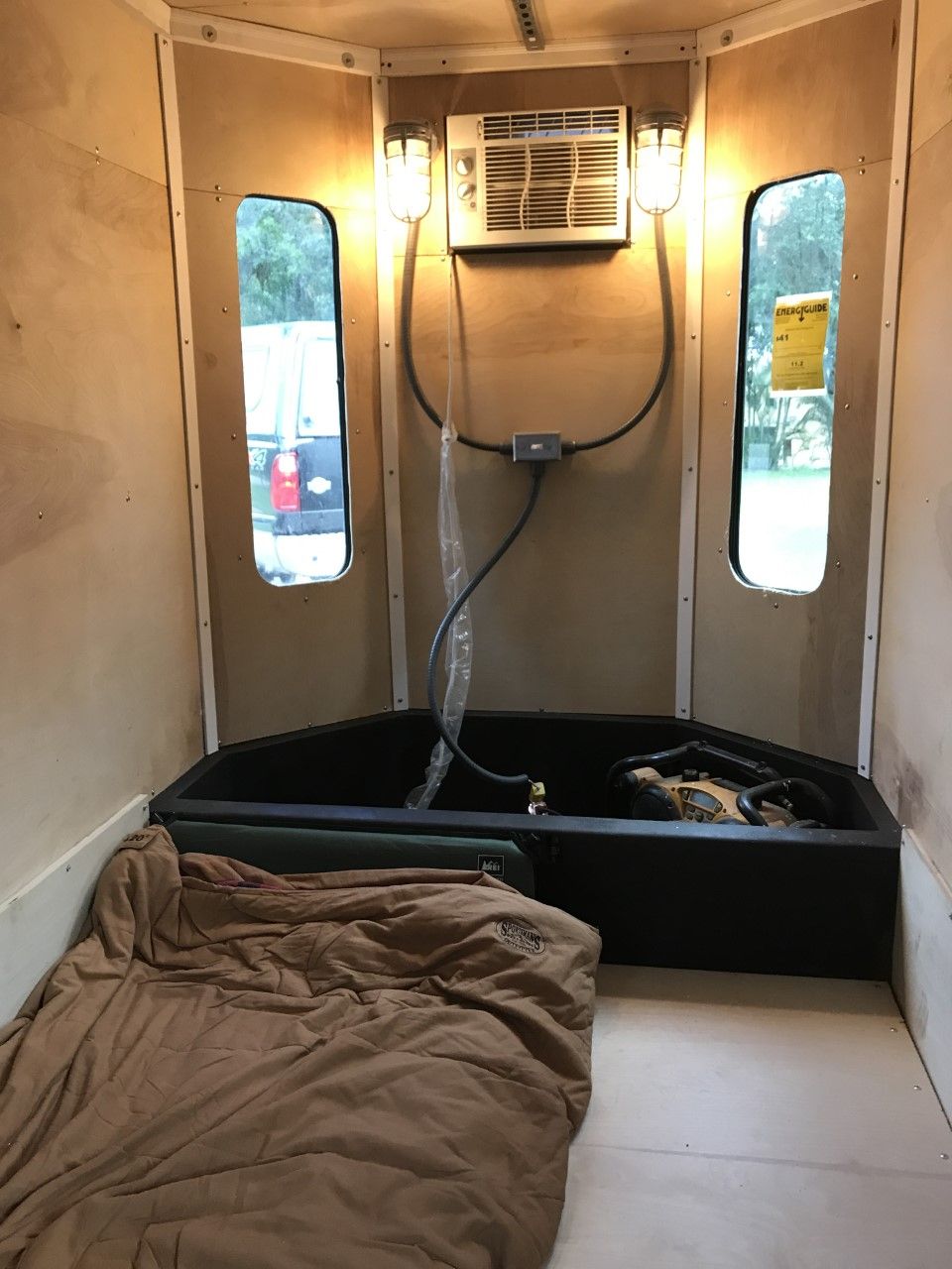

Given the size you have it occurred to me that e-track on the walls might be useful. You could span from wall to wall with some beams to make an elevated bed or tie things to the wall for transport. Just a thought.
Chris, I have considered e-track. I will look into eBay availabity. One of the objectives with this trailer was to maintain a minuscule financial footprint. I purchased (4x) MRAP tool boxes that I will incorporate into my build both inside and over fender. It took me about (5) weeks to negotiate pricing to agreeable pricing for this build. I'm trying to pay homage to its military roots, the rear stairs, while oversized, are military surplus. My concern with e-track is this, I built the trailer with only one 1" of head clearance with the floor insulation, birch plywood and rubber, if I had an elevated bed I wouldn't be able to sore it at ceiling height because I would lose standing clearance. I also considered folding platforms but it's a very small trailer and almost moot to attempt. The trailer had an awesome toolbox at the rear and I put a reasonless deep well in the tongue so if I can neatly satisfy a little bit more storage I think I'll have this about done. I appreciate your idea and encourage you to offer additional information if you have something I'm missing? L
Thanks guys. I appreciate the kind words, this build was about doing something that met my needs while maintaining a minuscule financial footprint. I had been camping in my 80 but as small as this is it's much more comfortable.
