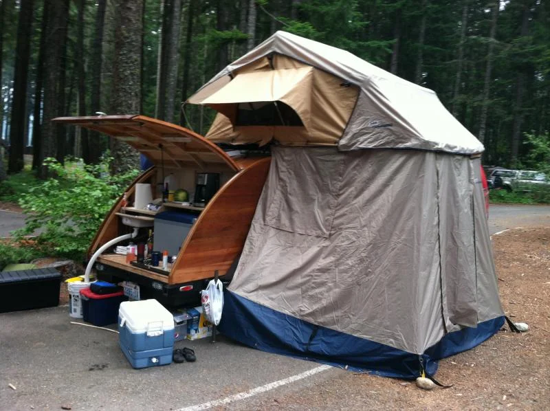

Here are a couple pics of mine, not done but definately campable. It's a 5'x10', 33x10.5, ARB RTT and fridge.

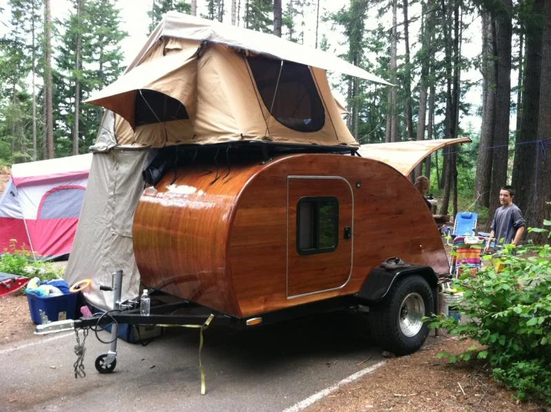

Now That is a pretty trailer! What wood is it made of?

Great looking teardrop meat. Nice way to go with the tent on top if you have kids. The extra room is cool too. Do you have pictures of the inside and how it works with the teardrop access?

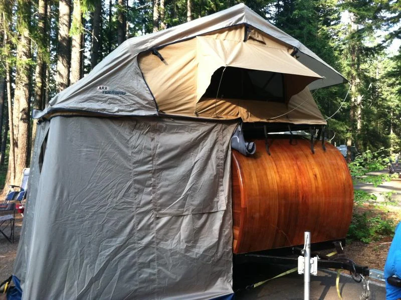

holy cow, incredible work! What woods did you use for that? And how did you build the corner enge on that? It looks like one piece of wood rolled over the entire edge?
The wood used was western red cedar, always liked the cedar strip canoes, then fiberglassed. On the edge I used a 2x3 piece in different lengths depending on the radius, scribed it to the wall and to the roof, then used a big round over bit.
