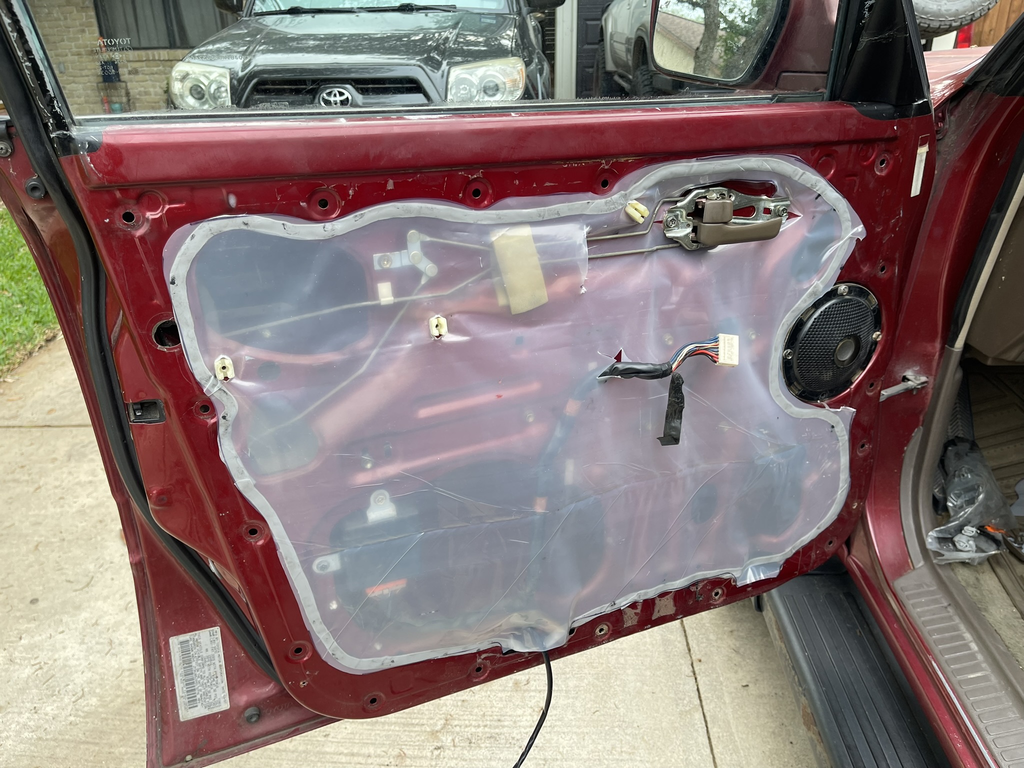

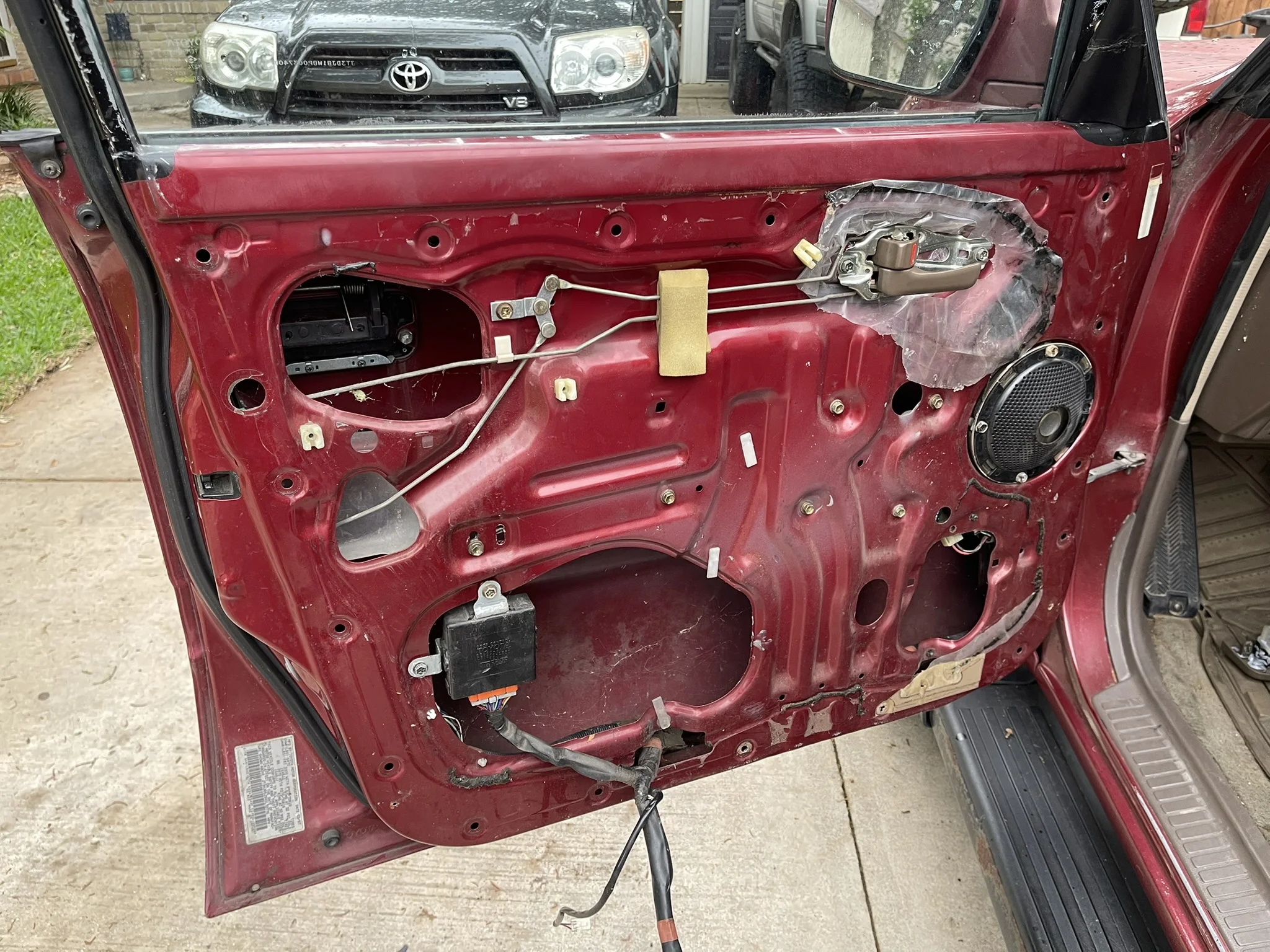

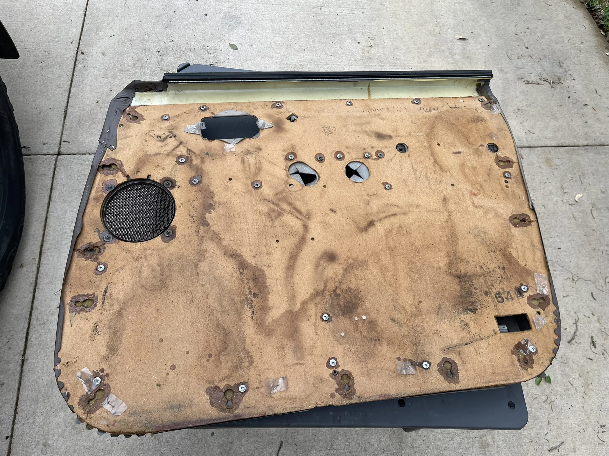

Spring on the front door handle was broken and made it wiggly. Pulled off the card replace it and discovered no vapor barrier. Fantastic, especially for moisture-loving masonite. Most of the clips stayed in the door too.
Fix/Tags: Door panel/card clip reinforcement.
One thing I highly recommend doing to every toyota of this era is applying high-flow super glue anywhere something attaches. It's absorbed like water and makes the material rock-hard, holding the clip without deforming/tearing during future removals. Also properly secures the door card back so it'll mount nice and tight.
Also made a new vapor barrier, but that's pretty well covered.

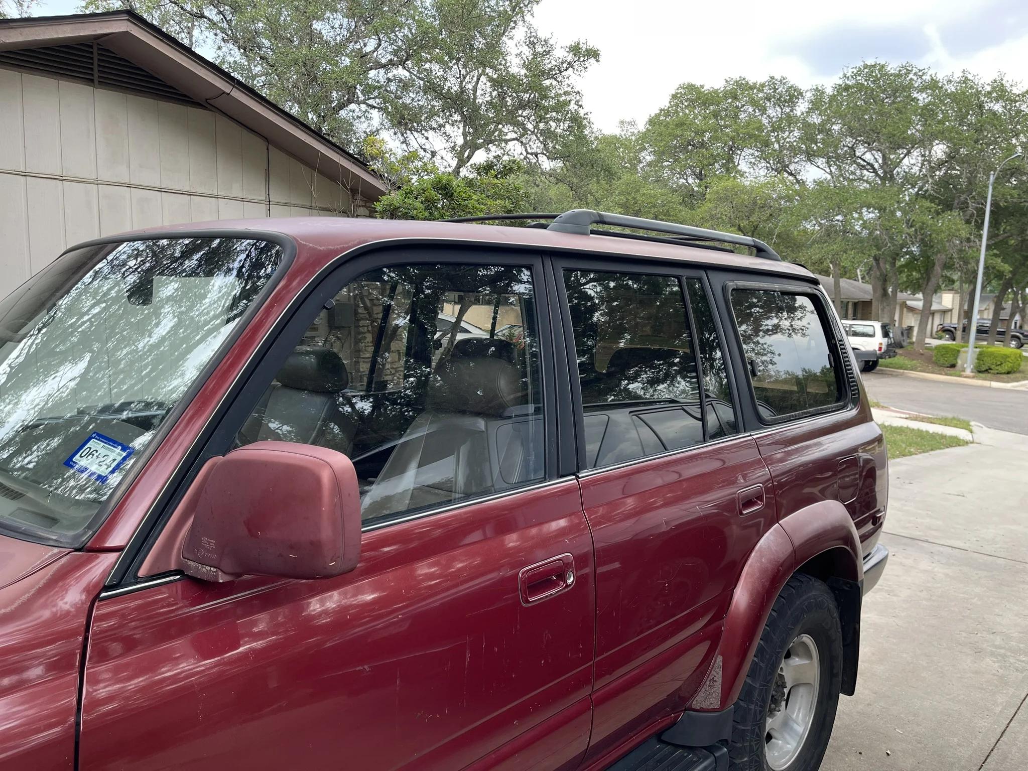

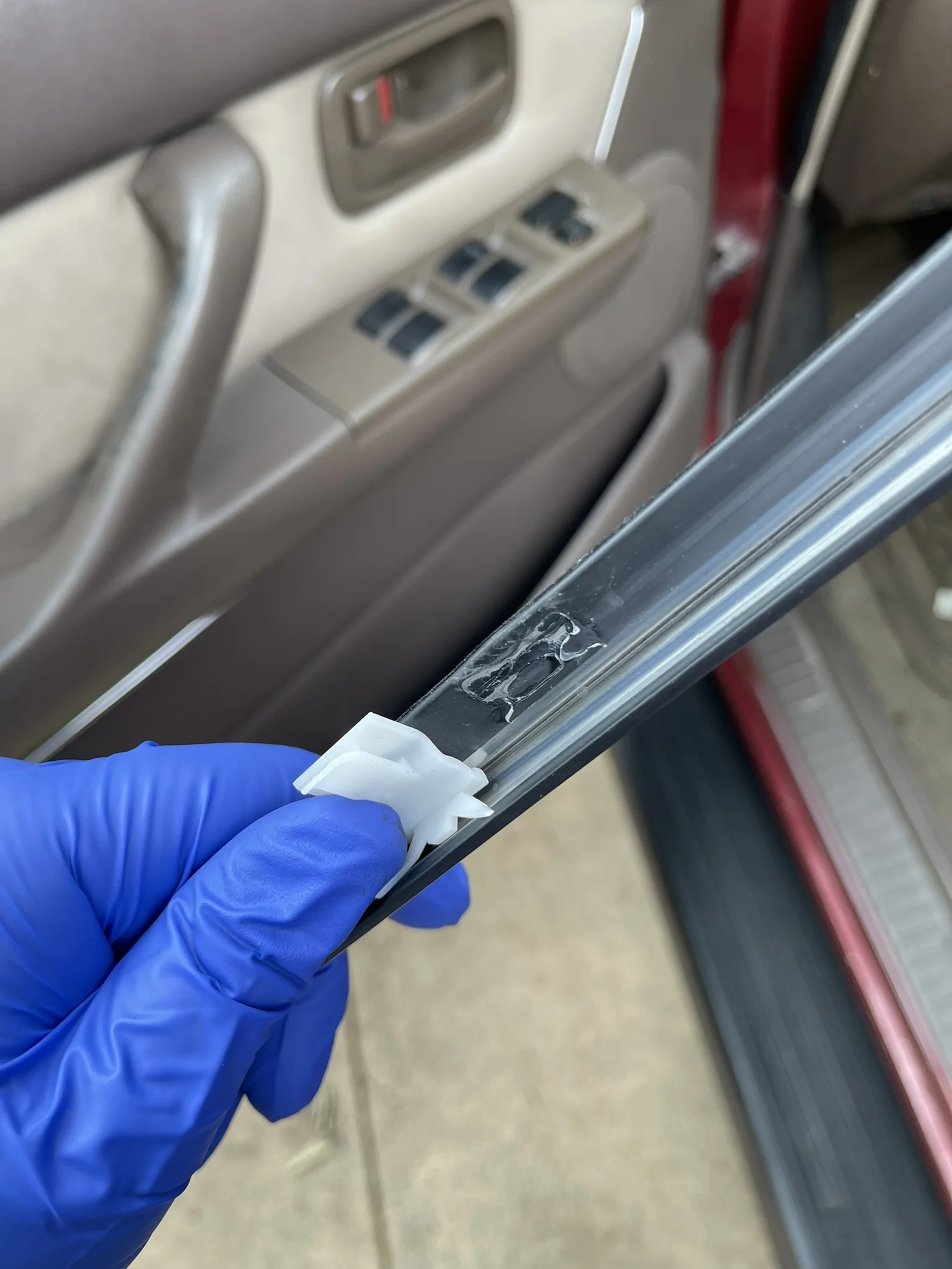

Fix/Tags: Aftermarket/chinese window molding/trim.
Before you comment "OEM isn't much more!!!" realize that I've bought the OEM for my LX "cheap". It was still $211 shipped directly from Japan (also took 3 weeks). Also the whole point of this one is budget.
These chrome window sets are all over eBay and Amazon for ~$40 for the front 4 or ~$60 for the full set. They're chrome instead of black. I bought the 6 for $70 off amazon with prime shipping. Got here in 2 days.
As it comes it won't fit- the clips don't line up. For whatever reason they glued them to the rubber backing. All you have to do is break that bond and it'll slide around like OEM. Fitment is pretty good once that's done. It snaps into place. Long term results are TBD- I'm sure I'll find out quick with the Texas sun. Much better than the broken/sharp vinyl before.

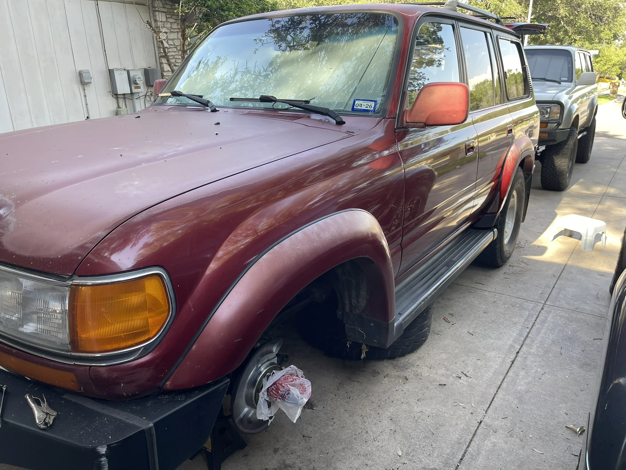

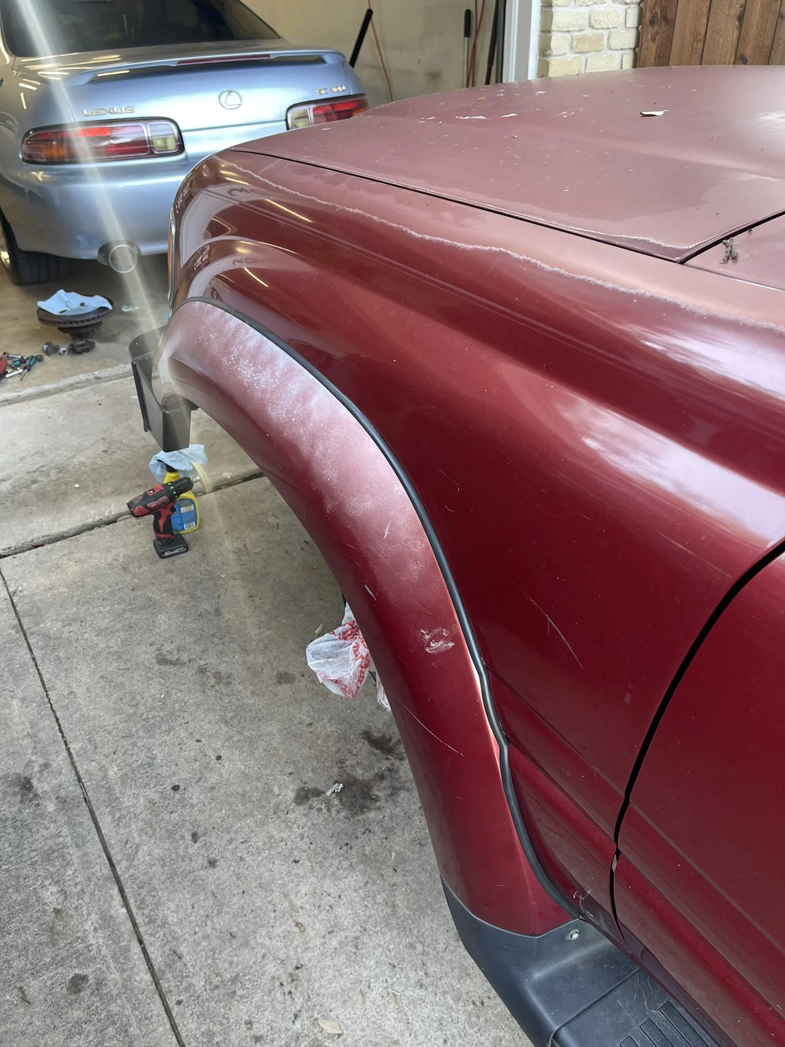

Fix/Tags: Fender flare gasket/trim
Can tell from the previous pics that the rubber fender flare gasket is gone. I didn't even bother looking up what the OEM costs here. Bought 33ft of this rubber seal for $27 on amazon to replace them all. I also preemptively bought the OEM clips expecting them to break. Surprisingly the only clips that broke were the rear doors 2. None of my clip mounts on the flares broke either. Took a little less than 3 hours to complete, pretty happy with the results.
Clip part numbers:
Rear fender flare clip x290249-06160
Fender flare clip x1090249-06132
Fender flare clip holder x890467-09077

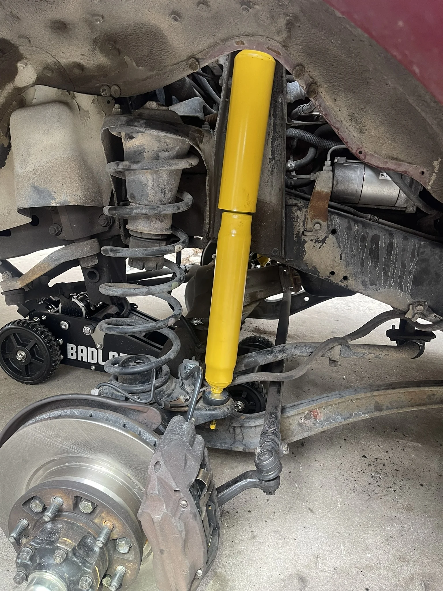

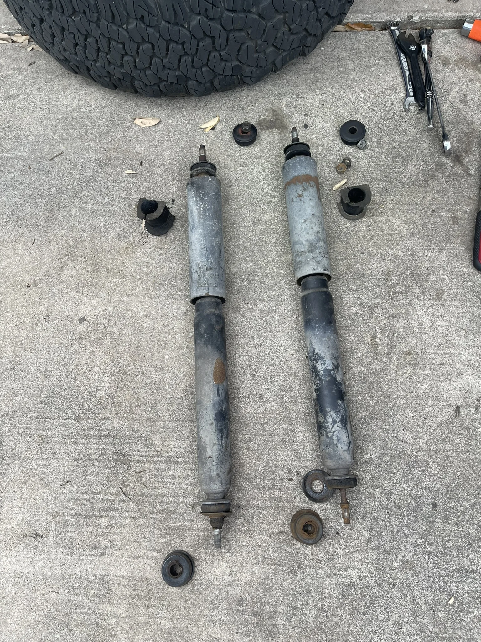

Rockauto had some decent wholesaler closeouts. Got front and rear monroe shocks/sway bar bushings and a heater valve for $130 shipped. They're not bad. Some might even confuse them for OME nitrochargers and think I'm a big baller ;). Fixed a suspension sqeak too. I'm not sure if I took out the original shocks, they're toyota/tokico branded. Still had rebound, insane for 384k miles if original.

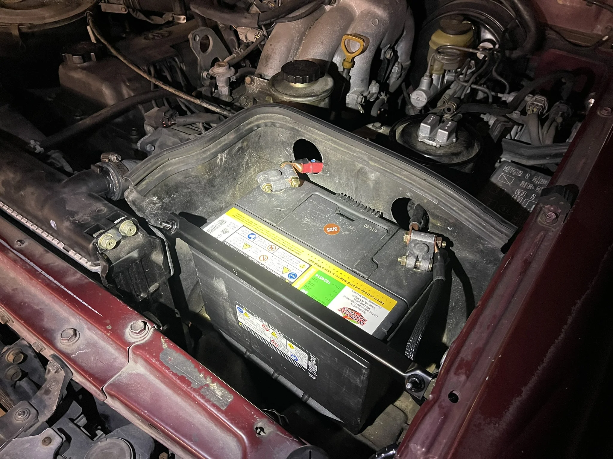

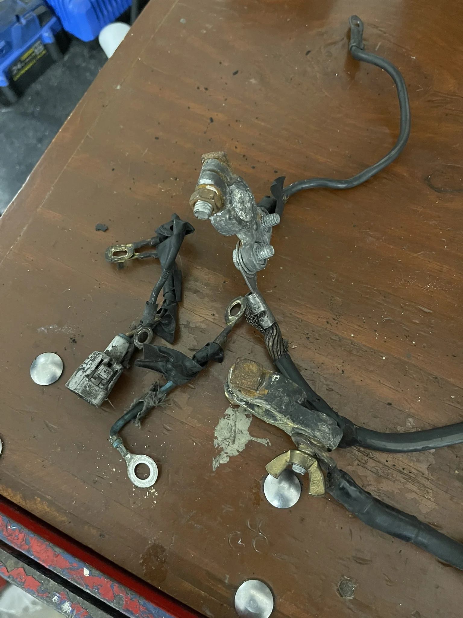

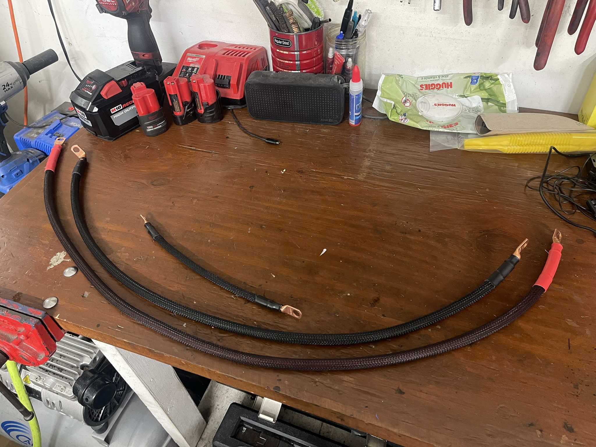

Also gigantic benefit of having 2 of the same truck is the amount of spare parts laying around. Terminals on this one aren't original and kind of hacked up. Had enough leftover wire from my LXs cable job to do another set for this one.
The wear on that shock mount post is insane. Must've been flopping around. I could see that letting loose at an inopportune time.
Can you share the parts you used, specifically the terminals? I have a heavy duty crimper from horror freight and make cables, but never seem to have the right diameter hole copper terminals for the posts.
https://www.amazon.com/dp/B073Y9RYFM?tag=ihco-20 for the pos/neg terminal to starter/terminal to block.
https://www.amazon.com/dp/B073Y96KXG?tag=ihco-20 for the terminal part of the smaller fender ground.
https://www.amazon.com/dp/B0747NZT6K?tag=ihco-20 for the fender part of the smaller fender ground. Also used these for the block to firewall ground, and transfer case to trans tunnel ground too.
Great thread, any need for a new stabilizer shock? 111k miles on mine, intermittent with a slight out-of-balance feel at about 70 and it's not the wheels/tires. I suspect it's the original stabilizer because the rest of the shocks are original and rebound is not very tight at any of the 4 corners so I think the stabilizer is only there for show, too.
It's blown on this one. The monroe damper (SC2946) is only $35 on amazon, easy to replace too. I'm pretty sure most of this ones steering slack/issues are from the steering box though.

Fix/tags: Chinese/aftermarket battery hold down.
Found this on amazon with prime shipping for $25. OEM is barely more expensive depending where sourced. I'm a sucker for fast shipping. It's solid, no complaints.

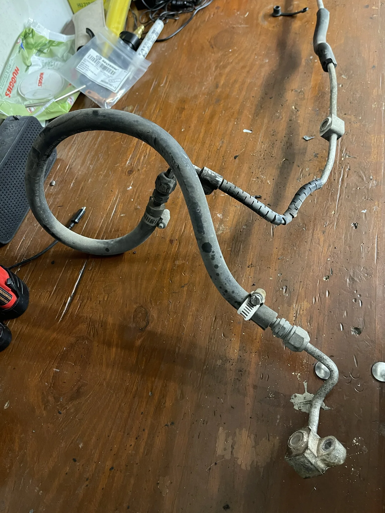

Swapped on those cables with a new fusible link. Also pulled out this hacked up AC hard line. At least it's supposed to be hard, I've never seen a repair like this before.

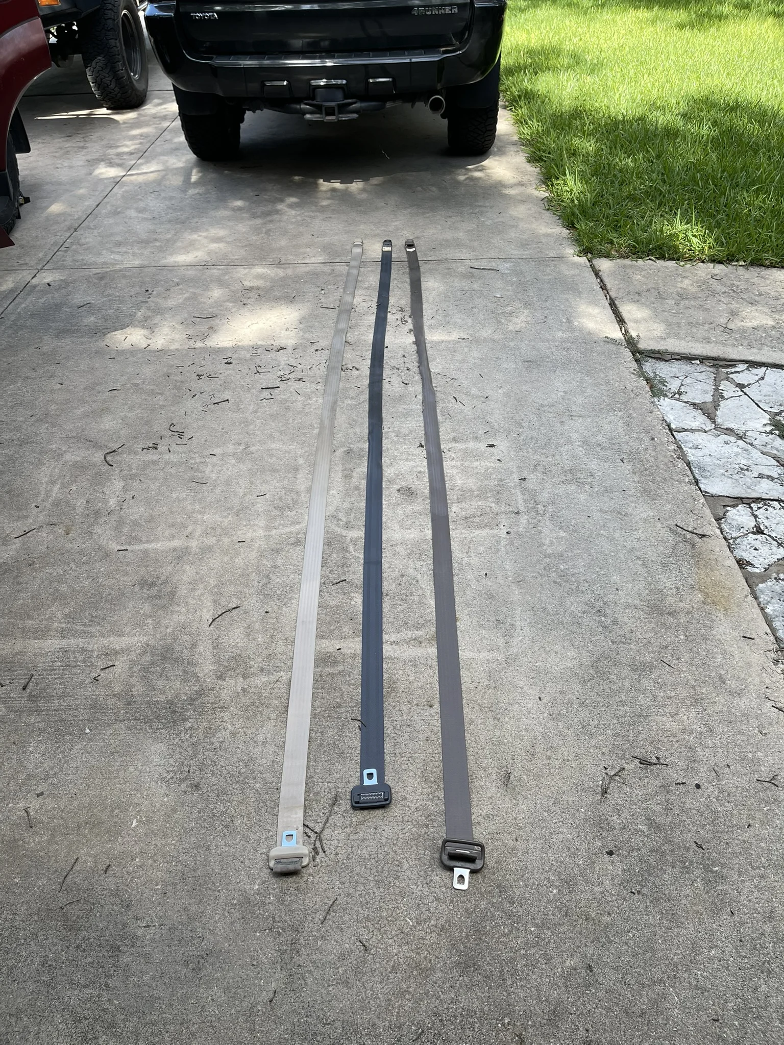

Fix/tags: Seat belt webbing replacement.
Used this thread as reference: Seat Belt Replacement - https://forum.ih8mud.com/threads/seat-belt-replacement.725487/
My yard had a 95 and 2 96 camrys. Unfortunately the only brown interior one was spray painted black. The Camry is an exact match down to the buckle. In search of a better shade I found a 1st gen avalon. Buckle is slightly different (80 series buckle is completely flat, this one is slightly angled like the 2nd rows buckles).
I used safety restore on my LXs seatbelt. That was like $150 total and 3 weeks of downtime. They did a good job, but the downtime was rough. This was $13 and about an hour to replace (not including pick n pull time). Super easy to do. Highly recommended.
Avalon seatbelt on left, camry center, and land cruiser right. Camry belt is just slightly shorter.
