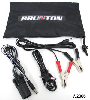

Curious if any mudders have have used one of these before.
image.axd
I am hoping to be able to run our Engel MT45 with it for 3-4 days while camping in Anza Borrego or camping down in Baja.
My plan was to bring an Optima and keep it topped off with the Brunton but apparentley the panel could also run the Engel directly as long as there was good sun exposure.

Thanks,
What is cool about this product is that it comes with connectors to connect to the battery, and also a connector that will connect directly to a 12-volt device.
Plan is to use it to keep the battery charged and then run the Engel off of that.

a single panel should be capable of producing 1.5-2 amps @ 13-17v in full sun... By linking 2 together I was very suprised at what I could actually "run" or charge with a couple of these panels. In fact, I bet 2 linked panels would be able to run an Engel and lightly charge a battery at the same time. One however, is more than enough to run many of the most common electronics ( GPS , cell phone, nicad chargers etc..)
Although a bit pricey.. IMO its hard to find anything even close to the Solaris 26 when it comes to size, weight, construction and performance.
I wish I had a few more !!
