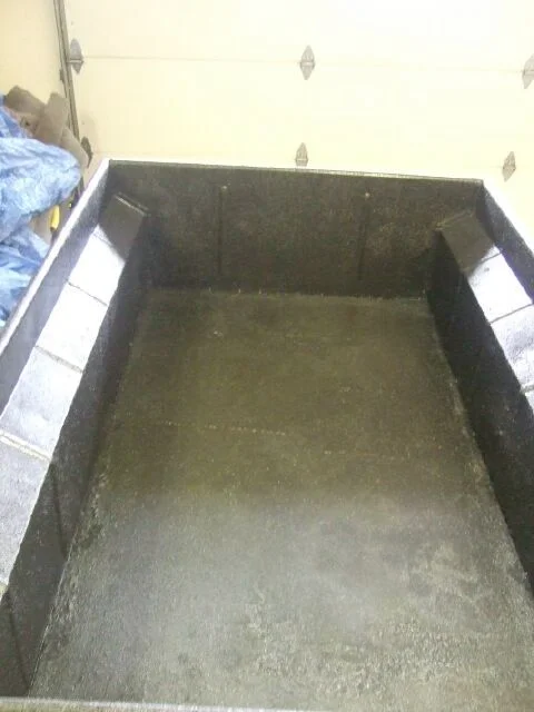

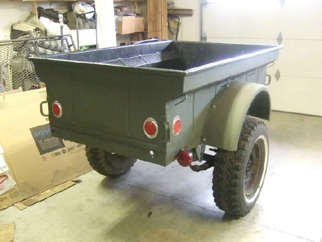

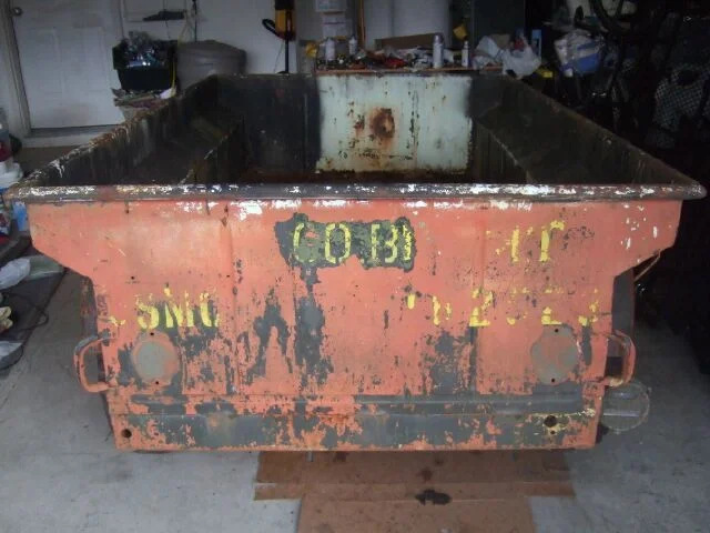

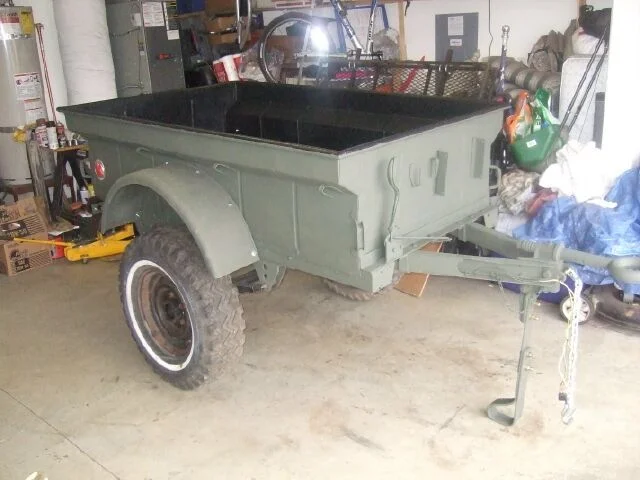

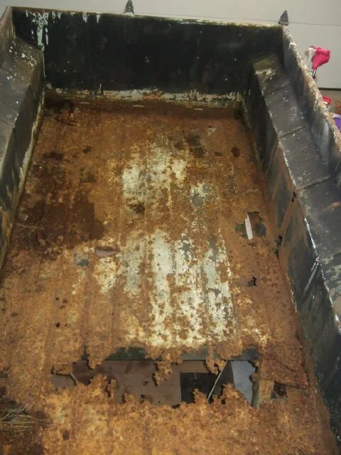

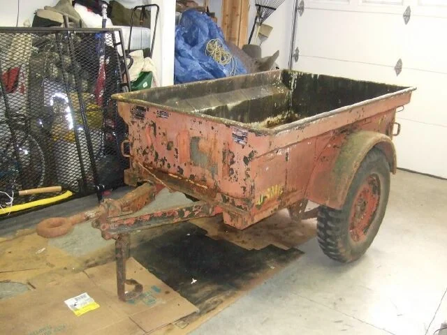

Looks good. It is way nicer than the one I picked up a few weeks ago down in Salem. I just finished completely going through mine. I repacked the wheel bearings, took apart the springs and painted them, cut the floor out and welded in a new piece and patched some rust holes in the sides. I also went SOA with it. You can see the pictures on the cascade cruisers website - My new project. I'll be updating tomorrow with some pictures of the finished product.

Sorry, I guess you have to be a member to the CC website to be able to see the pictures. Here's some before and after pics. I just finished up the bedliner a couple of days ago.
:cheers:
These are before:

After pics:
