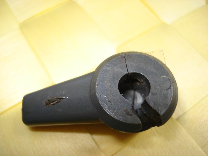

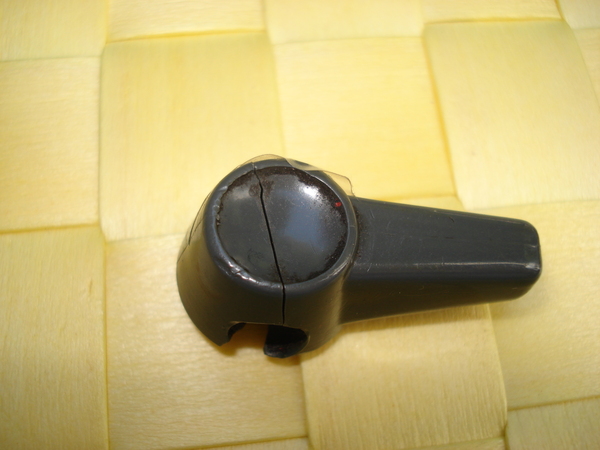

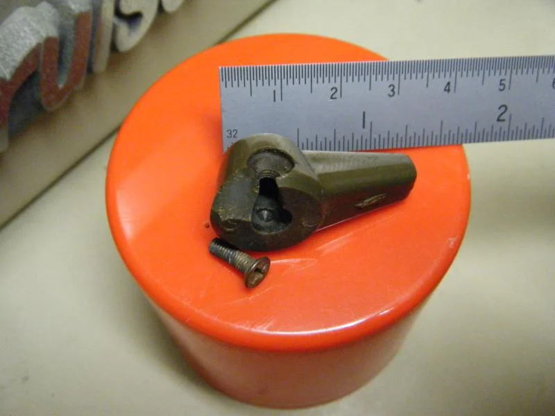

... my left inner secure knob is broken yesterday :crybaby:
Does anyone repaired such a knob and fixed it again.
Any help would be appreciated .
url=http://www.abload.de/image.php?img=dsc00807t89p.jpg]
[/url]
second pic:
http://www.abload.de/image.php?img=dsc00808qwy4.jpg
Bild: dsc00808qwy4.jpg - abload.de
third pic :
Bild: dsc00809p889.jpg - abload.de
fourth pic :
http://www.abload.de/img/dsc00810e80z.jpg
At the moment I don`t understand how the Toyota guys fixed such an unbroken knob on the "metal part" of the door, any ideas.... ?

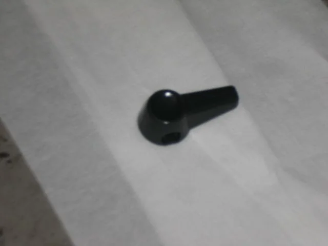

i should have some custom brass and/or aluminum ones in a week or so.
the CNC operator at work is a hell of a nice guy:grinpimp:
how many do you want? just pm your postal addy and i'll send some to you when they are done.
i don't even have latches that will fit those knobs, just wanted to see if we could make a reasonable copy. sort of a "dry run" for parts i really need.

just measured my broken knob :D .....
.... it´s the same size 3,1 or 3,2 cm :clap:
viewed the door/inner lock and now I know, how they are fixed ...found the little original screw.

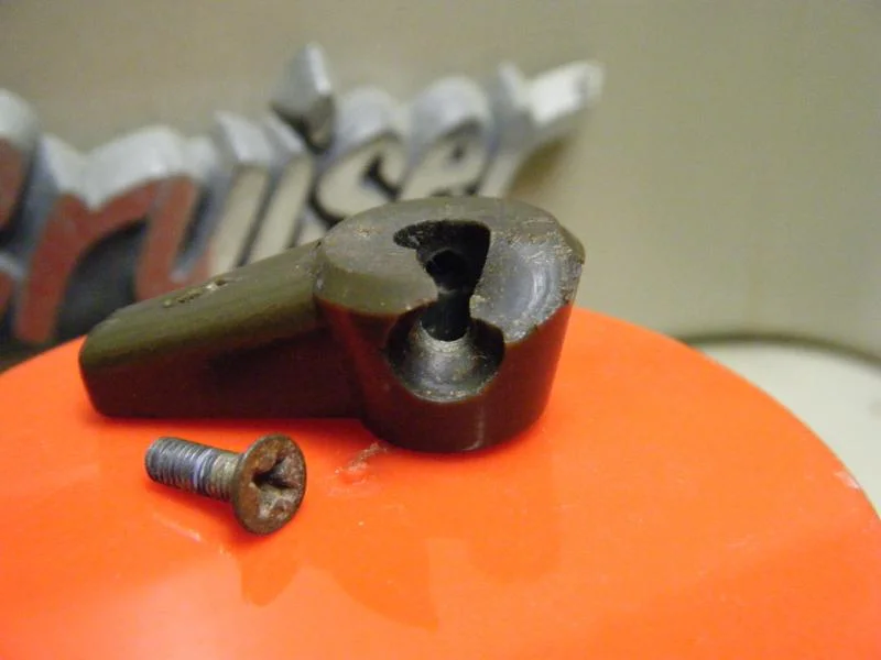

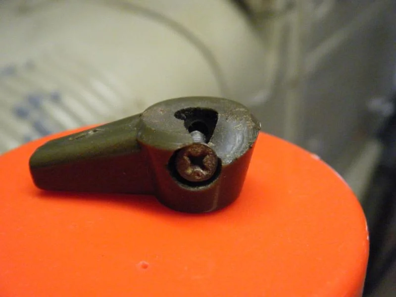

Crusty,
made 2 pics of the lock*
first is the broken (left) ... with the little screw,
second the perfect, so you can see this vintage lock, don`t know if you have seen it before.
Cheers
Peter
* just seen the left is a bit dirty (grease) ;) have to clean it ..... in a year or two or .....:D
yes, that's the one. the lock "knob" is the same as the rear ambulance door lock knob.
it's too bad you can't find just the part you need. most of the ones i have ever seen are broken or cracked or just missing.
i have never seen just the "knob" as a replacement part, i wonder if toyota has them? (just answered my own question)
part number 69320-60031 looks to be the whole assembly, no breakdown of any other parts :frown:
oh well, just have to wait for the machinist to be done:grinpimp:
cheers
crusty

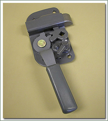

specter has just the knobs in stock...6.69
Thanks for input, searched a bit at SOR and found it....
Specter Off-Road Land Cruiser Parts - Page 136 Land Cruiser Rear Doors 1975-1984 40 Series
Specter Off-Road Land Cruiser Parts - Search On 136-49
... think it`s a Toyota part and they get it from Toyota, means Toyota must still have them. Will do a a new research at my Toyota dealer ( search for the Land Cruiser Rear Doors 1975-1984 40 Series) ;)
