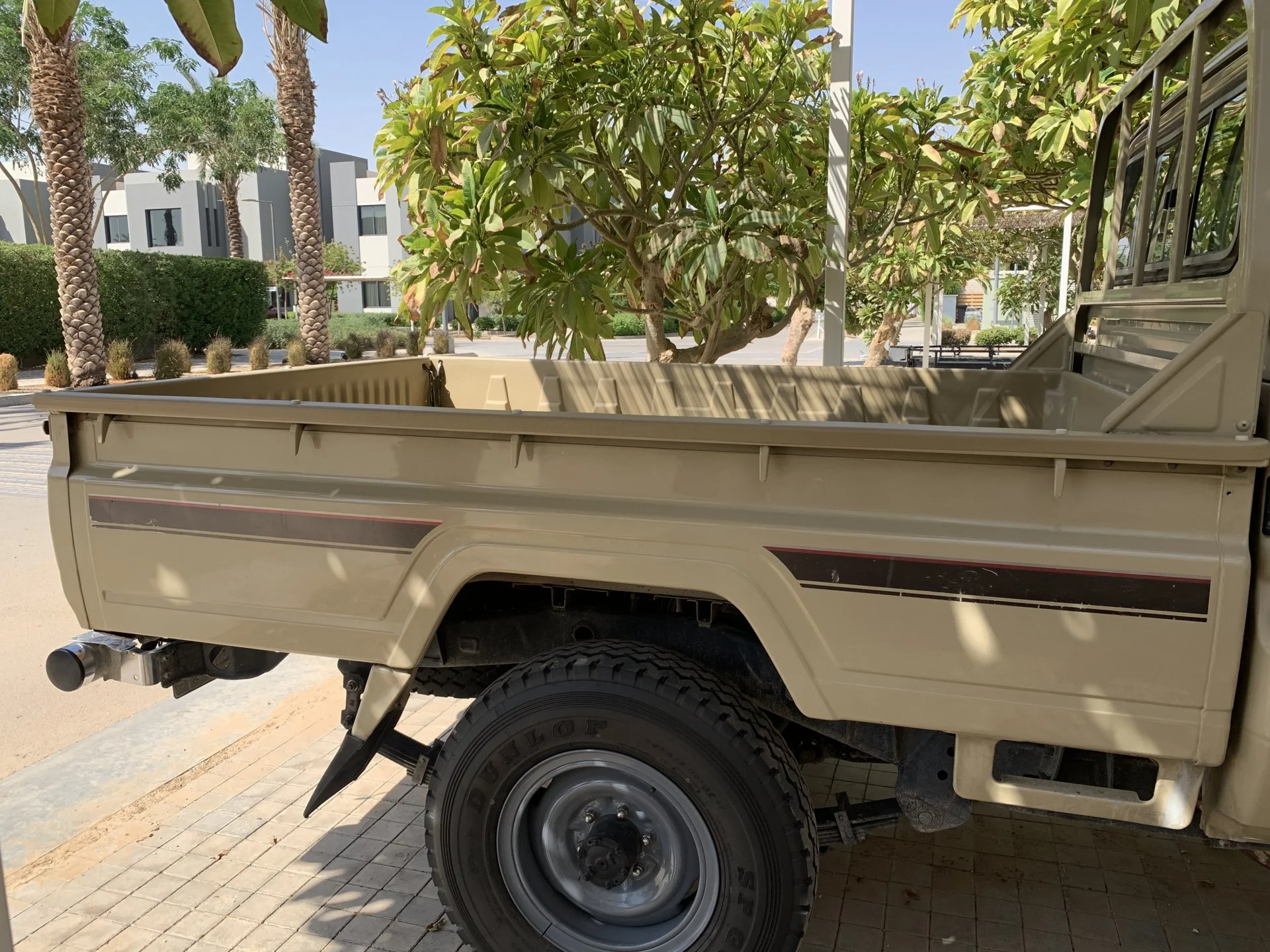

Sorry if I'm missing something, but couldn't be a better choice for a vehicle like the FJ40, remaining at 7.50R16, to look for a tyre like the Dunlop SP Qualifier TG21? It's the standard fit for the 70-Series, so easy to get in the Gulf countries. Seen this tyre here in the Mud, particularly with Mudders with (extensive) GCC experience...

Yes I believe they are heavy truck tyres - they certainly look pretty heavy duty in the shop. They are 14 ply i think - maybe a little too heavy duty?! I've looked at the SP Qualifiers, but unfortunately no one stocks them here in 7.50R16 tube type - only available in UAE, which means expensive road transport to get them.

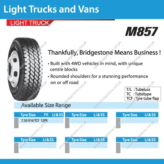

I'm still intrigued to see if anyone put something as heavy duty as the M857 Bridgestone on a 40?!
These Dunlops should be heavy duty enough, IMHO.
However and back to your question, it seems that these people put something as heavy as the Bridgestone M857 (e.g. the Indian made 14PR radial JKTyres, or the Apollo Dura mile, 14PR radials), have a look...
...and if you decide for the Bridgestone M857, you could, perhaps, find them in their 114N/8PR version (see at the PDF archive), probably more suited to the FJ40.
There is a tube type (TC) for the split rims too.
Yes I had hoped to get the lower ply rating versions, but unfortunately they only have he 14PR in stock. There really is a limited supply of decent tyres in the size here, and i cant justify spending ~1000usd plus postage on the City Racer tubeless replacements. Unless something else comes up, I think ill take a punt on the M857 and see how it gets on - at least i wont have to change tyres for some time!

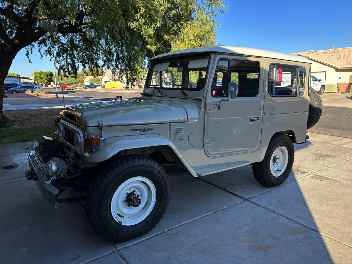

I think I have a 12pr tire called the Kenda Loadstar with highway pattern tread (kinda looks close to what you're doing for) . Not aggressive tread at all and I'm able to do all the "off road" trails with ease. Tubeless tire though. The 12 ply feels pretty indestructable and I'm able to run over sharp rocks, spikey desert foliage, sand, glass, etc. Thry are tough. If I could get a higher ply rating, I would. I really recommend the highway patern. Unless you're planing on doing driving on snow, highway tread is the way to go on rocks and dry climates. Heck, even in rain, the tire patter is great.
Suposedly some people run tubeless tires on split rims, just read up on it to see how or what issues they have.
Yes, these seem similar to what i have in mind - how do you find the weight of them? I wondered how all that unsprung mass will effect steering etc.
I've read various things about tubeless tyres with tubes, but it seems the consensus is that its not worth it. I'm planning a long road trip, circa 6000km, so need to keep punctures to a minimum and have read that tubeless tyres can end up rubbing on the tubes and causing punctures.
Do you have a picture of your tyre tread pattern - there are a few Kenda Loadstars available, I'm curious to see which one you have had success with?
