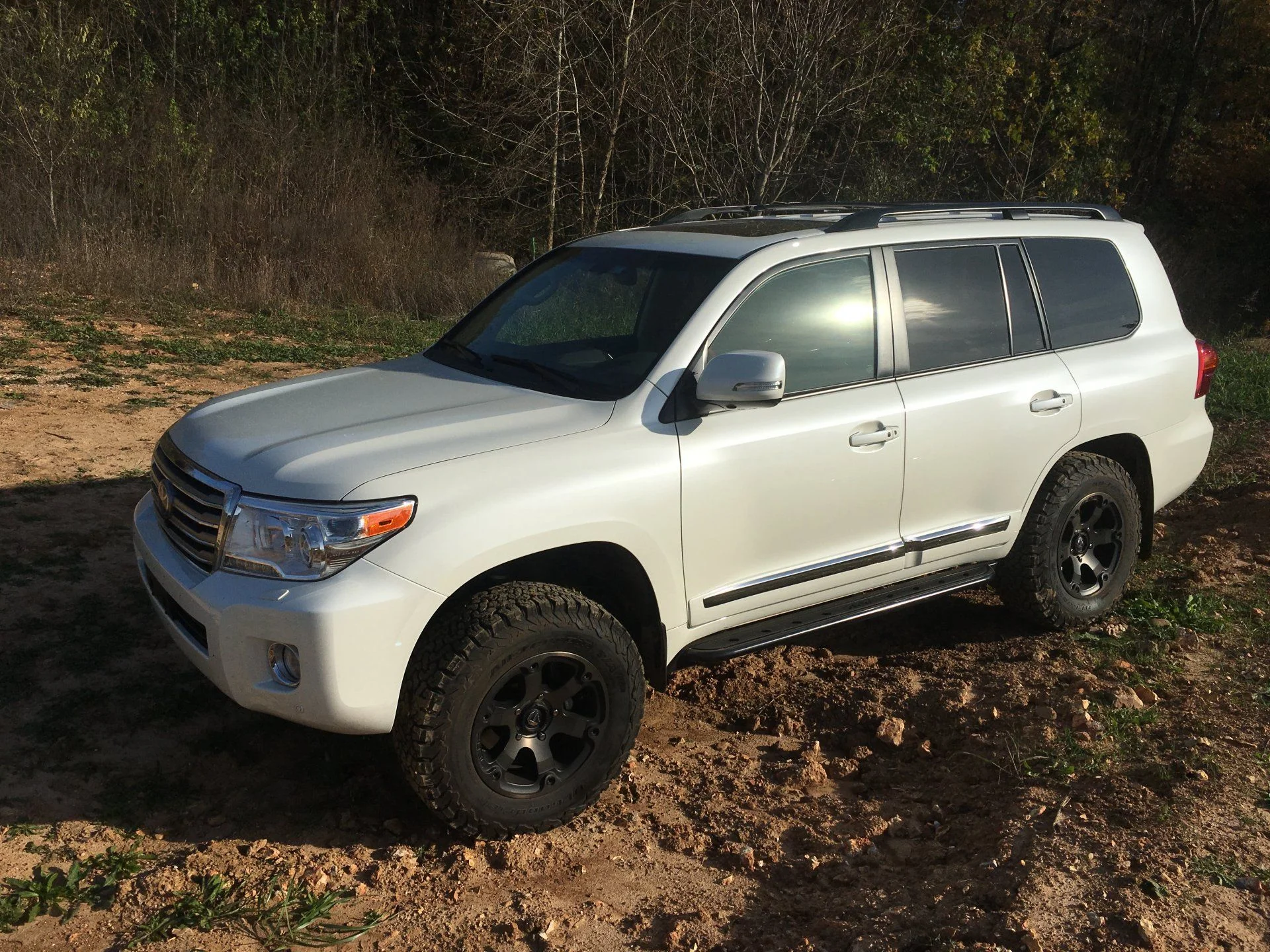

Looking for photos or ideas to blackout and storm trooper my new ride.....
I think it's hard to find a great set of rims that looks awesome
Want to blackout all the chrome and just make it mean
Photos tomorrow!
Storm Trooper your white LC???
Ha. We have the PERFECT thread for you...
Best looking "Storm Troopered" white LC of all time...click this link:
My build thread - Rapido XL.....

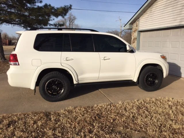

There is not a lot of Chrome that came on mine but I think it has somewhat of a storm trooper look to it.
Front windows are tinted with 20% that is matched in color to the factory tint on the rear glass.

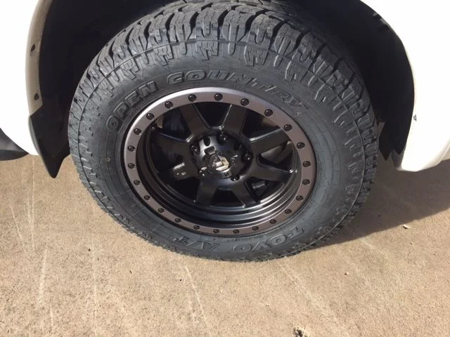

Wheels are Fuel mat black Trophy's. Tires are Toyo Open country P285/60/18 .
Fuel anza wheels see @kreiten photos
For the tires did you need a lift?
I am running the stock size 285/60/18s.
Howeveryes with that 9" wide wheel, and 20mm offset compared to the factory 60mm offset 8 inch wheel , I did get the toyoyota leveling spacers, which really didn't help much.
What did help a lot , was the alignment work we did , where I had a shop that took the extra time and effort to get the caster set just right, so that rubbing is at a very minimum on the firewall side of fender liners in full lock reverse maneuvers .
