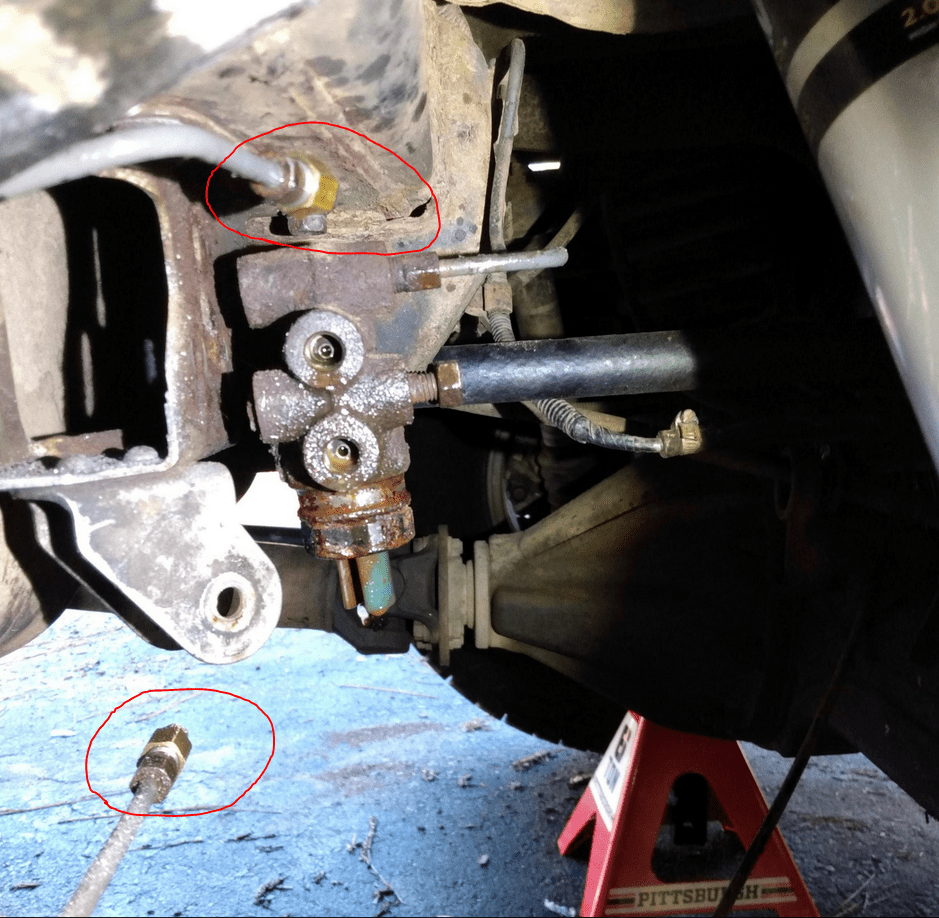

This AM I made two of these little plugs for solving just this problem. There's probably something just like at Autozone, but you better know what vehicle it fits or they can't find it...:censor:. I needed to stop the bleeding on the LSVP lines while I took my time getting the old one off.
I turned a mild steel plug that drops into a standard tubing flare fitting.
And plug welded it from the end.
To make sure it sealed, I took a short length of small diameter brass tubing to make a gasket.
And dropped it into a union, then snugged the new plug down over it to form the flare/gasket.
Here they can be seen in use on the input lines for the LSVP.

That’s cool but I just use these... Swpeet 100Pcs High Temp Silicone Rubber Protective Tapered Plug Assortment Kit, Masking System Kit Perfect for Powder Coating, Painting, Anodizing, Plating & Media Blasting Amazon product ASIN B07KJYPGT5
Yup easy way is rubber line or vacuum line, shove a bolt in one end then shove the open end over the line you just opened
For those I would typically borrow the little dust caps from bleeder valves. You can slide the threaded collar up a bit and the put the little cap on the flared end of the line.
So what ya'll are sayin', is I probably went a little overboard. LOL
